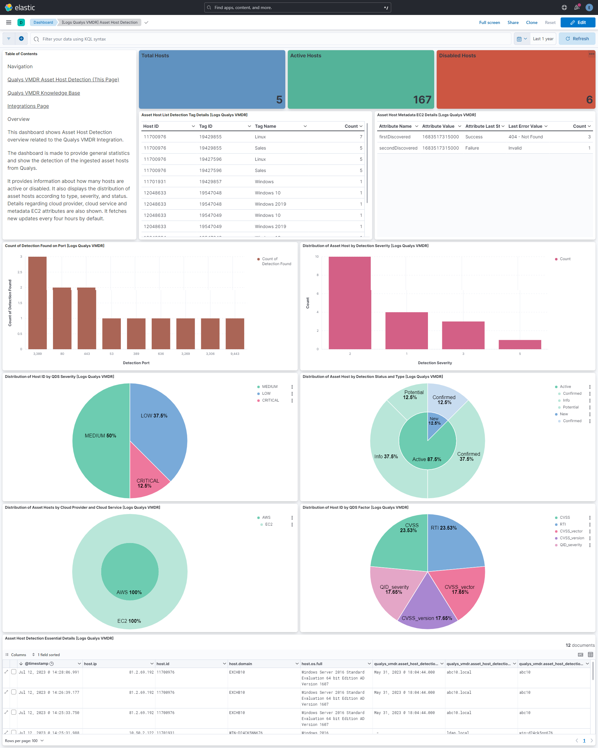

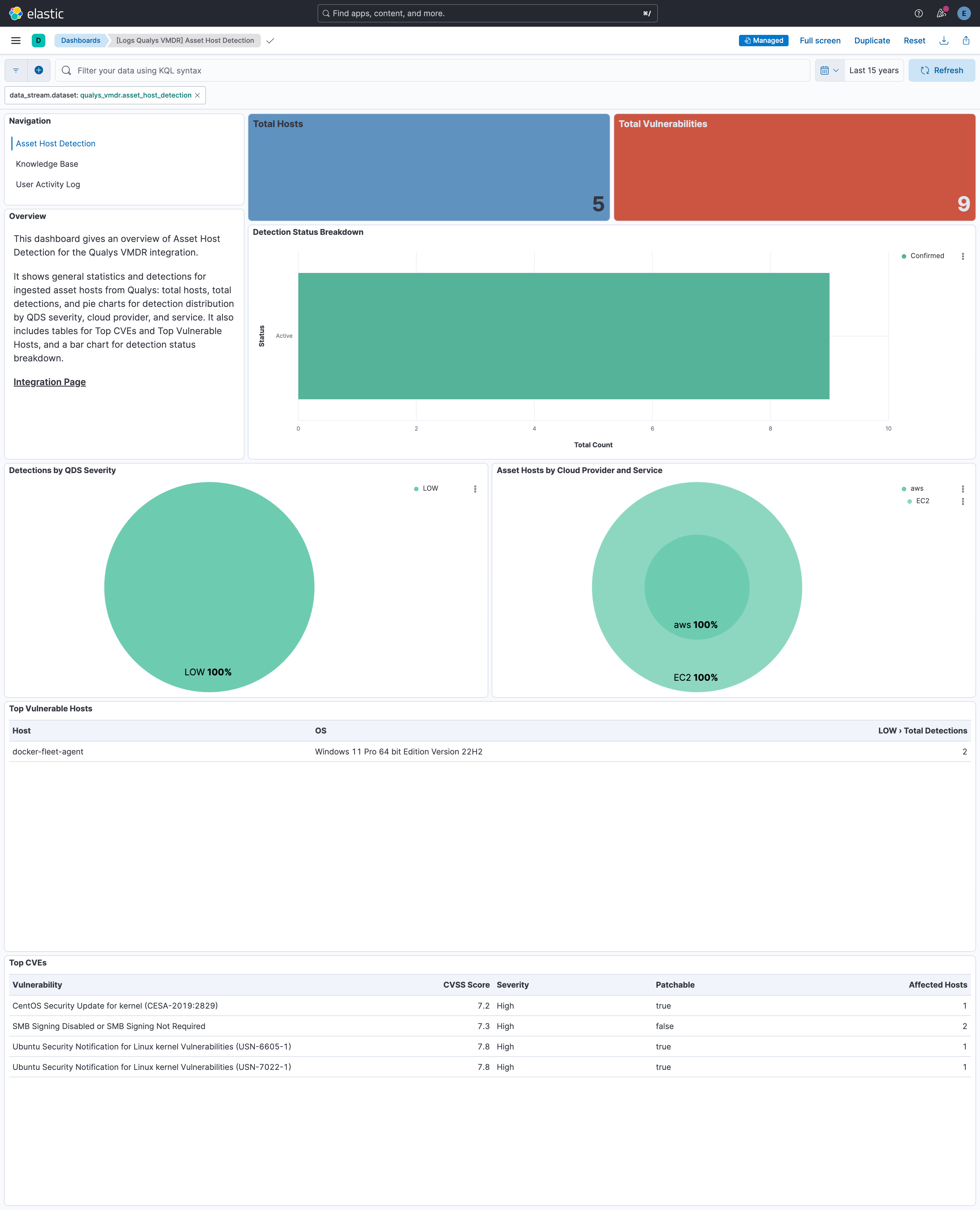

| Asset Host Detection |

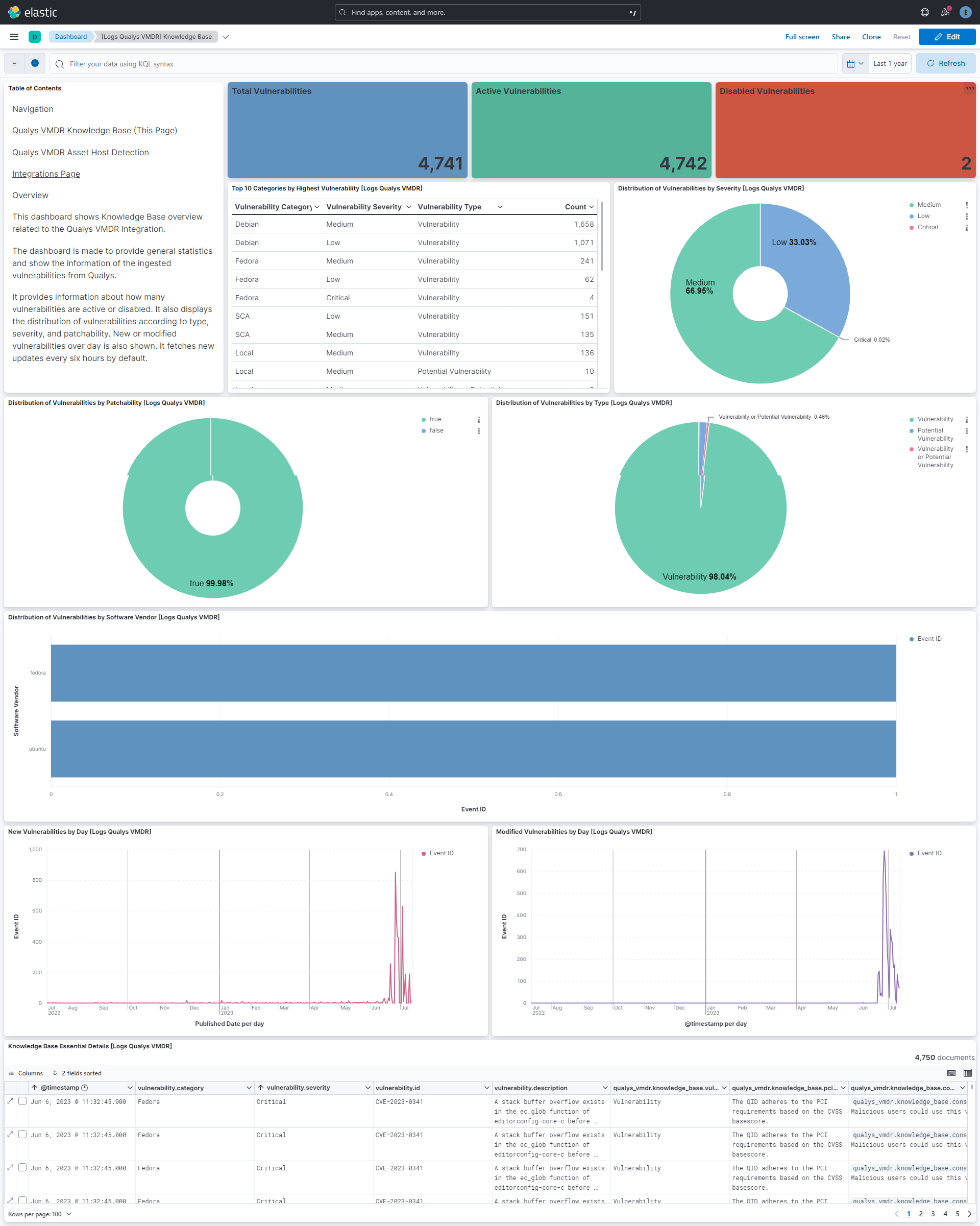

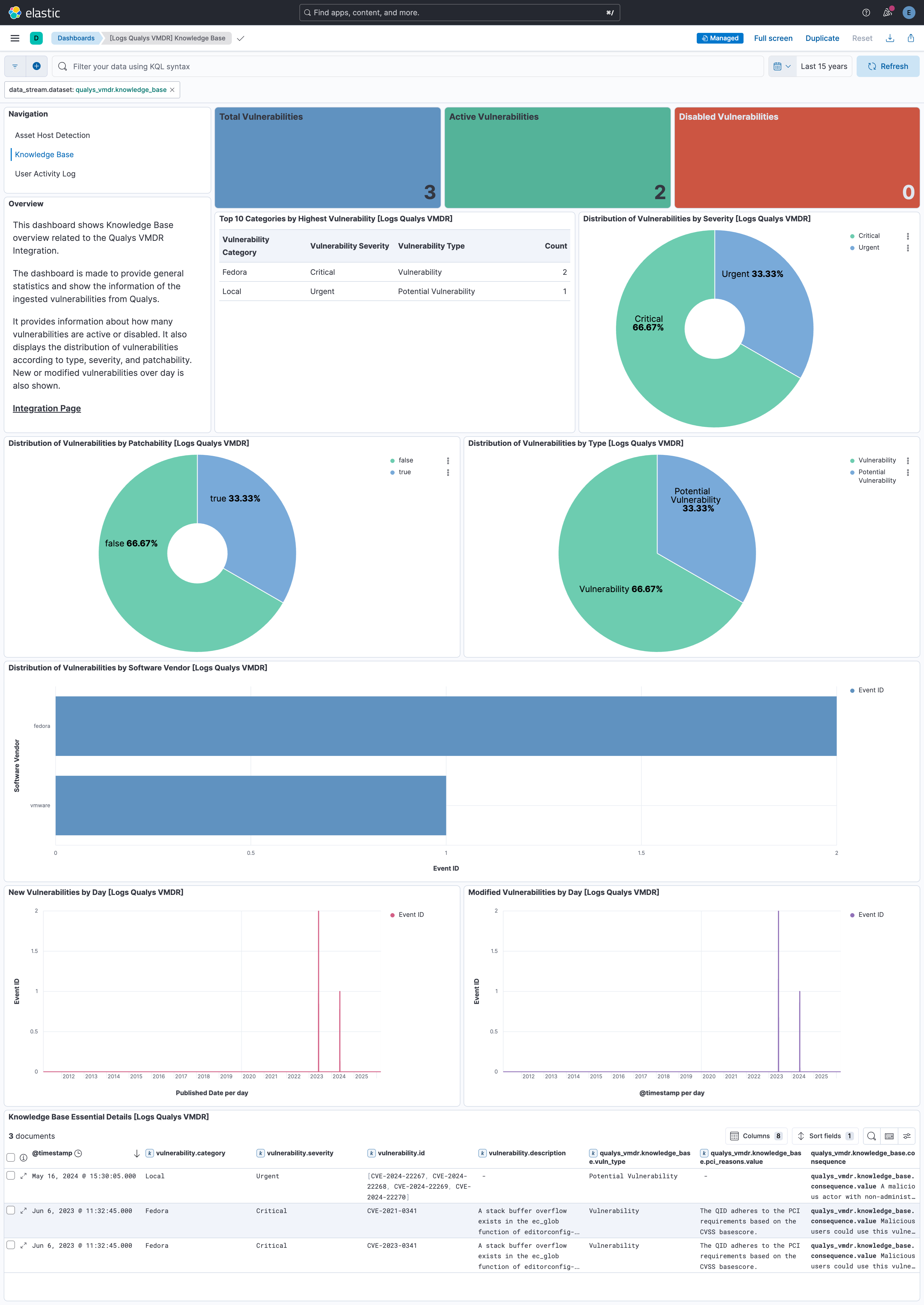

| Knowledge Base |

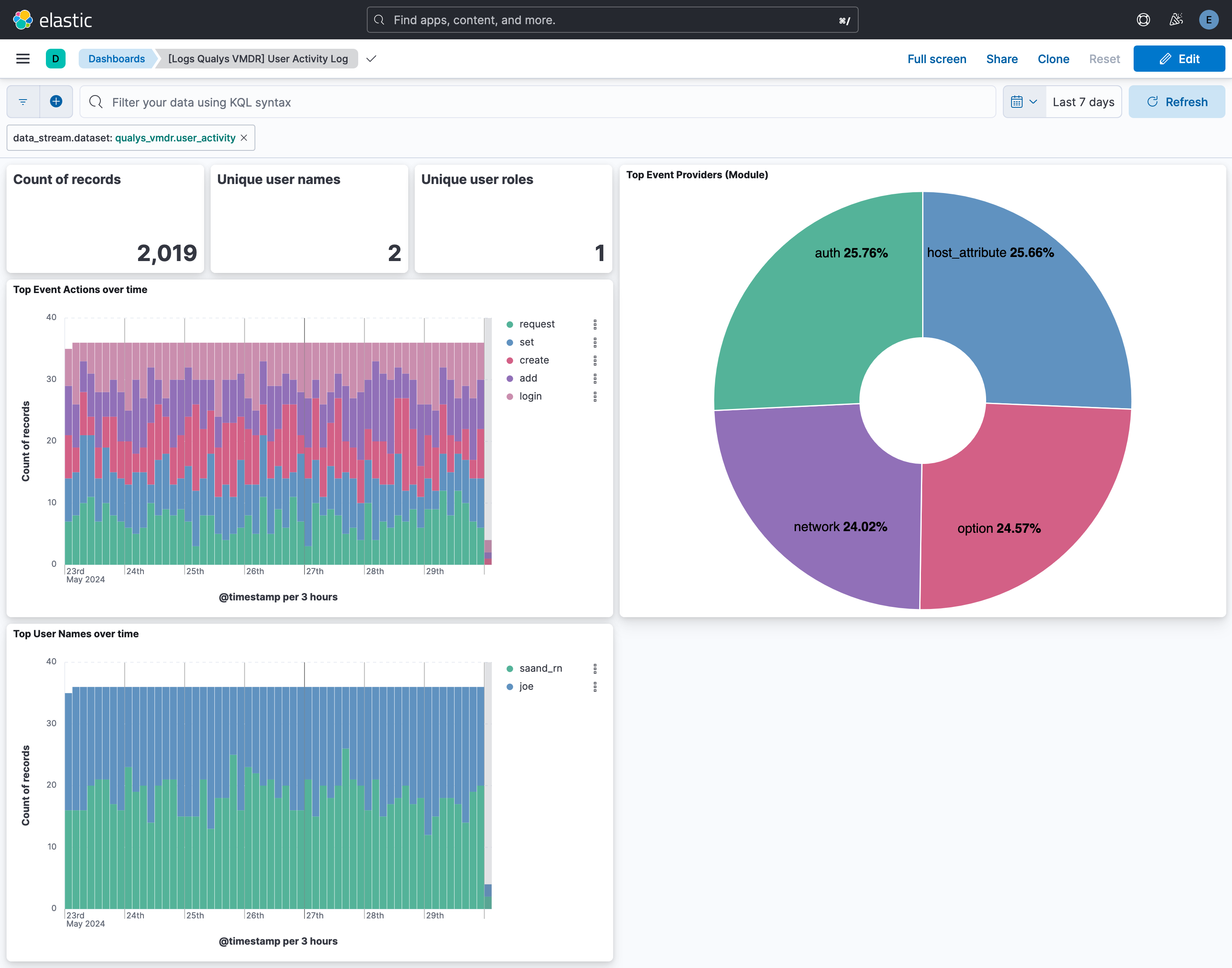

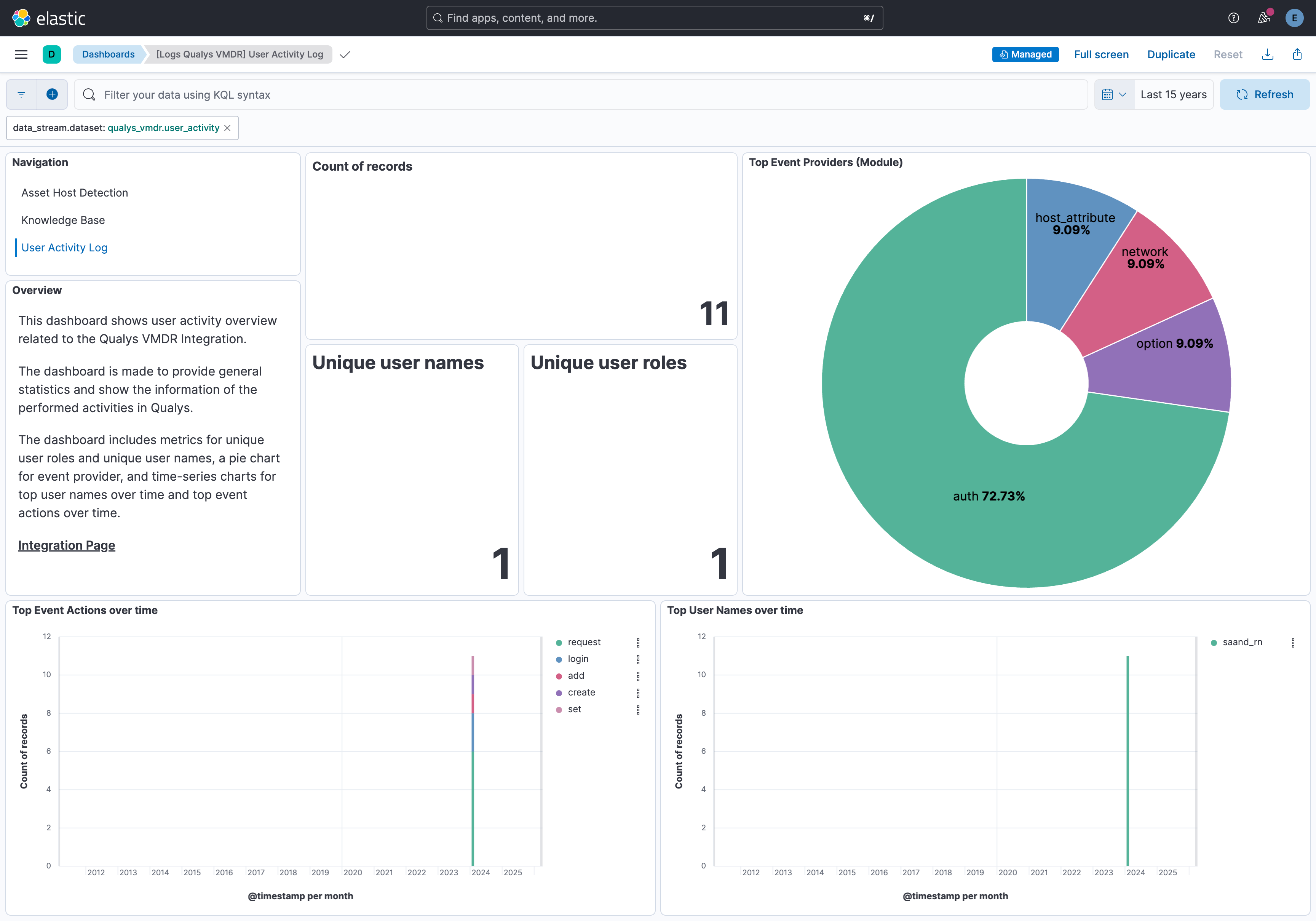

| User Activity Log |

By default, the input parameter is set to action=list.
This is the Asset Host Detection dataset.
