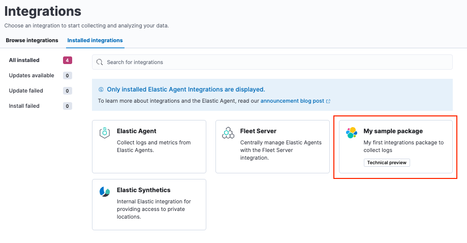

  3. After the command runs, check that your new package appears in Kibana under Management > Integrations > Installed integrations.
    Kibana installed integrations tab with a card for my sample package

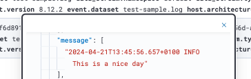

  6. Confirm that your log file is being ingested as expected:
    1. In Kibana, open Discover.
    2. In the search field, enter log.file.path.text : *. The search should return a couple of log entries.
    3. Hover over an entry and click Enter to view the cell contents.
      Data stream showing log message: "this is a nice day"
