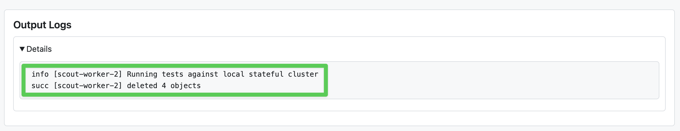

You'll see this output in your local console, in the Buildkite job log for CI runs, and in the Scout HTML report (attached to each test, under Output Logs):
Scout HTML report Output Logs section
