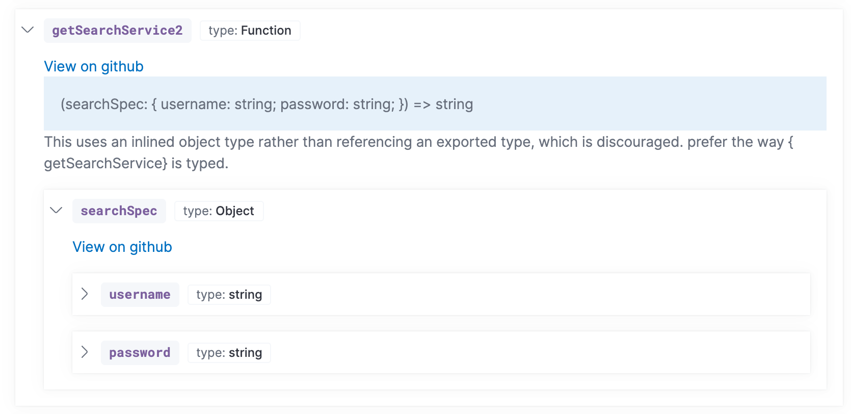

over:
* Retrieve search services
* @param searchSpec Configuration information for initializing the search service.
* @returns the id of the search service
export getSearchService: (searchSpec: { username: string; password: string }) => string;
In the former, there will be a link to the SearchSpec interface with documentation for the username and password properties. In the latter the object will render inline, without comments:

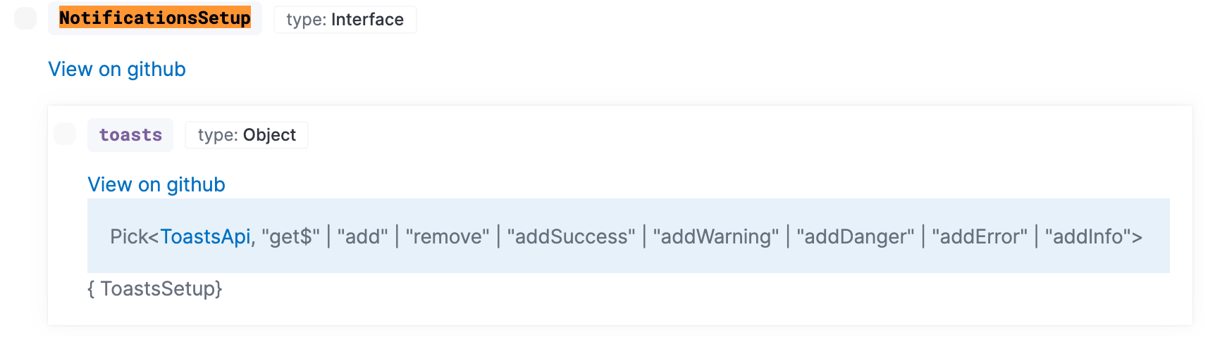

Pick not only ends up being unhelpful in our documentation system, but it's also of limited help in your IDE. For that reason, avoid Pick and other similarly complex types on your public API items. Using these semantics internally is fine.
