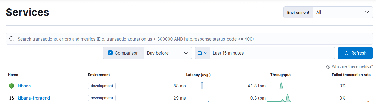

In some cases, it is beneficial to enable APM on a local development environment to get an initial undesrtanding of a feature's performance during manual or automatic tests.
  1. Create a secondary monitoring deployment to collect APM data. The easiest option is to use Elastic Cloud to create a new deployment.
  2. Open the Kibana from the monitoring deployment (not your local Kibana), go to Integrations and enable the Elastic APM integration.
  3. Scroll down and copy the server URL and secret token. You may also find them in your cloud console under APM & Fleet.
  4. Create or open config\kibana.dev.yml on your local development environment.
  5. Add the following settings:
elastic.apm.active: true
elastic.apm.serverUrl: <serverUrl>
elastic.apm.secretToken: <secretToken>
  1. Once you run kibana and start using it, two new services (kibana, kibana-frontend) should appear under the APM UI on the APM deployment. APM UI
