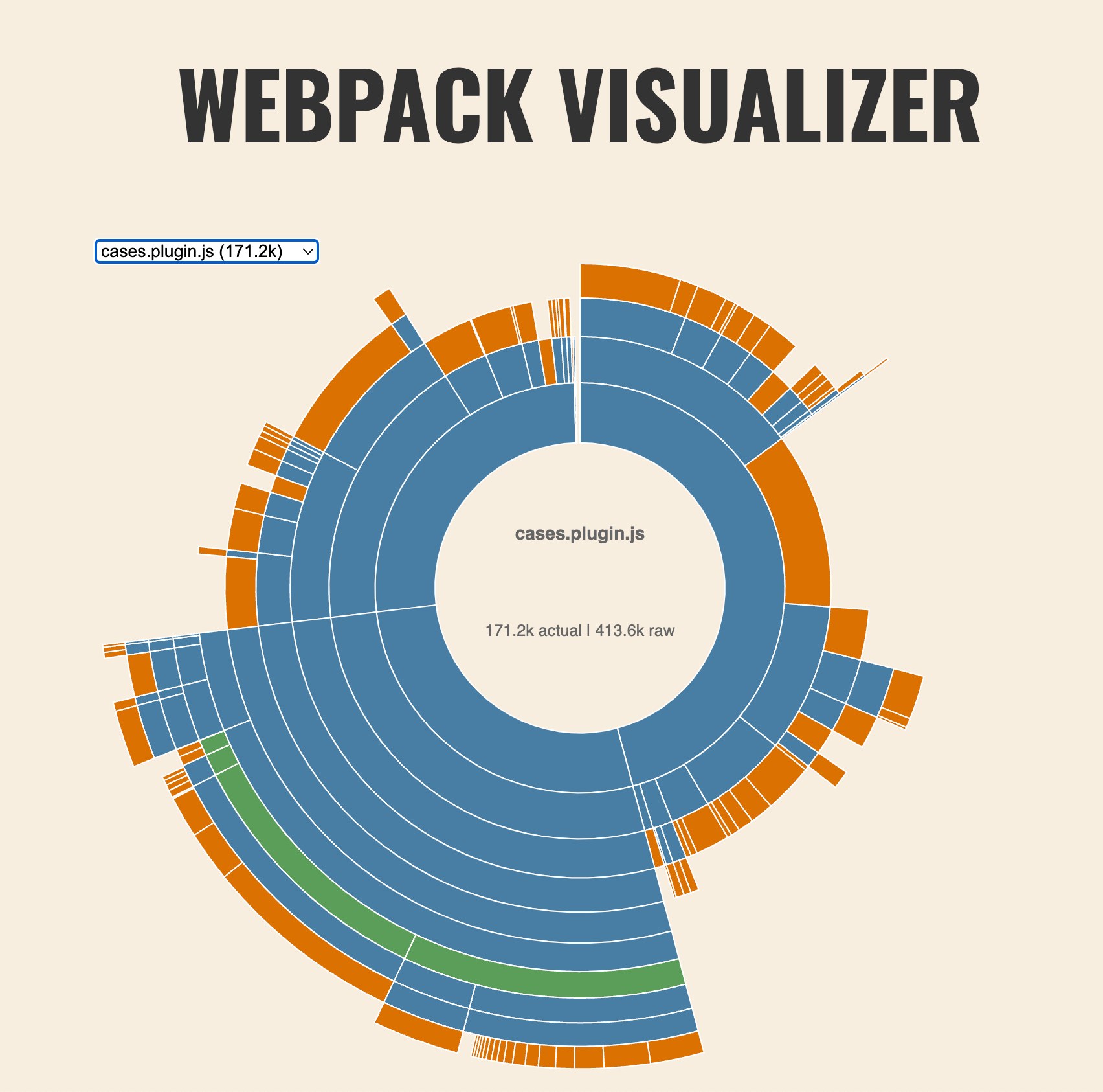

Then, I loaded the stats.json file in the Webpack Bundle Analyzer:
Webpack Bundle Analyzer showing the cases plugin bundle before optimization

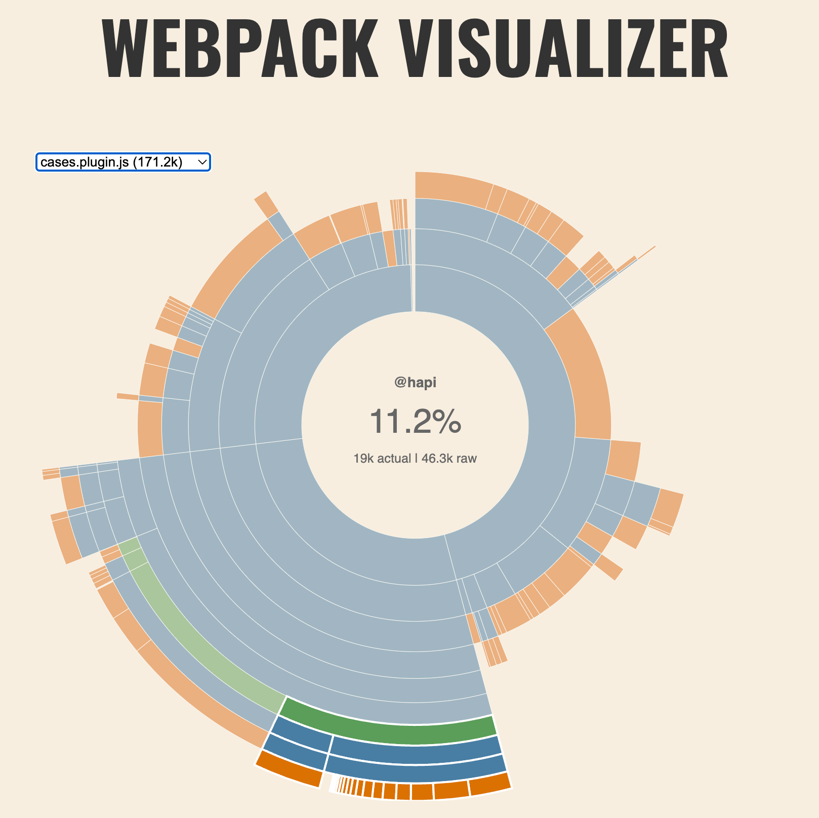

Looking at the dependencies, I noticed that the cases plugin bundle included @hapi/boom and @hapi/hoek.
Webpack Bundle Analyzer showing the inclusion of hapi and hapi-boom
The @hapi/boom package provides utilities for creating "HTTP-friendly error objects"-- e.g. "Error 500: Internal Server Error"-- and @hapi/hoek is a dependency of @hapi/boom. So the quesion became:
Important
Why is a utility for delivering HTTP error messages included in the client bundle?
The common directory contained a set of validators that utilized @hapi/boom. The validators export obscured the fact that the code was only relevant to the server.
A Kibana plugin copies any code in the common directory to both the server and client bundles. Since the common directory contained code which was only relevant to the server bundle, using libraries that were only relevant to server code, the cases client bundle included server-only libraries that were not used, (nor useful).

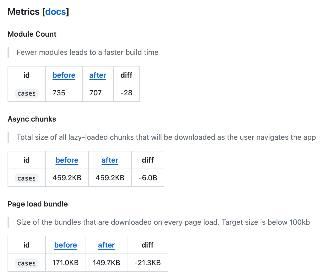

Moving the validators to the server portion of the plugin reduced the size of the cases client bundle by 21.3KB, or 12.5%.

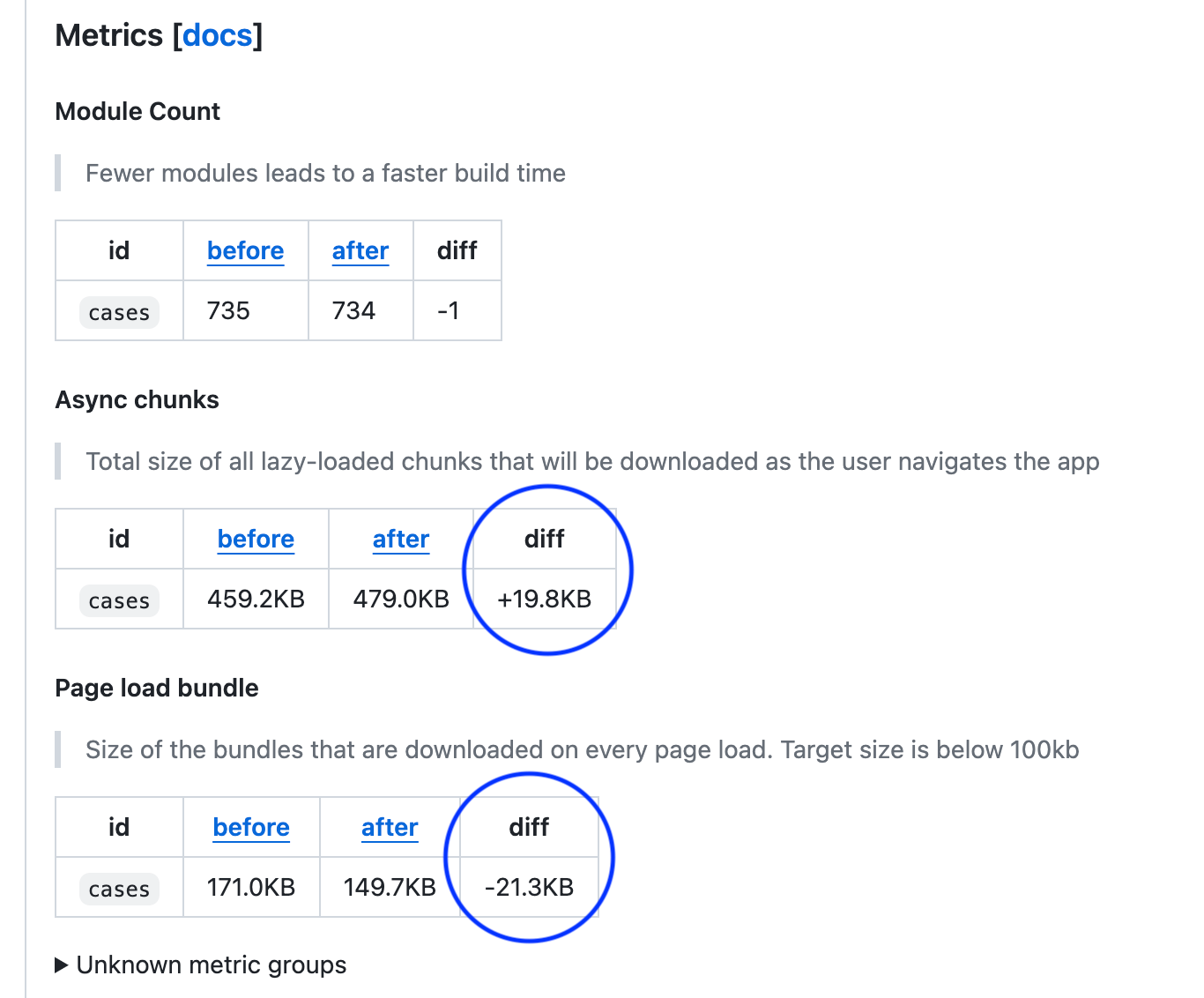

This was a PR that had a clear sign I had missed an export. I had removed the validators from the common directory, but I had missed one export. The CI build caught this by flagging the increase in async chunks. Had I only examined the page bundle size, I would have left the server code to be loaded not in the bundle, but on demand, (which brings with it its own set of issues).
CI build showing the missed export
