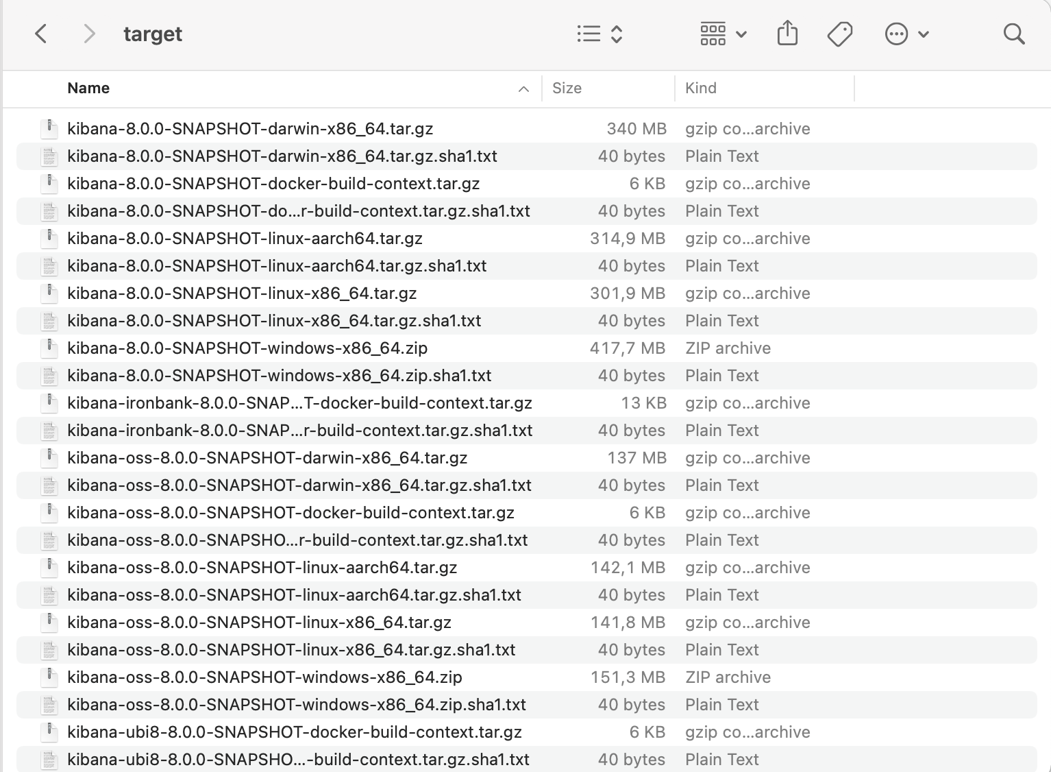

At the end of the process a Kibana distributable was created in a target folder created relative to your repository checkout.
The folder will look like the following:

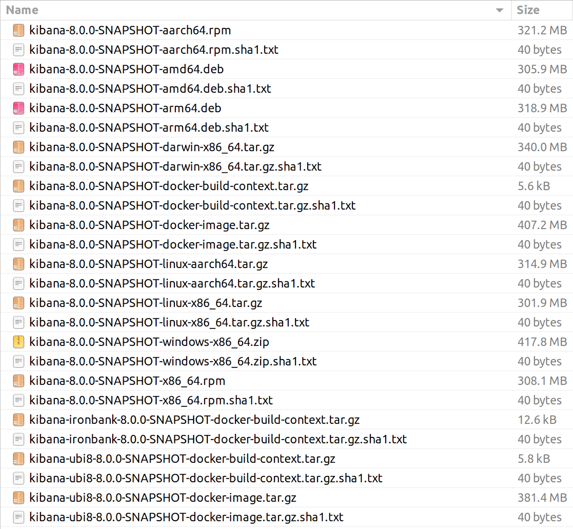

At the end you will get the Kibana distributable archives plus the Docker images and both an rpm and a deb package.
To specify just a single installation package or Docker images to build instead of all of them you can add rpm, deb or docker-images as an argument:
yarn build --deb
yarn build --rpm
yarn build --docker-images
Again the distributable contents resulting from running the build command can be found in a target folder created relative to the repository after the build completes.
It will look something like:
