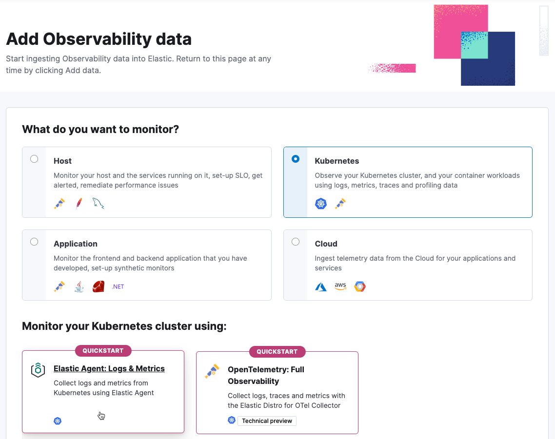

Go to your Elastic Observability Serverless project, then go to Add data.
In the What do you want to monitor? section, select Kubernetes, and then select Elastic Agent: Logs & Metrics.
To install Elastic Agent on your host, copy and run the install command.

In Kibana, go to the Observability overview page, and click Add Data.

In Kibana, go to the Observability UI and click Add Data.

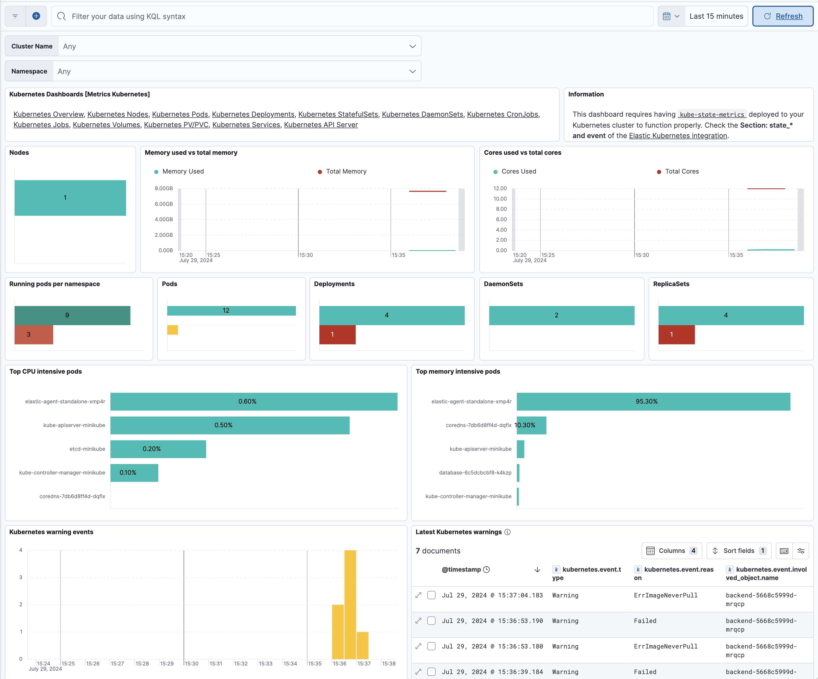

After installation is complete and all relevant data is flowing into Elastic, the Visualize your data section allows you to access the Kubernetes Cluster Overview dashboard that can be used to monitor the health of the cluster.
Furthermore, you can access other useful prebuilt dashboards for monitoring Kubernetes resources, for example running pods per namespace, as well as the resources they consume, like CPU and memory.
