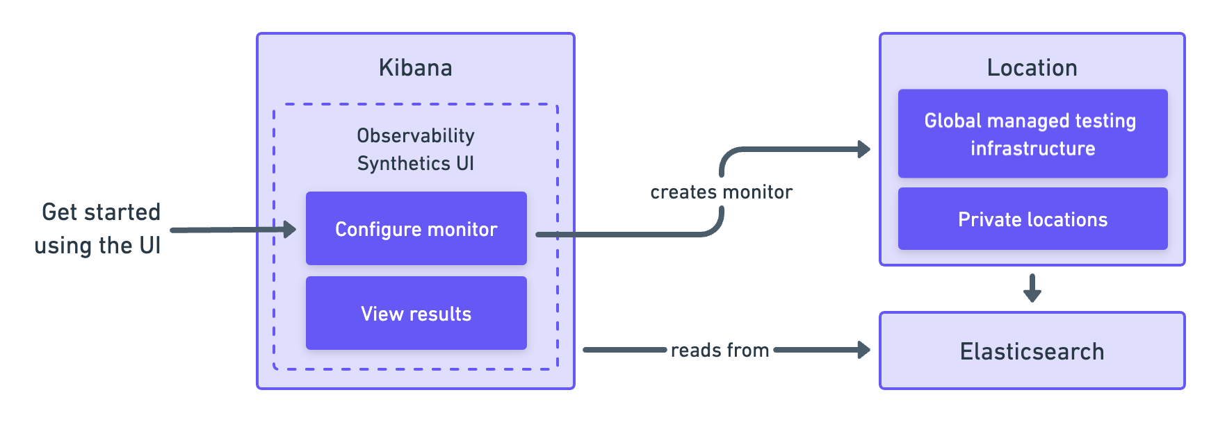

Diagram showing which pieces of software are used to configure monitors
This is one of two approaches you can use to set up a synthetic monitor.

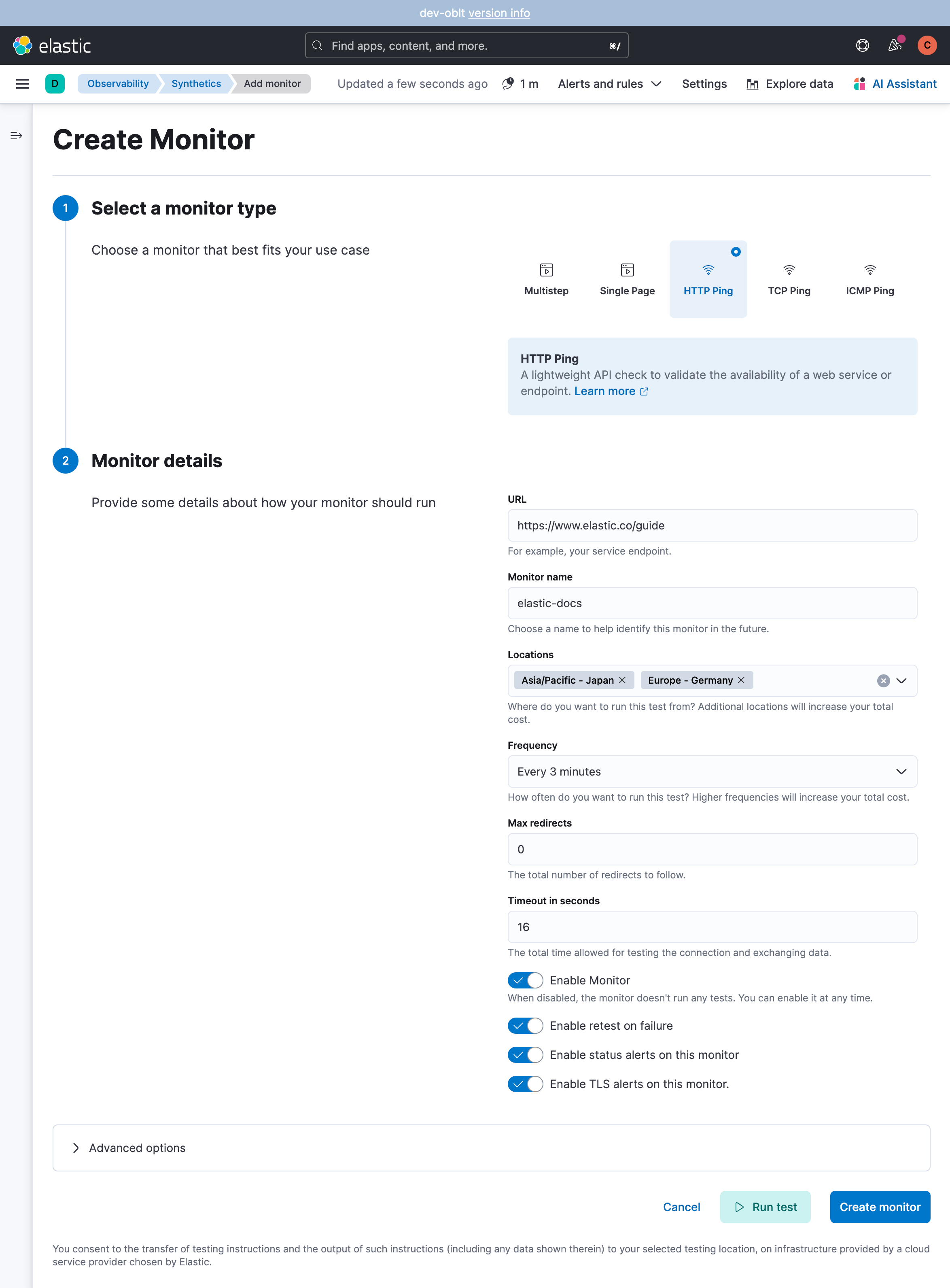

To use the UI to add a lightweight monitor:
  1. Find Synthetics in the global search field.
  2. Click Create monitor.
  3. Set the monitor type to HTTP Ping, TCP Ping, or ICMP Ping.

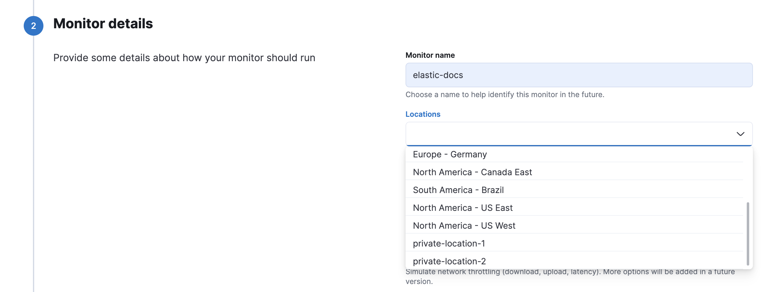

  4. In Locations, select one or more locations.
    Note
    If you don’t see any locations listed, refer to the troubleshooting guide for guidance.
    Note
    If you’ve added a Private Location, you’ll see your the Private Location in the list of Locations.
    Screenshot of Monitor locations options including a {{private-location}}
  5. Set the Frequency, and configure the monitor as needed.
  6. Click Advanced options to see more ways to configure your monitor.
  7. (Optional) Click Run test to verify that the test is valid.
  8. Click Create monitor.

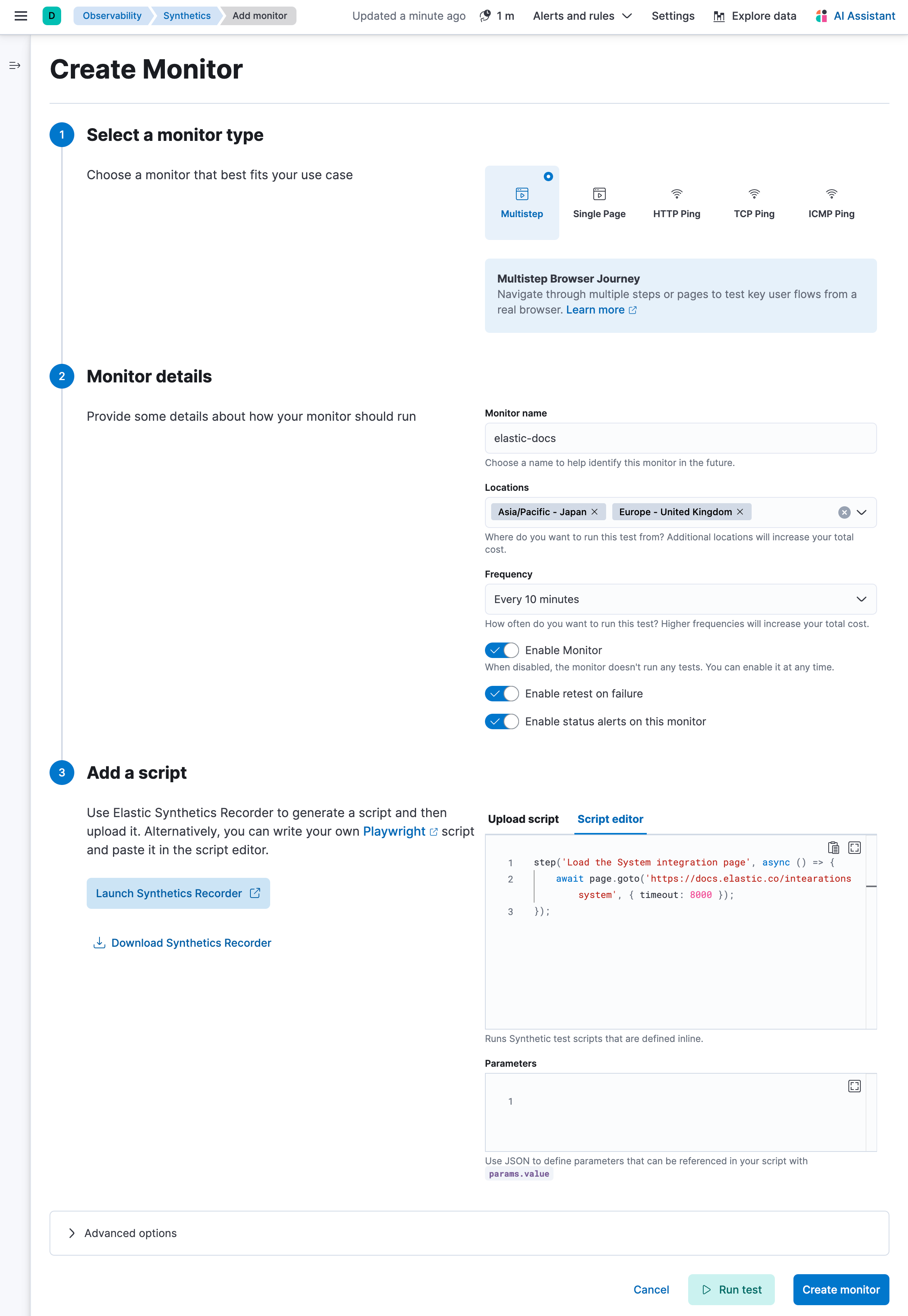

To use the UI to add a browser monitor:
  1. Click Create monitor.
  2. Set the monitor type to Multistep.
  3. In Locations, select one or more locations.
    Note
  4. Set the Frequency.
  5. Add steps to the Script editor code block directly. The journey keyword isn’t required, and variables like page and params will be part of your script’s scope. You cannot import any dependencies when using inline browser monitors.
    Configure a synthetic monitor using an inline script in Elastic {{fleet}}
    Note
    Alternatively, you can use the Script recorder option. You can use the Elastic Synthetics Recorder to interact with a web page, export journey code that reflects all the actions you took, and upload the results in the UI. For more information, refer to Use the Synthetics Recorder.
    • Use Data options to add context to the data coming from your monitors.
    • Use the Synthetics agent options to provide fine-tuned configuration for the synthetics agent. Read more about available options in Use the Synthetics CLI.
