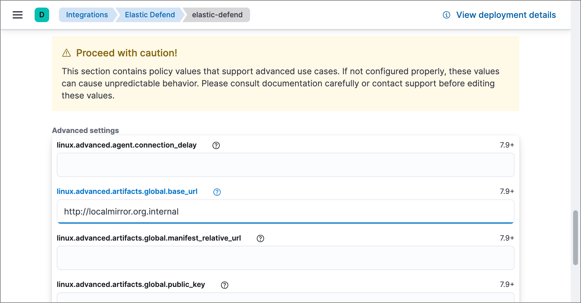

Set the advanced.artifacts.global.base_url advanced setting for each Elastic Defend integration policy that needs to use the mirror. Note that there’s a separate setting for each operating system:
linux.advanced.artifacts.global.base_urlmac.advanced.artifacts.global.base_urlwindows.advanced.artifacts.global.base_url

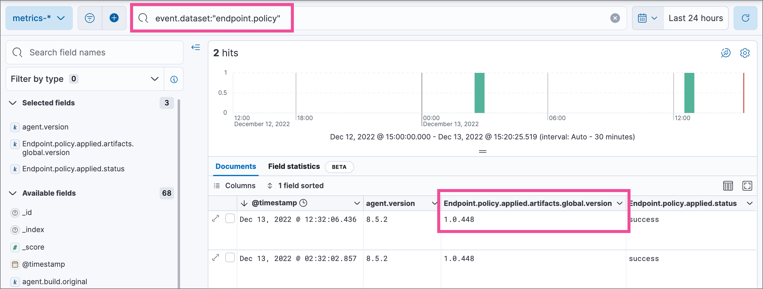

After updating the Elastic Endpoint configuration to read from the mirror server, use Kibana's Discover view to search the metrics-* data view for endpoint.policy response documents, then check the installed version (Endpoint.policy.applied.artifacts.global.version) and compare with the output from the command above:
