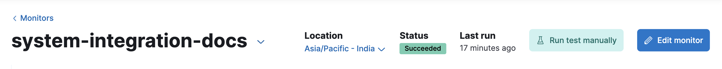

When you open an individual monitor’s page, you see much more detail about the monitor’s performance over time. The details vary by monitor type, but for every monitor at the top of the page you see:
  • The monitor’s name with a down arrow icon that you can use to quickly move between monitors.
  • The location of the monitor. If the same monitor configuration was used to create monitors in multiple locations, you also see a down arrow icon that you can use to quickly move between locations that use the same configuration.
  • The latest status and when the monitor was last run.
  • Actions: Use Run test manually to run the test on demand before the next scheduled run, and Edit monitor to edit the monitor’s configuration.

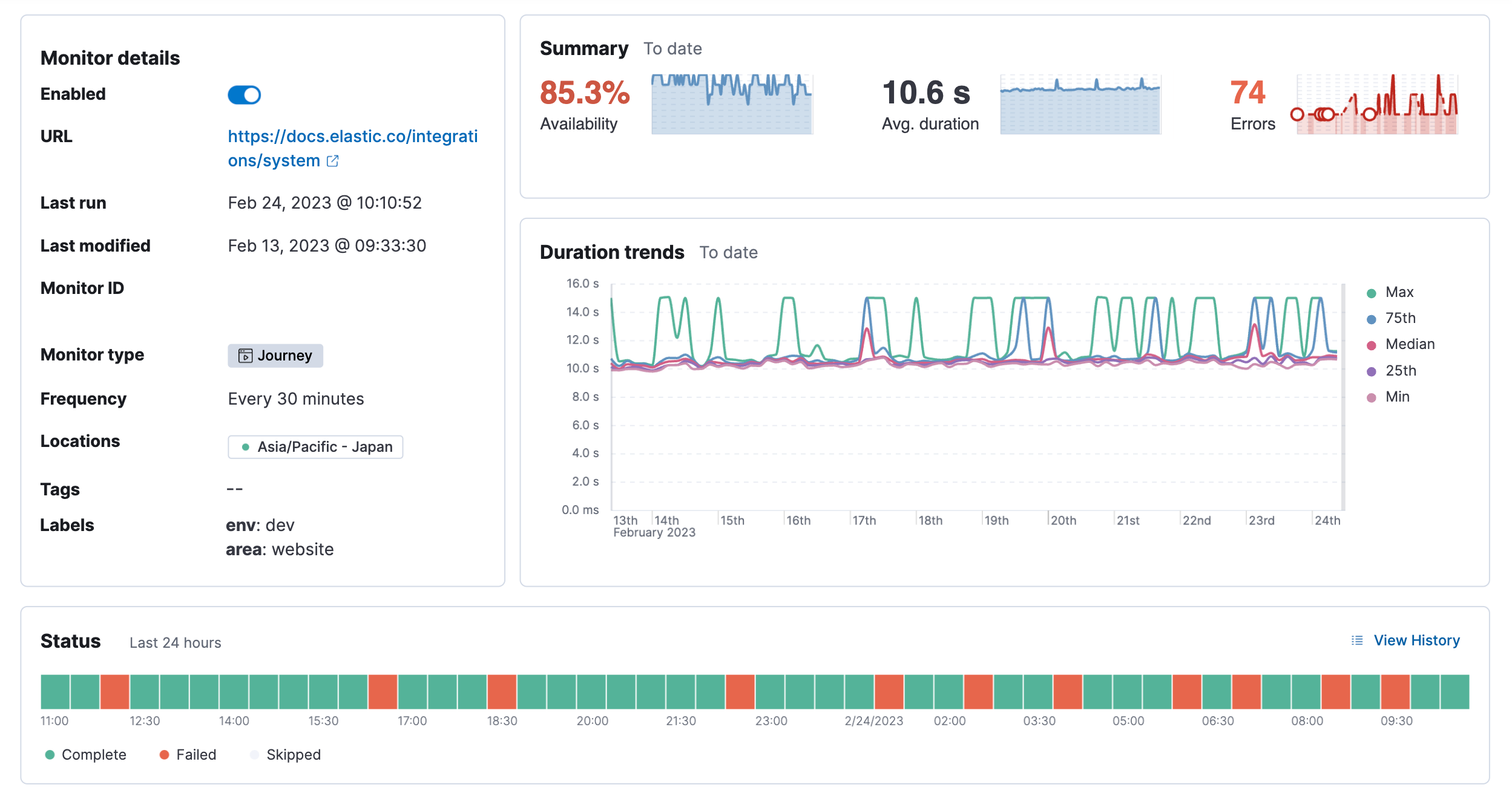

The Overview tab has information about the monitor availability, duration, and any errors that have occurred since the monitor was created. The Duration trends chart displays the timing for each check that was performed in the last 30 days. This visualization helps you to gain insights into how quickly requests resolve by the targeted endpoint and gives you a sense of how frequently a host or endpoint was down.
Details in the Overview tab on the individual monitor page for all monitor types in the Synthetics app
For monitors that run on Private Locations, the Monitor details panel also shows which Elastic Agents run the monitor. If all the monitor's Private Locations are scalable, the panel shows the Assigned agent that runs the monitor, or Not yet assigned if Synthetics hasn't assigned an agent yet. Otherwise, it shows the Location agents, which are all the agents enrolled on the location's agent policy.

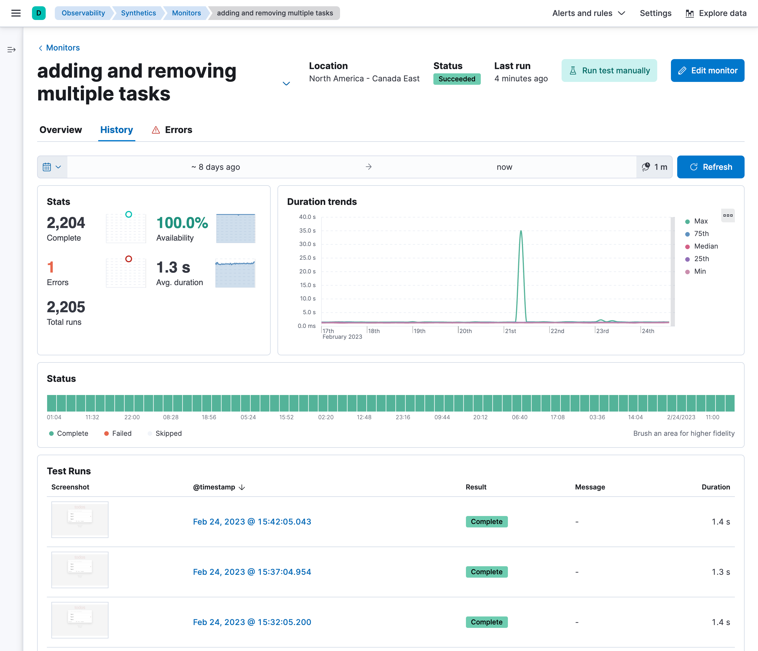

The History tab has information on every time the monitor has run. It includes some high-level stats and a complete list of all test runs. Use the calendar icon (Calendar icon) and search bar to filter for runs that occurred in a specific time period.
For browser monitors, you can click on any run in the Test runs list to see the details for that run. Read more about that information in Details for one run.

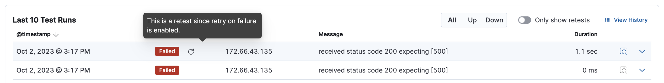

If the monitor is configured to retest on failure, you see retests listed in the Test runs table. Runs that are retests include a rerun icon (Refresh icon) next to the result badge.
A failed run and a retest in the table of test runs in the Synthetics app

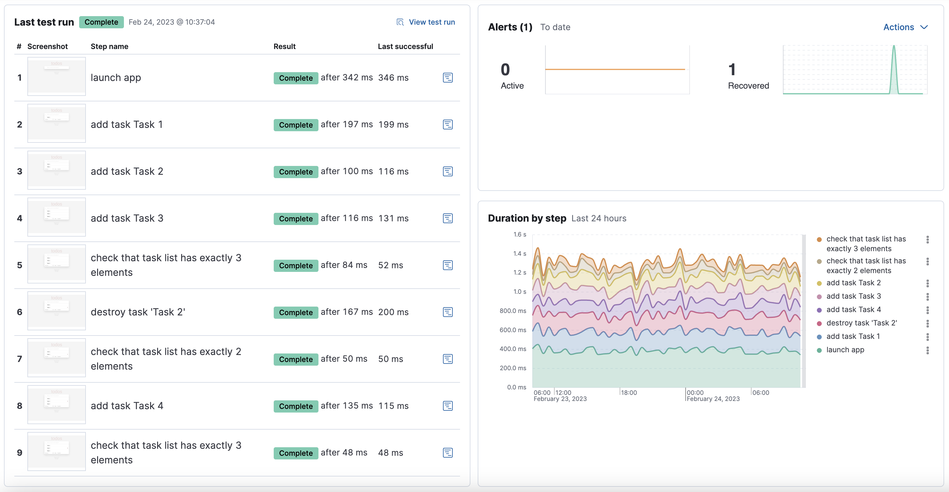

The journey page on the Overview tab includes:
  • An overview of the last test run including high-level information for each step.
  • Alerts to date including both active and recovered alerts.
  • Duration by step over the last 24 hours.
  • A list of the last 10 test runs that link to the details for each run.

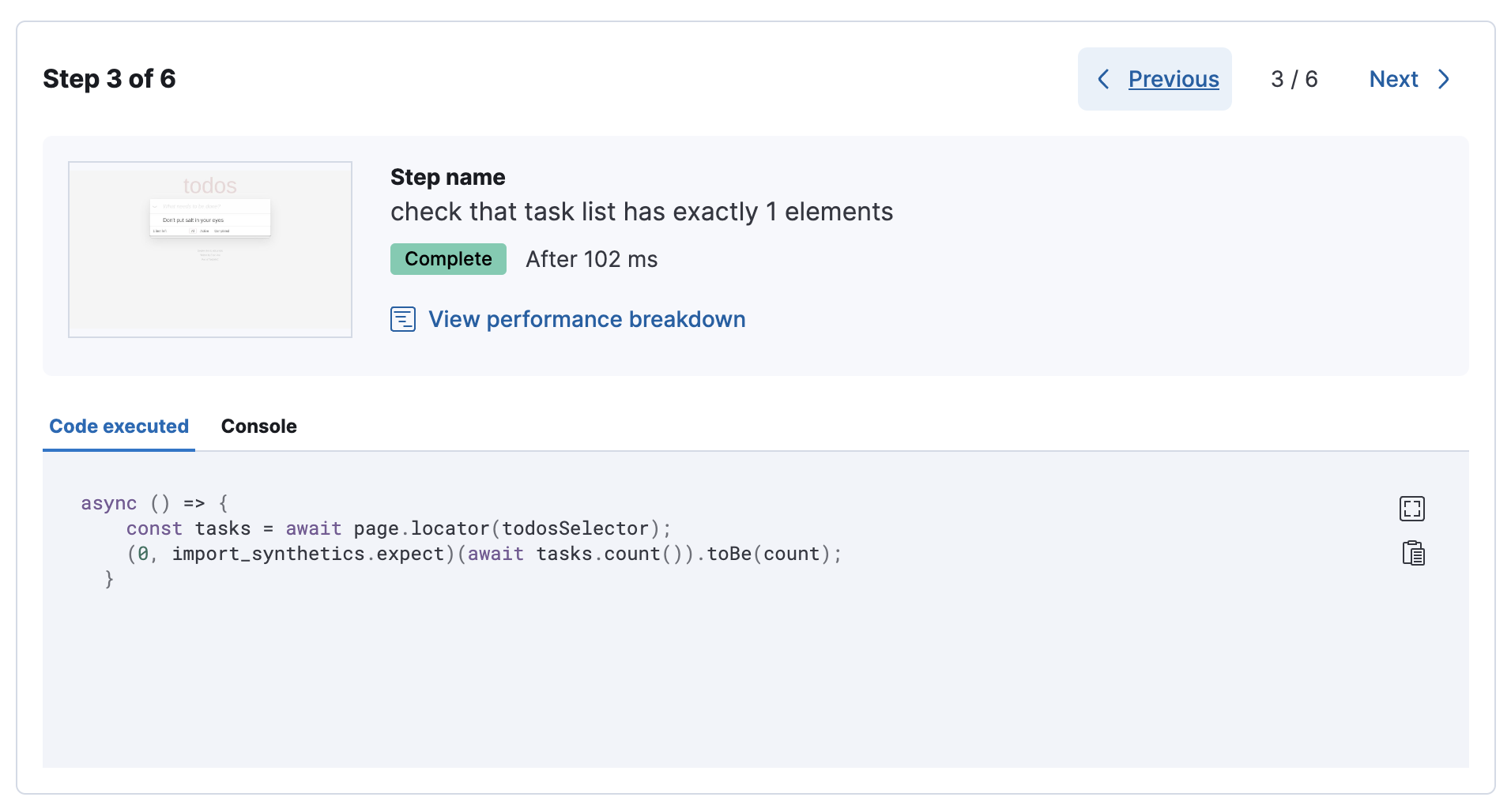

The page detailing one run for a journey includes more information on each step in the current run and opportunities to compare each step to the same step in previous runs.
At the top of the page, see the Code executed and any Console output for each step. If the step failed, this also includes a Stacktrace tab that you can use to diagnose the cause of errors.
Navigate through each step using Previous icon Previous and Next Next icon.
Open the steps in this journey run. Click the Arrow right icon icon next to the step number to show details. The details include metrics for the step in the current run and the step in the last successful run. Read more about step-level metrics in Timing and Metrics.

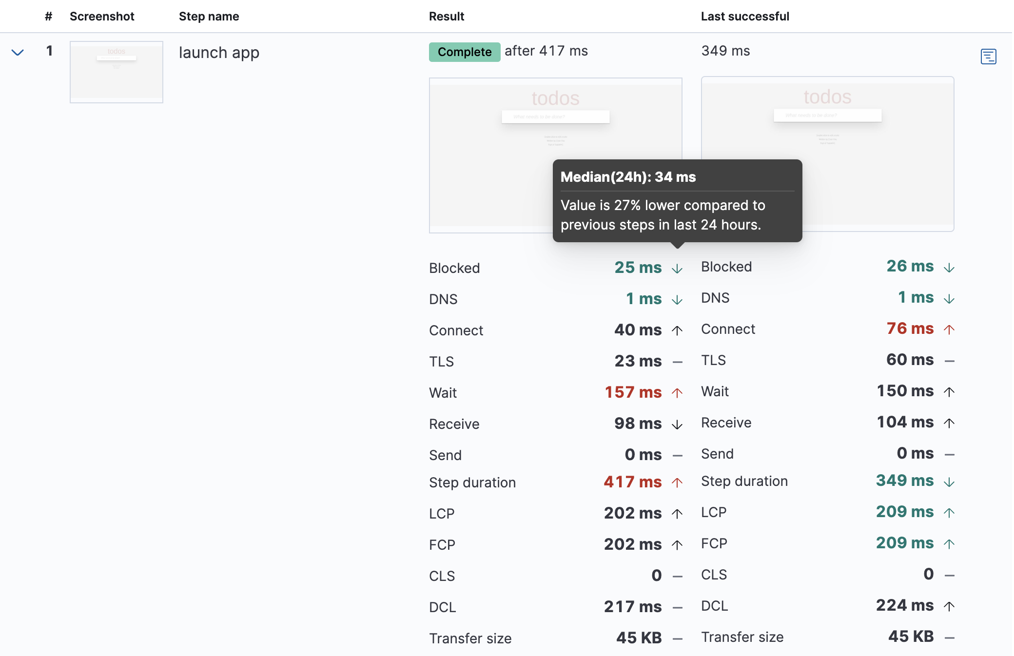

This is particularly useful to compare the metrics for a failed step to the last time it completed successfully when trying to diagnose the reason it failed.

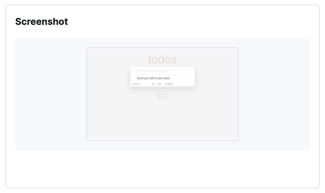

By default the synthetics library captures a screenshot for each step regardless of whether the step completed or failed.
Note
Customize screenshot behavior for all monitors in the configuration file, for one monitor using monitor.use, or for a run using the CLI.
Screenshots can be particularly helpful to identify what went wrong when a step fails because of a change to the UI. You can compare the failed step to the last time the step successfully completed.

The Timing visualization shows a breakdown of the time spent in each part of the resource loading process for the step including:
  • Blocked: The request was initiated but is blocked or queued.
  • DNS: The DNS lookup to convert the hostname to an IP Address.
  • Connect: The time it took the request to connect to the server. Lengthy connections could indicate network issues, connection errors, or an overloaded server.
  • TLS: If your page is loading resources securely over TLS, this is the time it took to set up that connection.
  • Wait: The time it took for the response generated by the server to be received by the browser. A lengthy Waiting (TTFB) time could indicate server-side issues.
  • Receive: The time it took to receive the response from the server, which can be impacted by the size of the response.
  • Send: The time spent sending the request data to the server.
Next to each network timing metric, there’s an icon that indicates whether the value is higher (Value is higher icon), lower (Value is lower icon), or the same (Value is the same) compared to the median of all runs in the last 24 hours. Hover over the icon to see more details in a tooltip.
This gives you an overview of how much time is spent (and how that time is spent) loading resources. This high-level information may not help you diagnose a problem on its own, but it could act as a signal to look at more granular information in the Network requests section.

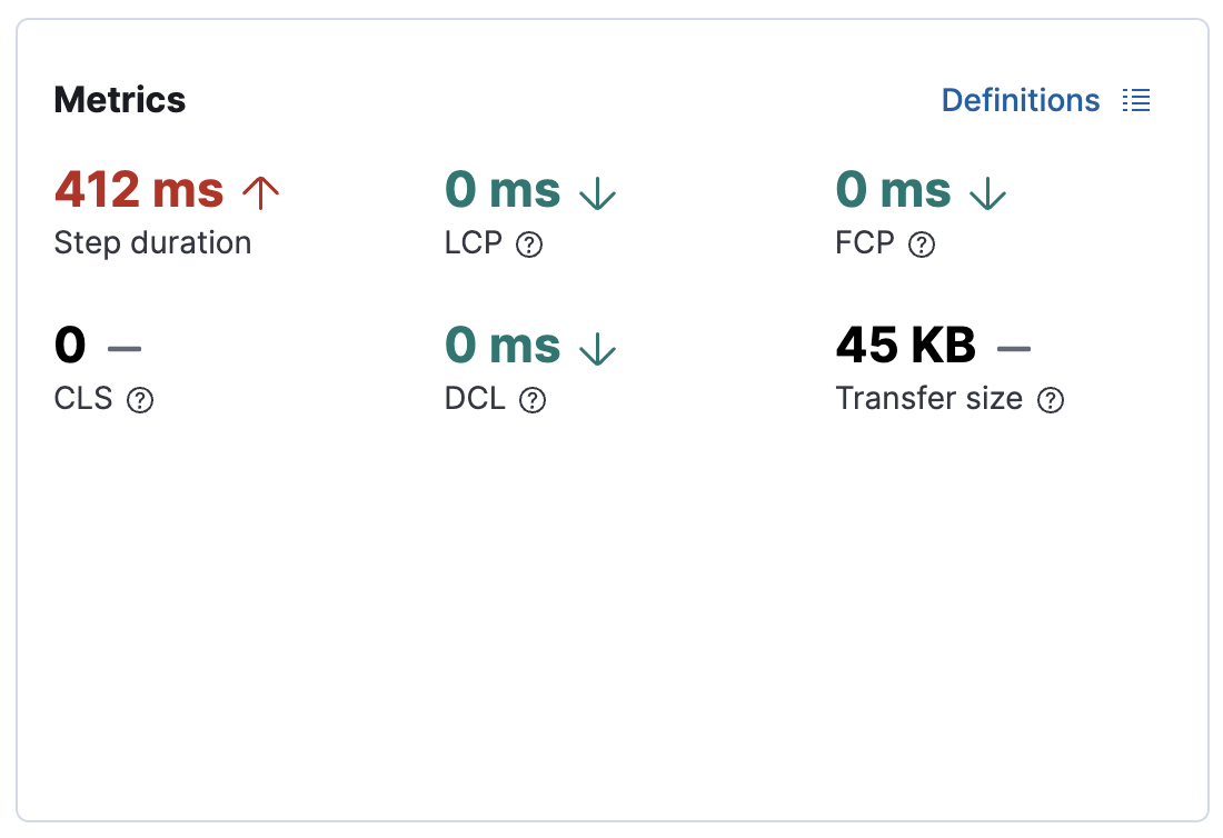

The Metrics visualization gives you insight into the performance of the web page visited in the step and what a user experiences when going through the current step. Metrics include:
  • First contentful paint (FCP) focuses on the initial rendering and measures the time from when the page starts loading to when any part of the page’s content is displayed on the screen.
  • Largest contentful paint (LCP) measures loading performance. To provide a good user experience, LCP should occur within 2.5 seconds of when the page first starts loading.
  • Cumulative layout shift (CLS) measures visual stability. To provide a good user experience, pages should maintain a CLS of less than 0.1.
  • DOMContentLoaded event (DCL) is triggered when the browser completes parsing the document. Helpful when there are multiple listeners, or logic is executed: domContentLoadedEventEnd - domContentLoadedEventStart.
  • Transfer size represents the size of the fetched resource. The size includes the response header fields plus the response payload body.
Note
Largest contentful paint and Cumulative layout shift are part of Google’s Core Web Vitals, an initiative that introduces a set of metrics that help categorize good and bad sites by quantifying the real-world user experience.
Next to each metric, there’s an icon that indicates whether the value is higher (Value is higher icon), lower (Value is lower icon), or the same (Value is the same) compared to all runs over the last 24 hours. Hover over the icon to see more details in a tooltip.
Metrics visualization for one step in a browser monitor in the Synthetics app

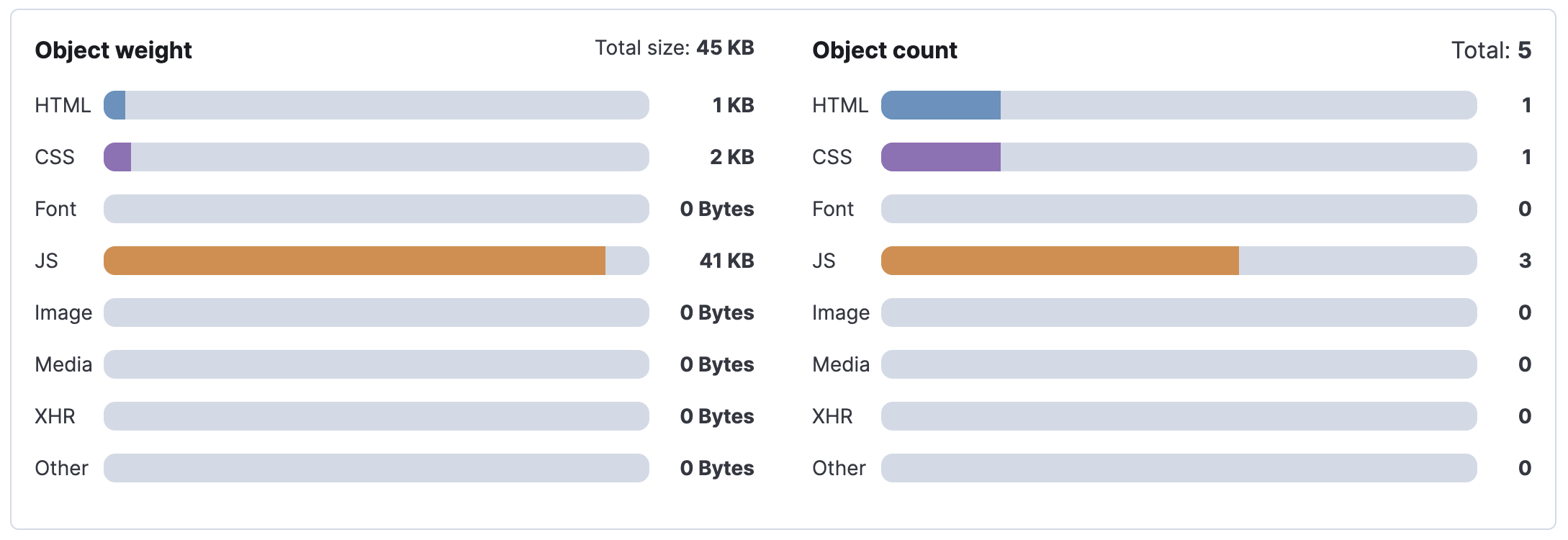

The Object weight visualization shows the cumulative size of downloaded resources by type, and Object count shows the number of individual resources by type.
This provides a different kind of analysis. For example, you might have many JavaScript files, each of which needs a separate download, but they can be collectively small. This could help you identify an opportunity to improve efficiency by combining multiple files into one.
Object visualization for one step in a browser monitor in the Synthetics app

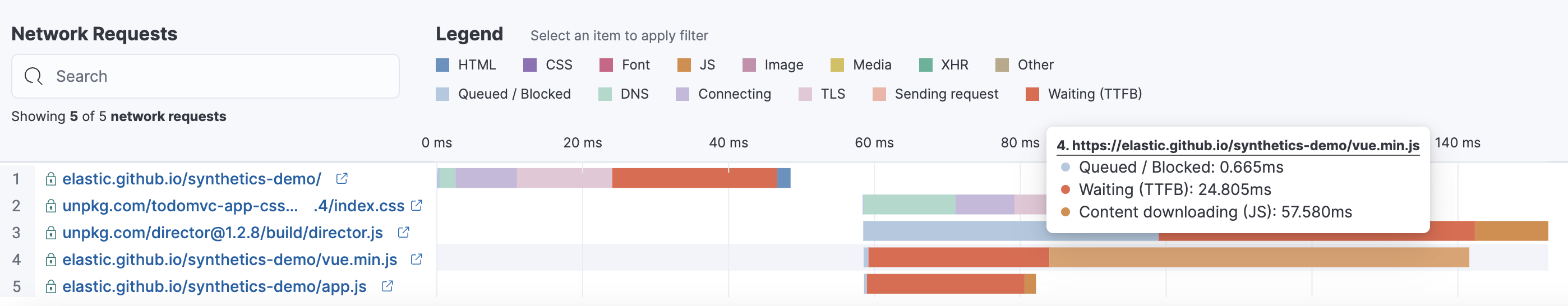

The Network requests visualization is a waterfall chart that shows every request the page made when a user executed it. Each line in the chart represents an HTTP network request and helps you quickly identify what resources are taking the longest to load and in what order they are loading.
The colored bars within each line indicate the time spent per resource. Each color represents a different part of that resource’s loading process (as defined in Timing) and includes the time spent downloading content for specific Multipurpose Internet Mail Extensions (MIME) types: HTML, JS, CSS, Media, Font, XHR, and Other.
Understanding each phase of a request can help you improve your site’s speed by reducing the time spent in each phase.
Network requests waterfall visualization for one step in a browser monitor in the Synthetics app
Without leaving the waterfall chart, you can view data points relating to each resource: resource details, request headers, response headers, and certificate headers. On the waterfall chart, select a resource name, or any part of each row, to display the resource details overlay.
For additional analysis, whether to check the content of a CSS file or to view a specific image, click the External link icon icon located beside each resource, to view its content in a new tab.
