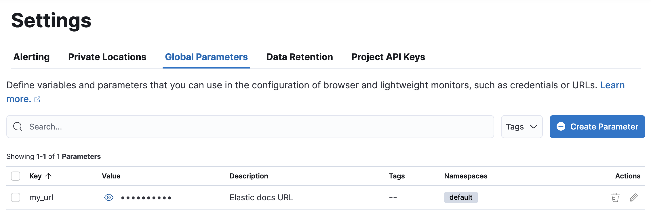

From any page in the Synthetics UI:
  1. Go to Settings. Depending on your version, it can be in the More menu.
  2. Go to the Global parameters tab.
  3. Define parameters.

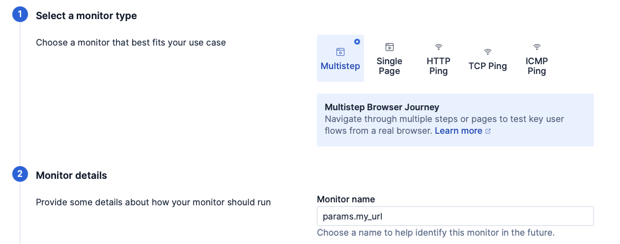

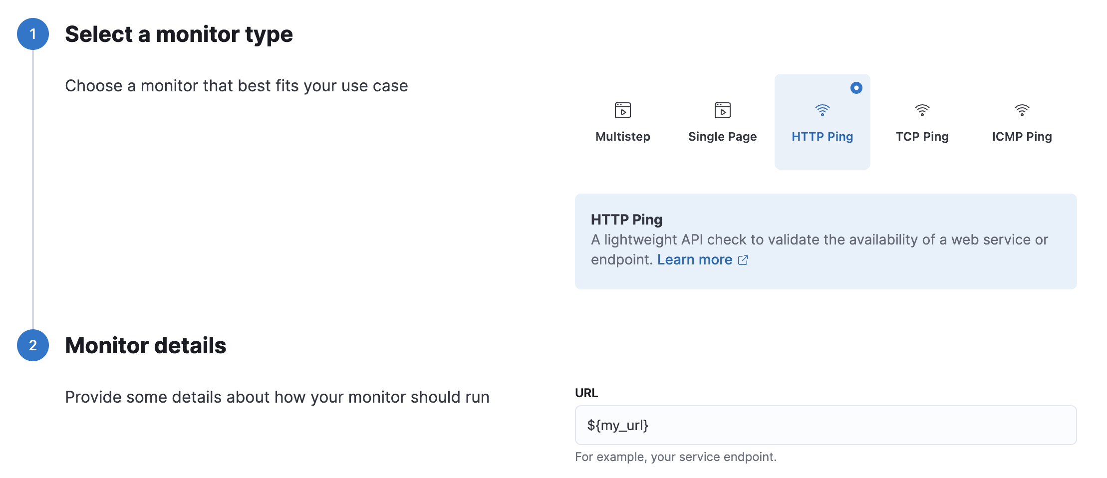

To use a param in a lightweight monitor that is created in the Synthetics UI, wrap the name of the param in ${} (for example, ${my_url}).
To use a param in a browser monitor that is created in the Synthetics UI, add params. before the name of the param (for example, params.my_url).
