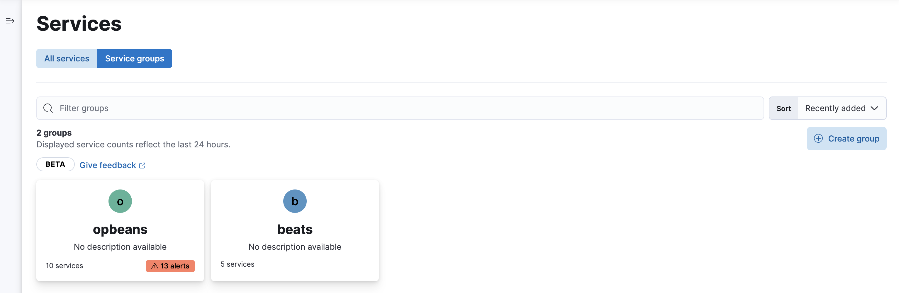

If you’re using the service groups feature, you can view alerts by service group. From the service group overview page, click the red alert indicator to open the Alerts tab with a predefined filter that matches the filter used when creating the service group.
Example view of service group in the Applications UI in Kibana

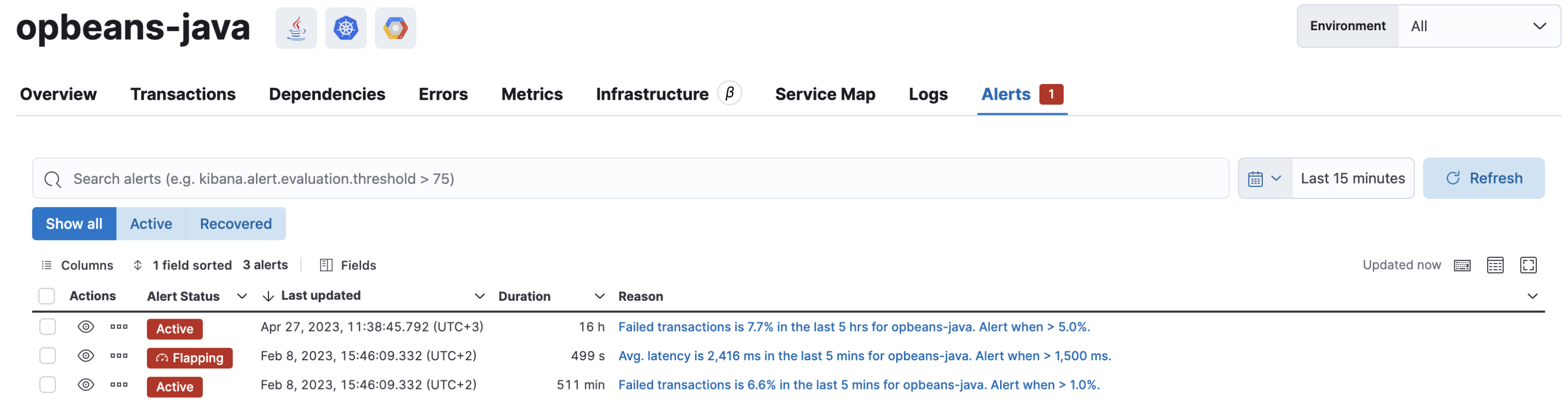

Alerts can be viewed within the context of any service. After selecting a service, go to the Alerts tab to view any alerts that are active for the selected service.
View active alerts by service
