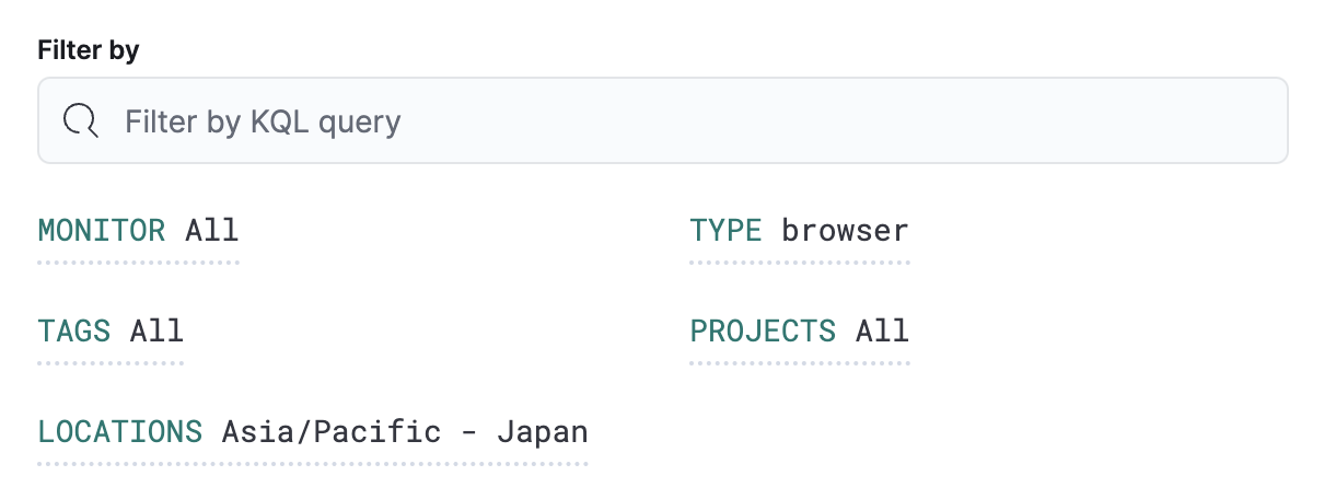

The Filter by section controls the scope of the rule. The rule will only check monitors that match the filters defined in this section. In this example, the rule will only alert on browser monitors located in Asia/Pacific - Japan.
Filter by section of the Synthetics monitor status rule
Conditions for each rule will be applied to all monitors that match the filters in the Filter by section. You can choose the number of times the monitor has to be down relative to either a number of checks run or a time range in which checks were run, and the minimum number of locations the monitor must be down in.

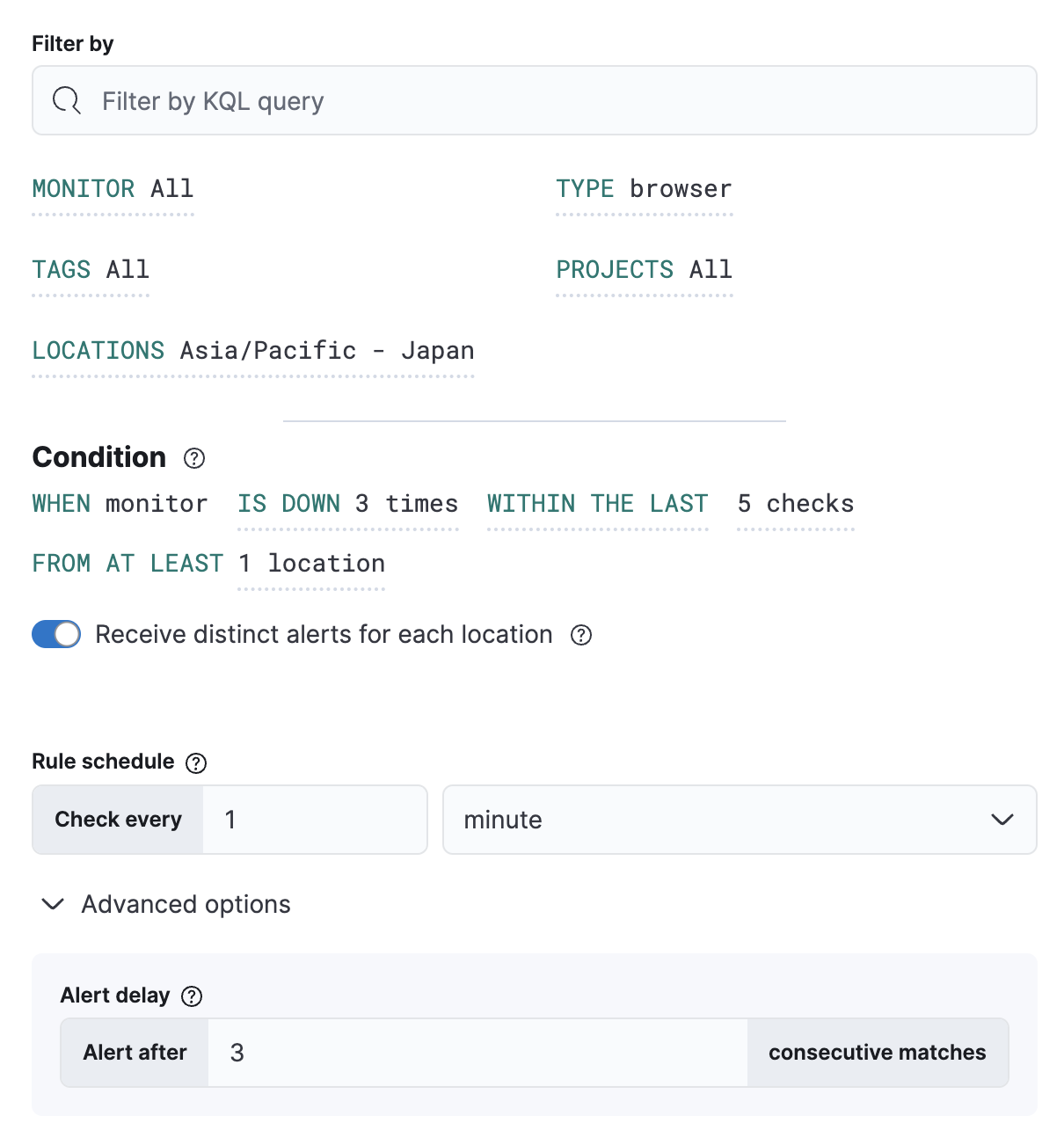

The Rule schedule defines how often to evaluate the condition. Note that checks are queued, and they run as close to the defined value as capacity allows. For example, if a check is scheduled to run every 2 minutes, but the check takes longer than 2 minutes to run, a check will not run until the previous check has finished.
In this example, the conditions will be met any time a browser monitor is down 3 of the last 5 times the monitor ran across any locations that match the filter. These conditions will be evaluated every minute, and you will only receive an alert when the conditions are met three times consecutively.
Filters and conditions defining a Synthetics monitor status rule

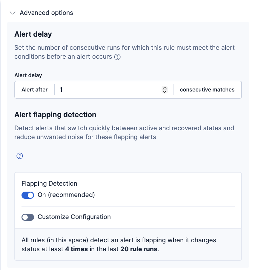

You can also set Advanced options such as:
  • Alert delay: The number of consecutive runs that must meet the rule conditions before an alert occurs.
  • Alert flapping detection: Detect alerts that switch quickly between active and recovered states and reduce unwanted noise for these flapping alerts.
    You can also customize the configuration through the following settings:
    • Rule run look back window: The minimum number of runs in which the threshold must be met.
    • Alert status change threshold: The minimum number of times an alert must switch states in the look-back window.
Advanced settings when defining a Synthetics monitor status rule

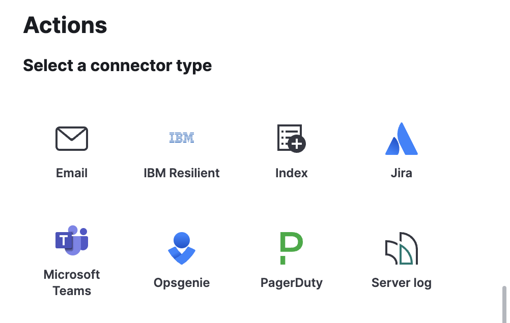

Extend your rules by connecting them to actions that use the following supported built-in integrations.
Note
Some connector types are paid commercial features, while others are free. For a comparison of the Elastic subscription levels, go to the subscription page.

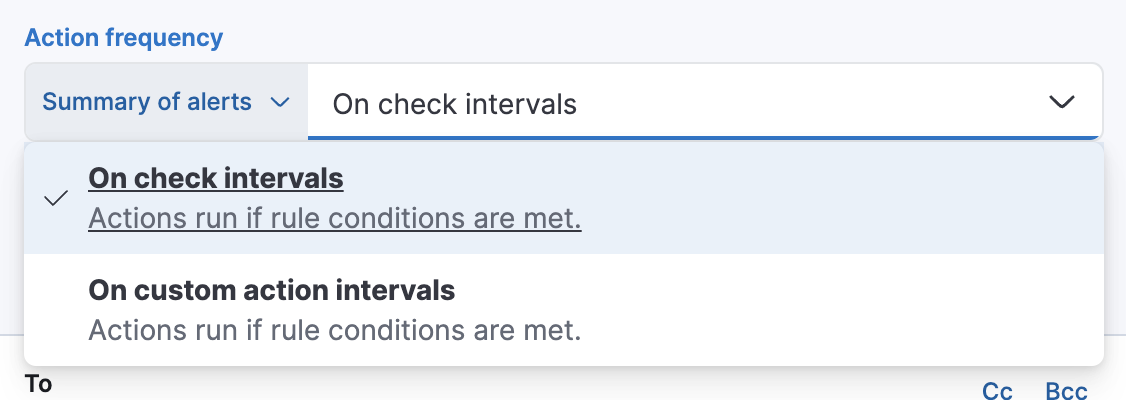

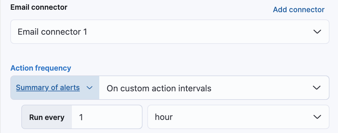

After you select a connector, you must set the action frequency. You can choose to create a summary of alerts on each check interval or on a custom interval. For example, send email notifications that summarize the new, ongoing, and recovered alerts each hour:
synthetic monitor action types summary
Alternatively, you can set the action frequency such that you choose how often the action runs (for example, at each check interval, only when the alert status changes, or at a custom action interval). In this case, you must also select the specific threshold condition that affects when actions run: the Synthetics monitor status changes or when it is Recovered (went from down to up).
synthetic monitor action types each alert

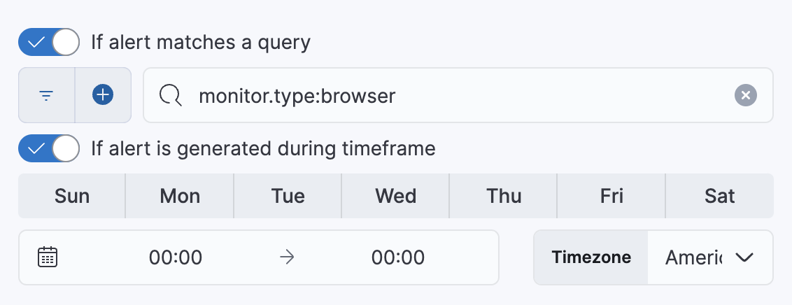

You can also further refine the conditions under which actions run by specifying that actions only run when they match a KQL query or when an alert occurs within a specific time frame:
  • If alert matches query: Enter a KQL query that defines field-value pairs or query conditions that must be met for notifications to send. The query only searches alert documents in the indices specified for the rule.
  • If alert is generated during timeframe: Set timeframe details. Notifications are only sent if alerts are generated within the timeframe you define.
synthetic monitor action types more options

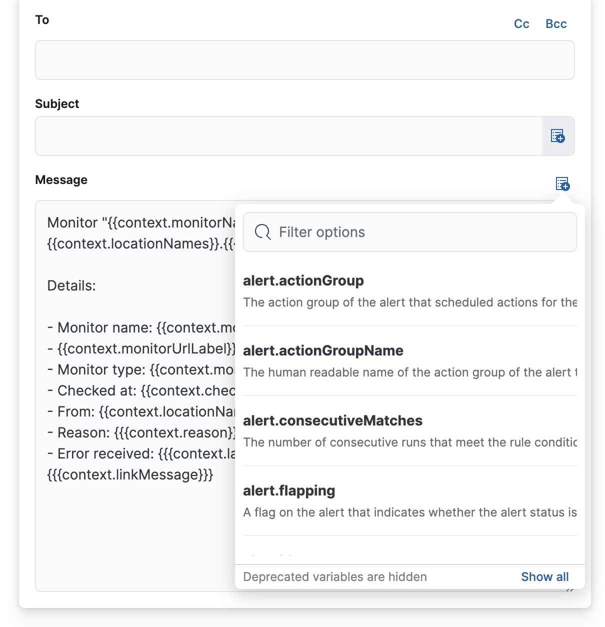

Use the default notification message or customize it. You can add more context to the message by clicking the icon above the message text box and selecting from a list of available variables.
When Alert on no data is enabled and an alert fires for a pending monitor (no data received), the alert document includes monitor and location details (such as monitor name, ID, type, location, tags, URL, and error when applicable). These are available through the same context variables listed below; context.reason for a pending alert uses the format: Monitor "X" from Location Y is pending.
synthetic monitor action variables
The following variables are specific to this rule type. You can also specify variables common to all rules.

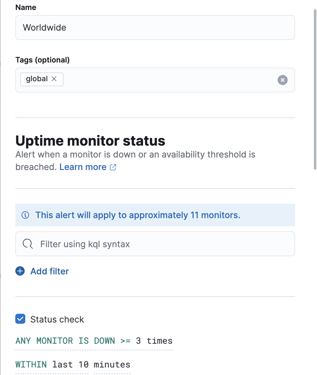

Within the Uptime app, create a Monitor Status rule to receive notifications based on errors and outages.
  1. To access this page, go to Observability → Uptime.
  2. At the top of the page, click Alerts and rules → Create rule.
  3. Select Monitor status rule.
Tip
If you already have a query in the overview page search bar, it’s populated here.
You can specify the following thresholds for your rule.
Status check Receive alerts when a monitor goes down a specified number oftimes within a time range (seconds, minutes, hours, or days).
Availability Receive alerts when a monitor goes below a specified availabilitythreshold within a time range (days, weeks, months, or years).
Let’s create a rule for any monitor that shows Down more than three times in 10 minutes.
This rule covers all the monitors you have running. You can use a query to specify specific monitors, and you can also have different conditions for each one.
Monitor status rule
The final step when creating a rule is to select one or more actions to take when the alert is triggered.
You can extend your rules by connecting them to actions that use the following supported built-in integrations. Actions are Kibana services or integrations with third-party systems that run as background tasks on the Kibana server when rule conditions are met.
You can configure action types on the Settings page.
Uptime rule connectors
Action frequency summary of alerts
Alternatively, you can set the action frequency such that you choose how often the action runs (for example, at each check interval, only when the alert status changes, or at a custom action interval). In this case, you must also select the specific threshold condition that affects when actions run: Uptime Down Monitor or Recovered.
Action frequency for each alert

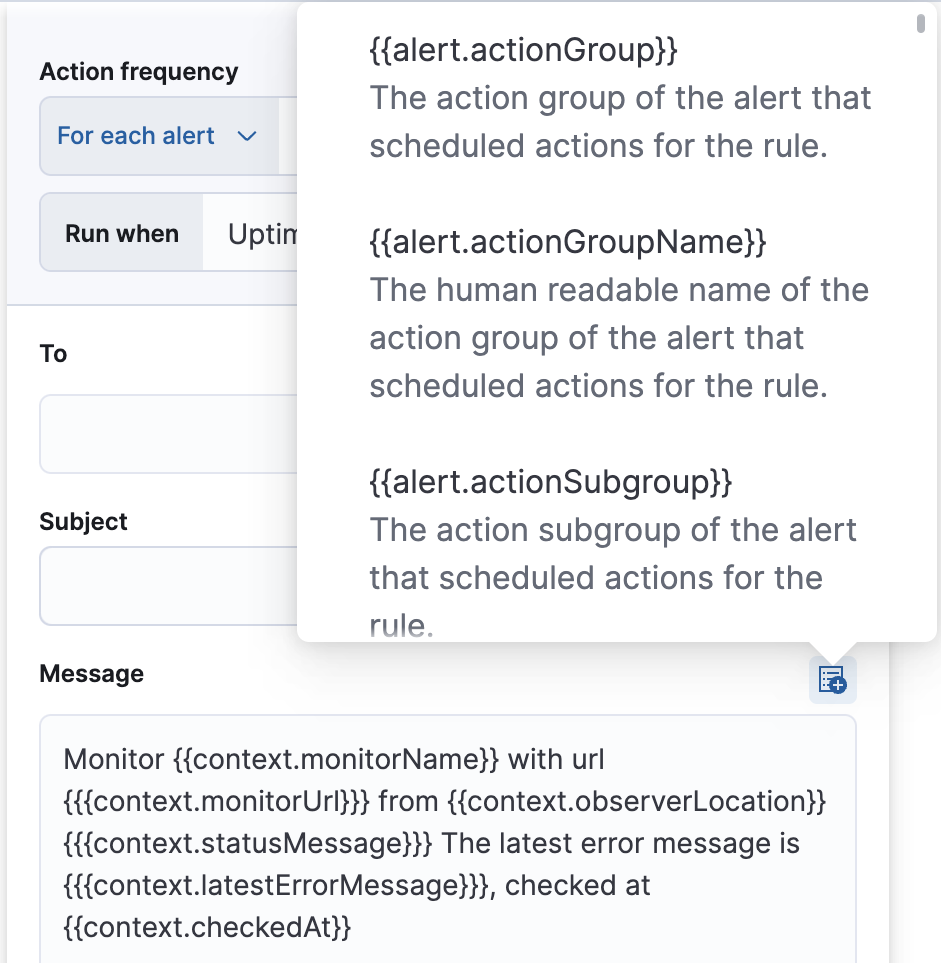

Default notification message for monitor status rules with open "Add variable" popup listing available action variables

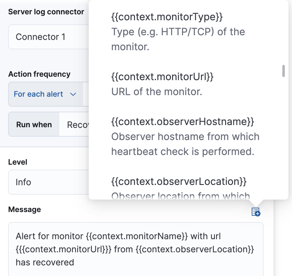

To receive a notification when the alert recovers, select Run when Recovered. Use the default notification message or customize it. You can add more context to the message by clicking the icon above the message text box and selecting from a list of available variables.
Default recovery message for monitor status rules with open "Add variable" popup listing available action variables
