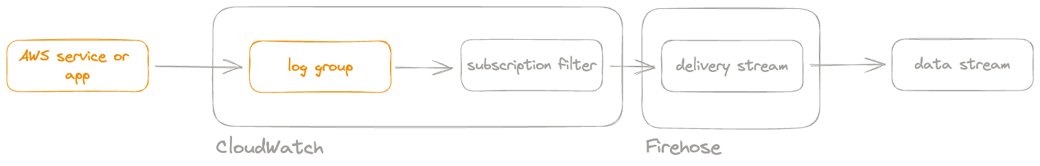

In this tutorial, you are going to collect application logs from an AWS Lambda-based app and forward them to Elastic.
Create a Lambda function
You can skip this section if you already have a Lambda function, or any other service or application that sends logs to a CloudWatch log group. Take note of the log group from which you want to collect log events and move to the next section.
Like many other services and platforms in AWS, Lambda functions natively log directly to CloudWatch out of the box.

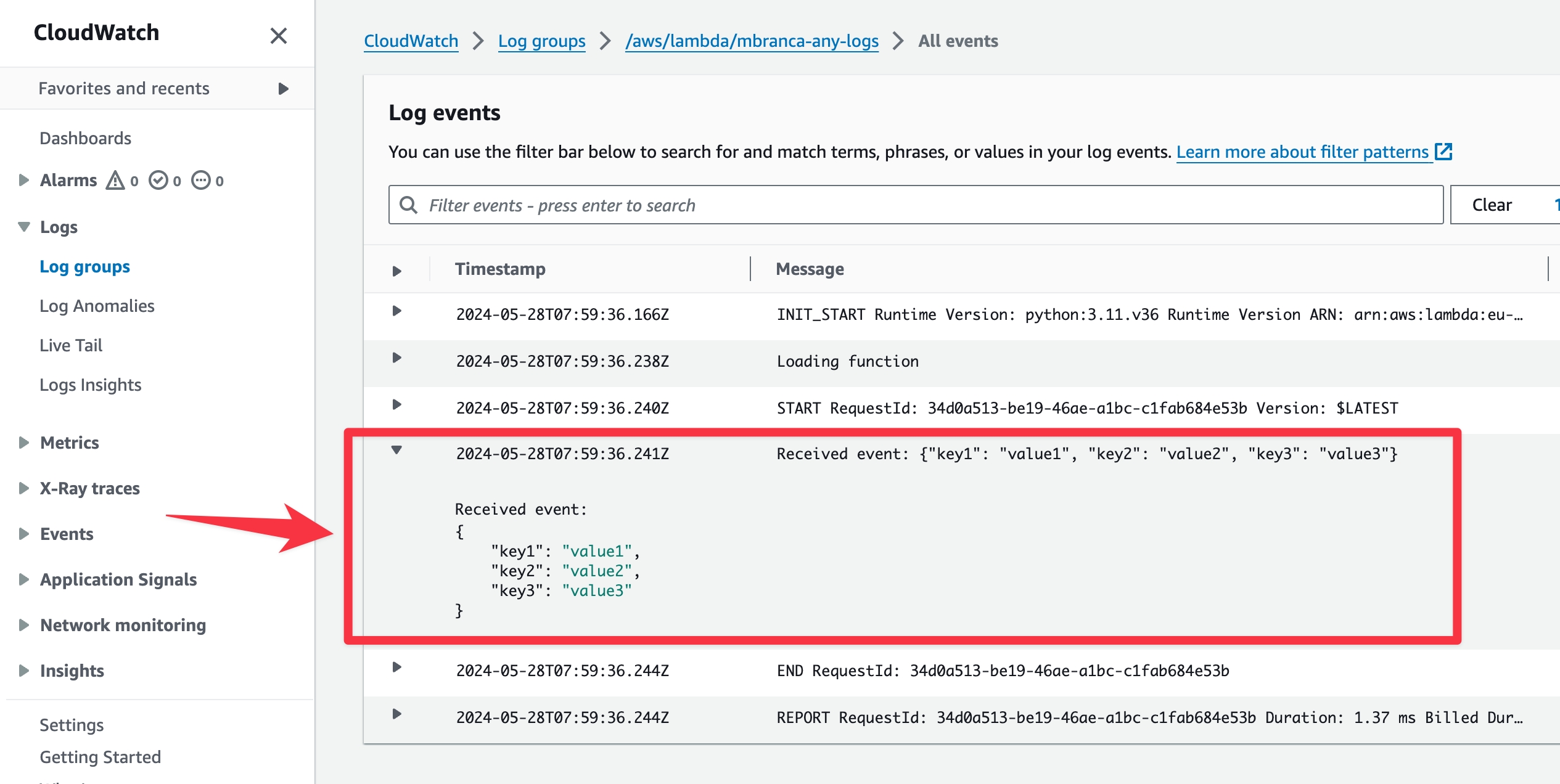

Visit the function’s log group. Usually, the AWS console offers a handy link to jump straight to the log group it created for this function’s logs. You should get something similar to the following:
Take note of the log group name for this Lambda function, as you will need it in the next steps.

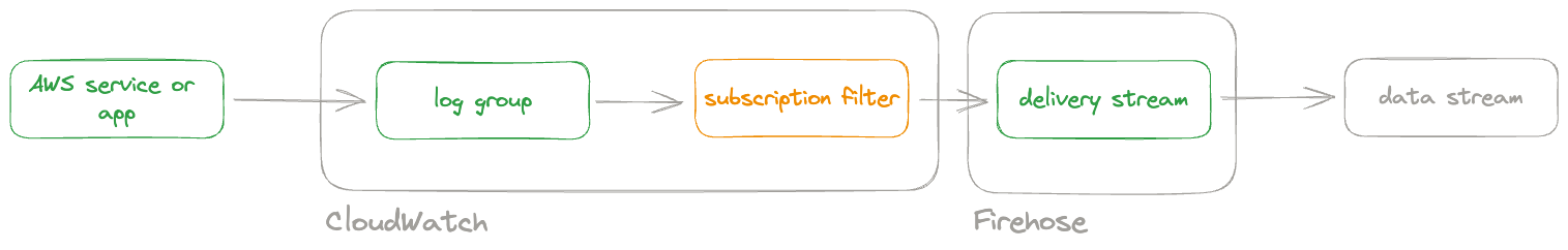

To send log events from CloudWatch to Firehose, open the log group where the Lambda service is logging and create a subscription filter.
Create a subscription filter for Amazon Data Firehose
The subscription filter allows you to pick log events from the log group and forward them to other services, such as an Amazon Kinesis stream, an Amazon Data Firehose stream, or AWS Lambda.

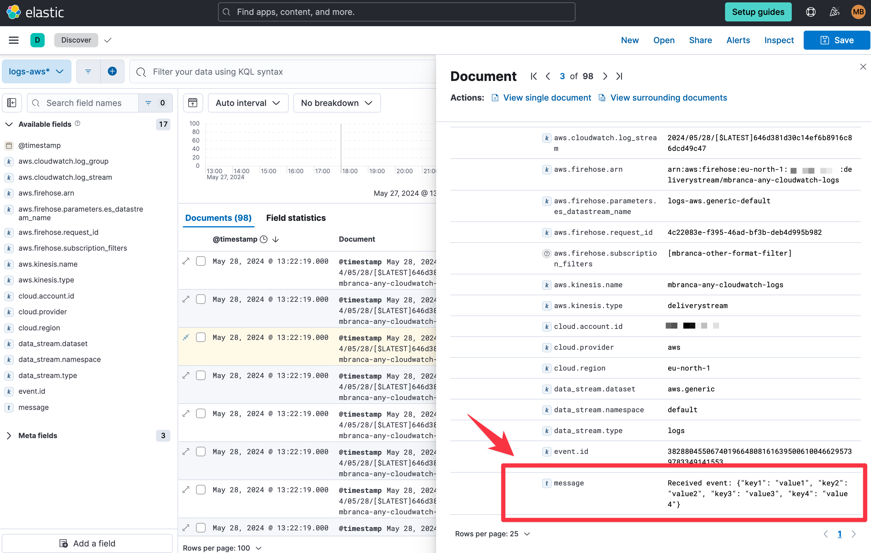

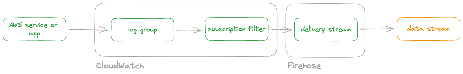

With the logs streaming to the Elastic stack, you can now visualize them in Kibana.
In Kibana, open Discover. In ES|QL mode, enter FROM logs-aws.generic-default. In classic mode, select the data view that matches the Firehose stream name. Here is a sample of logs from the Lambda function you forwarded to the logs-aws.generic-default data stream:
