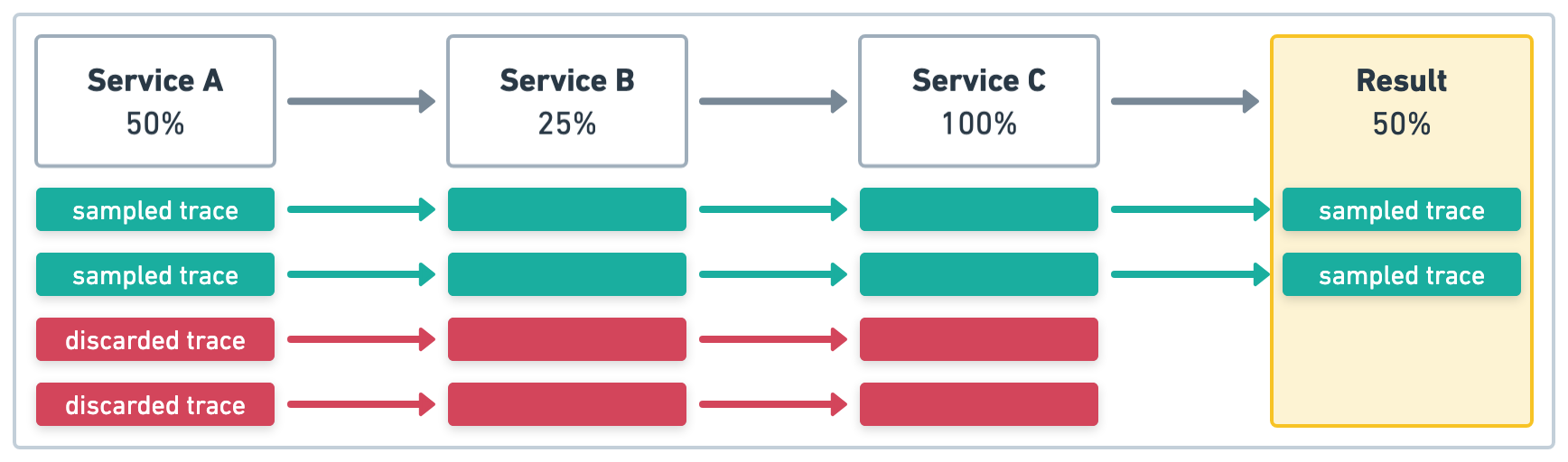

In the example in Figure 2, Service A initiates four transactions and has a sample rate of 1 (100%). Again, the upstream sampling decision is respected, so the sample rate for all services will be 1 (100%).
Figure 2. Upstream sampling decision is respected
Distributed tracing and head based sampling example two

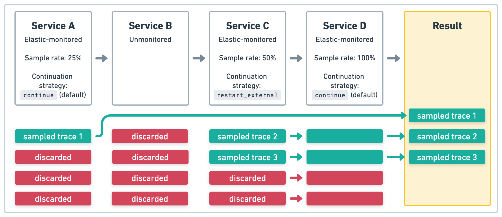

Use the restart_external trace continuation strategy on an Elastic-monitored service to start a new trace if the previous service did not have a traceparent header with es vendor data. This can be helpful if a transaction includes an Elastic-monitored service that is receiving requests from an unmonitored service.
In the example in Figure 3, Service A is an Elastic-monitored service that initiates four transactions with a sample rate of .25 (25%). Because Service B is unmonitored, the traces started in Service A will end there. Service C is an Elastic-monitored service that initiates four transactions that start new traces with a new sample rate of .5 (50%). Because Service D is also Elastic-monitored service, the upstream sampling decision defined in Service C is respected. The end result will be three sampled traces.
Figure 3. Using the restart_external trace continuation strategy
Distributed tracing and head based sampling with restart_external continuation strategy

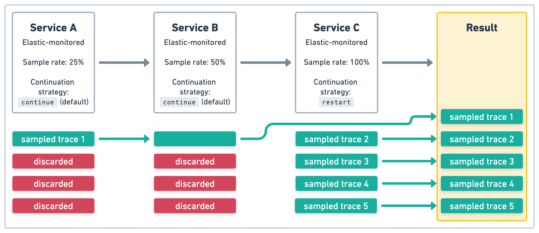

In the example in Figure 4, Service A and Service B are Elastic-monitored services that use the default trace continuation strategy. Service A has a sample rate of .25 (25%), and that sampling decision is respected in Service B. Service C is an Elastic-monitored service that uses the restart trace continuation strategy and has a sample rate of 1 (100%). Because it uses restart, the upstream sample rate is not respected in Service C and all four traces will be sampled as new traces in Service C. The end result will be five sampled traces.
Distributed tracing and head based sampling with restart continuation strategy

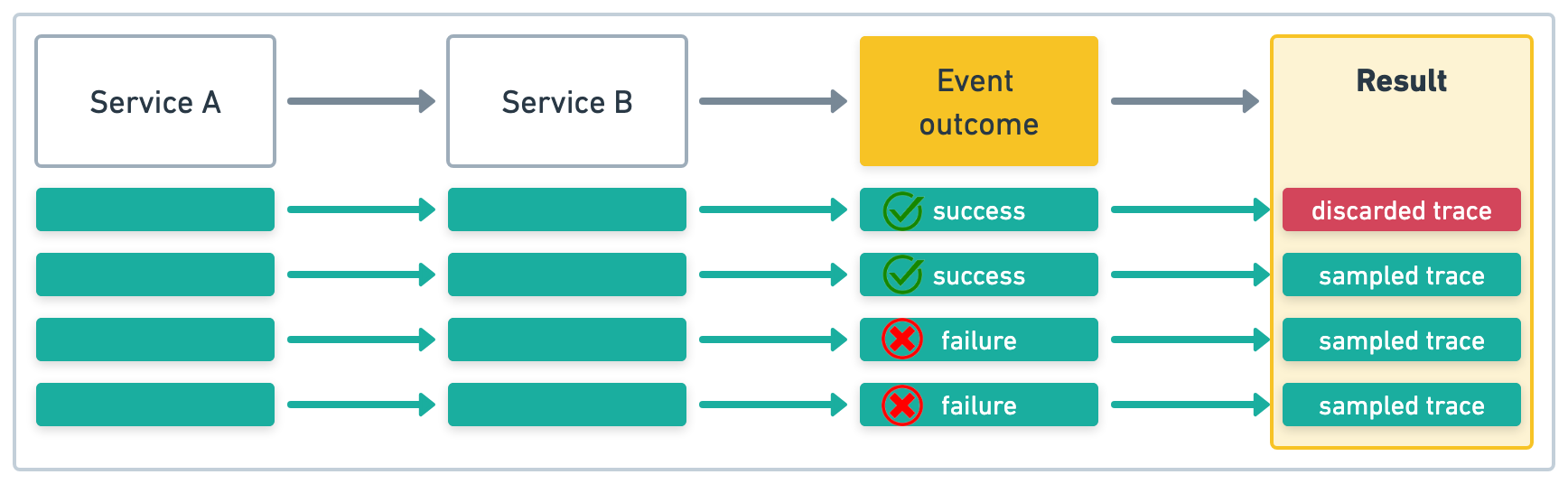

With tail-based sampling, all traces are observed and a sampling decision is only made once a trace completes.
In this example, Service A initiates four transactions. If our sample rate is .5 (50%) for traces with a success outcome, and 1 (100%) for traces with a failure outcome, the sampled traces would look something like this:
Distributed tracing and tail based sampling example one
