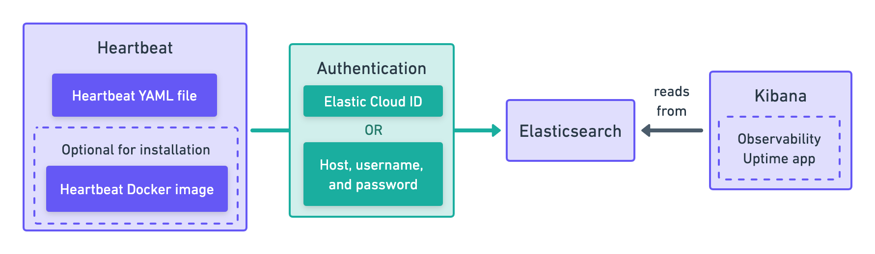

Heartbeat is a lightweight daemon that you install on a remote server to periodically check the status of your services and determine if they are available. It gathers performance data, formats it, and sends the data to the Elastic Stack.
Diagram showing which pieces of software are used to configure monitors

Elastic provides Docker images that you can use to run monitors. Start by pulling the Heartbeat Docker image.
docker pull docker.elastic.co/beats/heartbeat:9.2.1
Next, create a heartbeat.yml configuration file.
The example below shows how to configure an http monitor, one of three types of lightweight monitors.

After configuring the monitor, run it in Docker and connect the monitor to the Elastic Stack.
You'll need to retrieve your Elasticsearch credentials for either an Elastic Cloud ID or another Elasticsearch Cluster.
The example below, shows how to run synthetics tests indexing data into Elasticsearch. You'll need to insert your actual cloud.id and cloud.auth values to successfully index data to your cluster.
