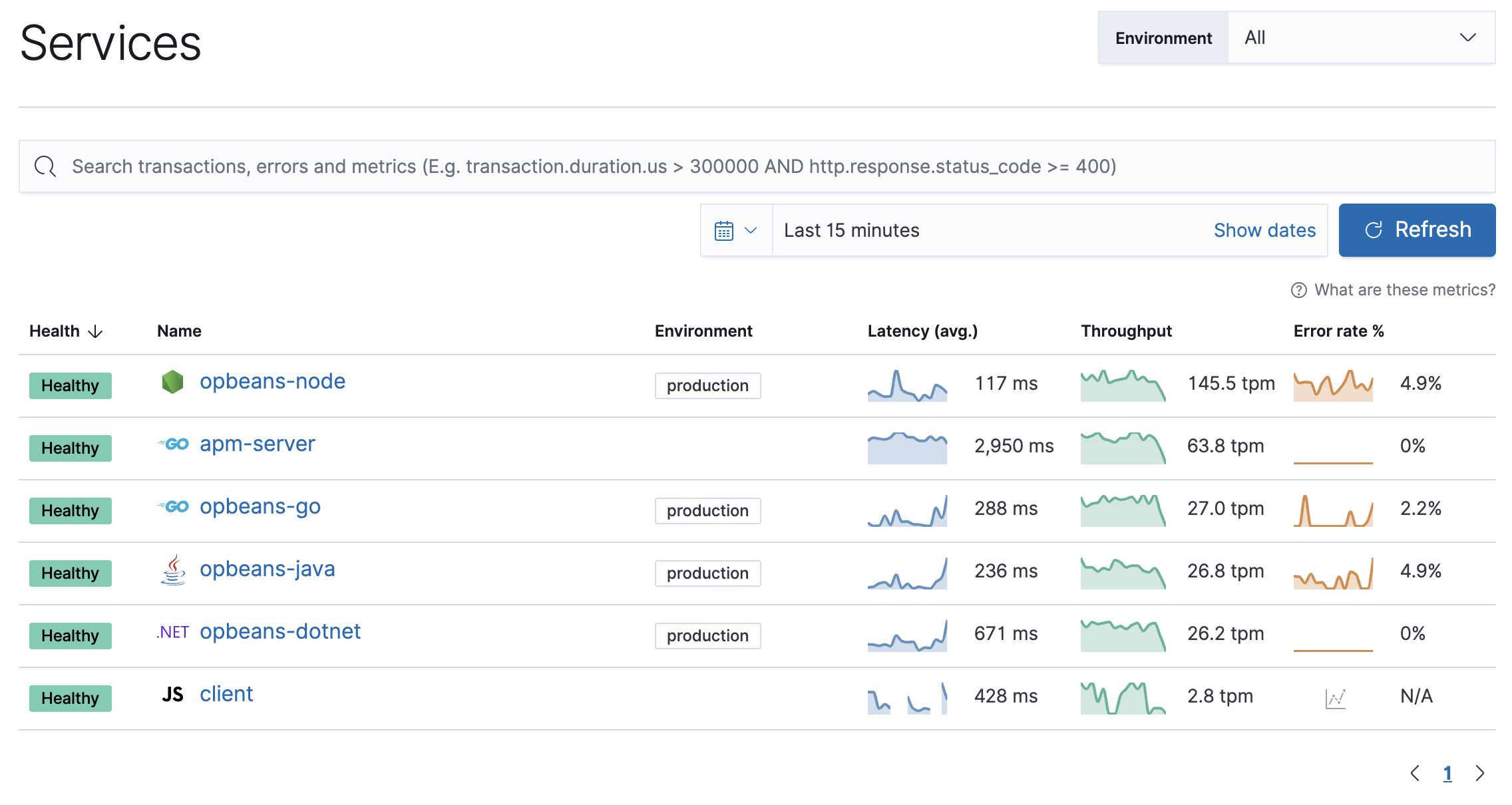

Once you have at least one APM agent sending data to APM Server, you can start visualizing your data in the Kibana Applications UI.
Applications UI with data
