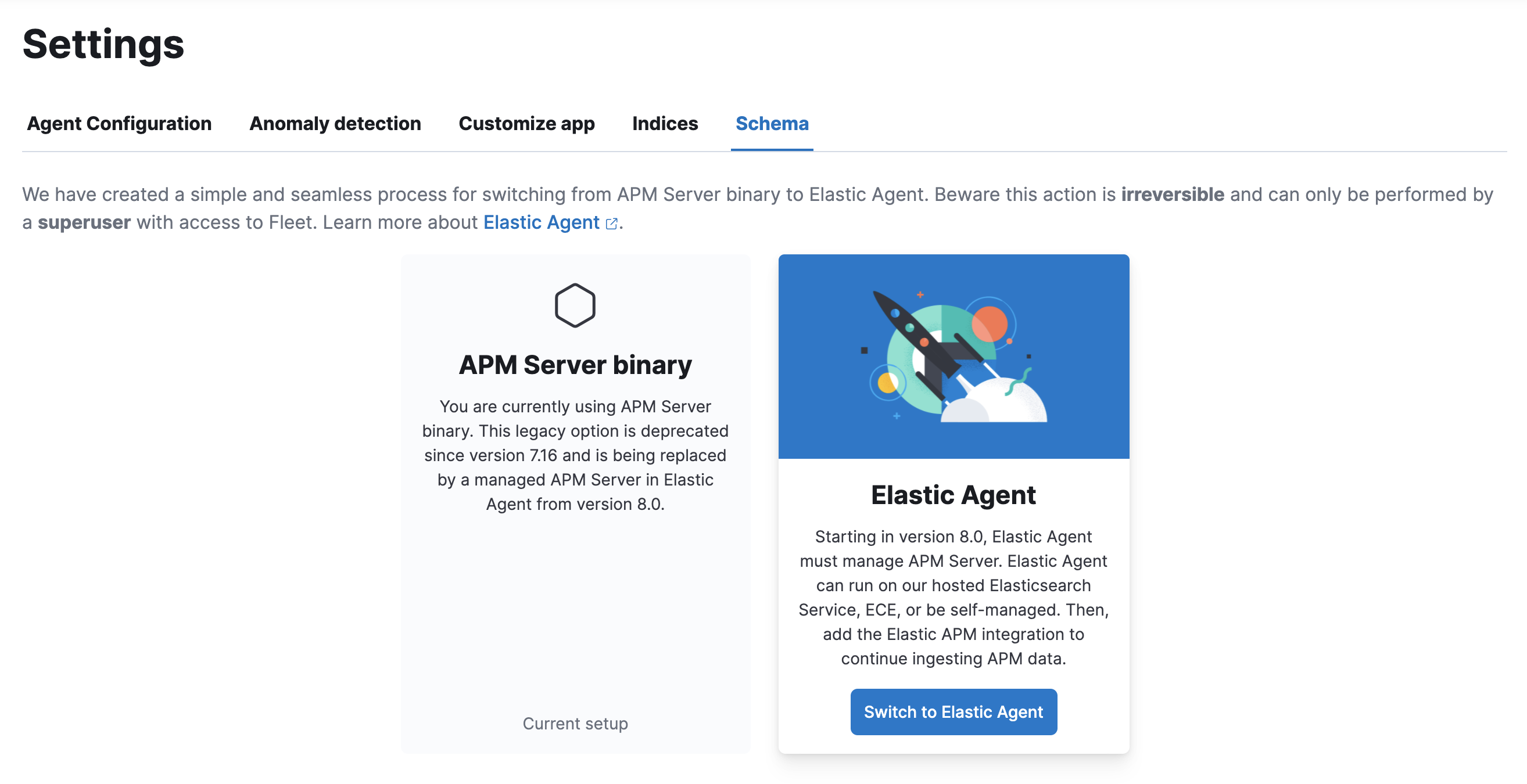

  1. In the main menu, go to Applications -> Service Inventory or find Service Inventory using the global search field, and then select Settings → Schema.
    switch to Elastic Agent

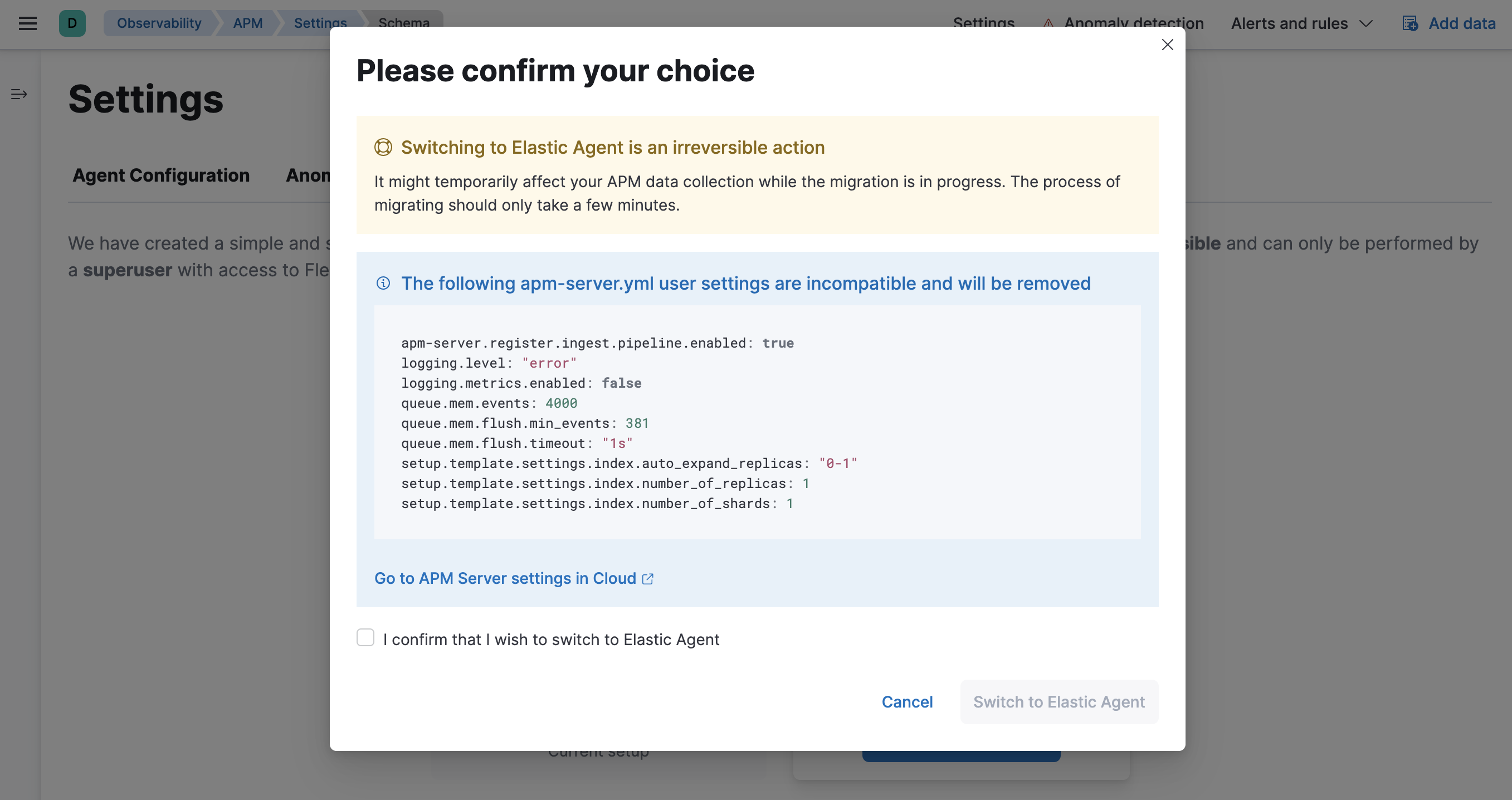

  2. Click Switch to Elastic Agent. Make a note of the apm-server.yml user settings that are incompatible with Elastic Agent. Check the confirmation box and click Switch to Elastic Agent.
    Elastic Agent settings migration
Elastic Cloud will now create a Fleet Server instance to contain the new APM integration, and then will shut down the old APM server instance. Within minutes your data should begin appearing in the Applications UI again.
You can now update settings that were removed during the upgrade. See Configure APM Server for a reference of all available settings.

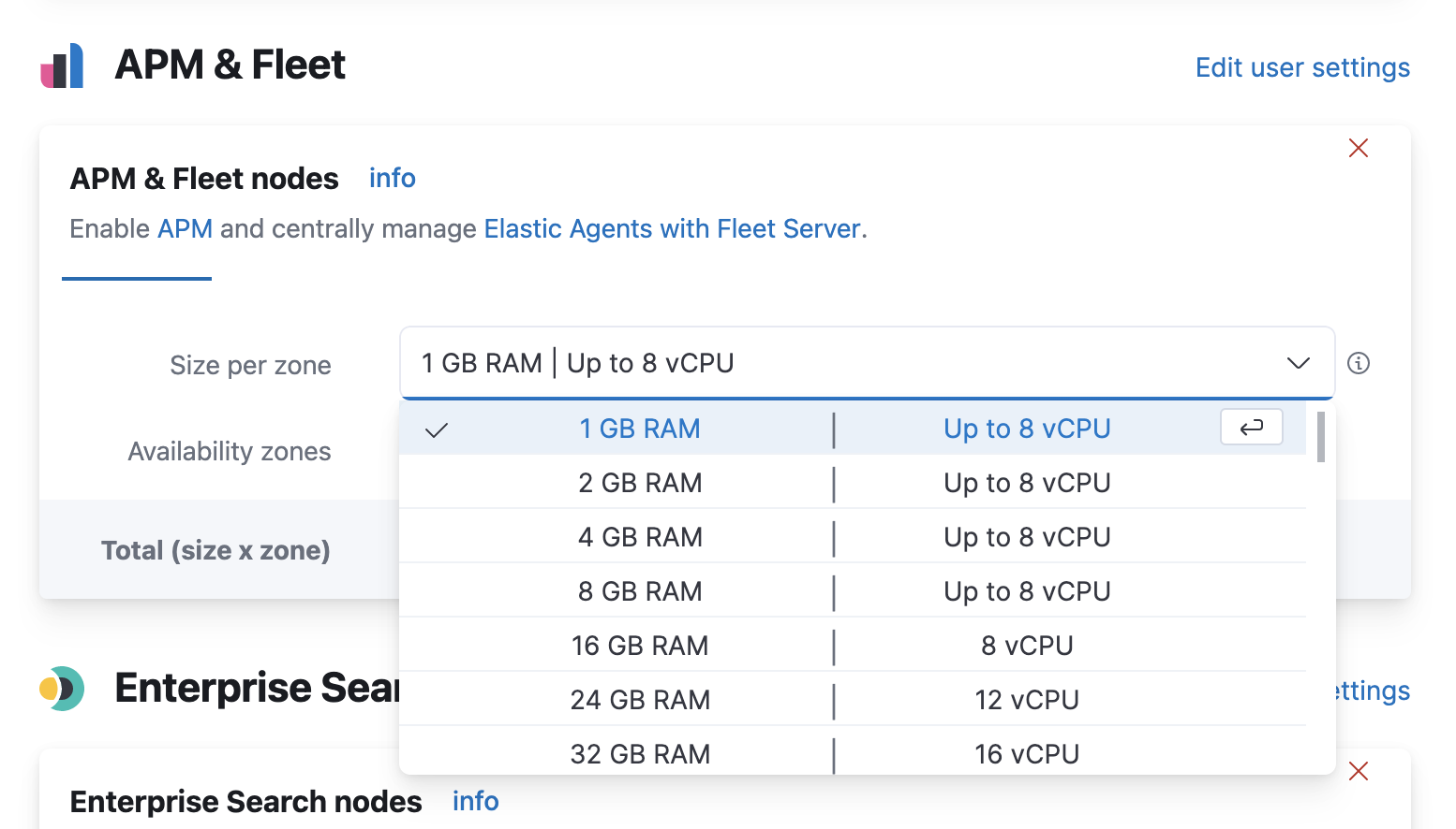

Certain Elasticsearch output configuration options are not available with the APM integration. To ensure data is not lost, you can scale APM and Fleet up and out. APM’s capacity to process events increases with the instance memory size.
Go to the Elastic Cloud Console, select your deployment and click Edit. Here you can edit the number and size of each availability zone.
scale APM
