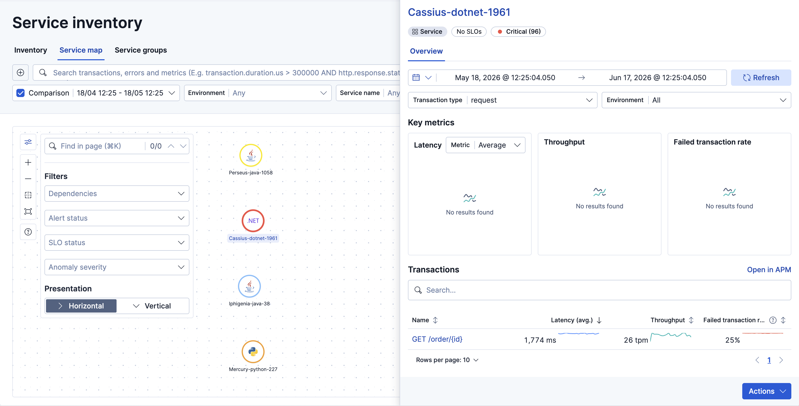

If there’s a specific service that interests you, select that service to highlight its connections. Click Focus map to refocus the map on the selected service and lock the connection highlighting. Click the Transactions tab to jump to the Transaction overview for the selected service. You can also use the tabs at the top of the page to easily jump to the Errors or Metrics overview.

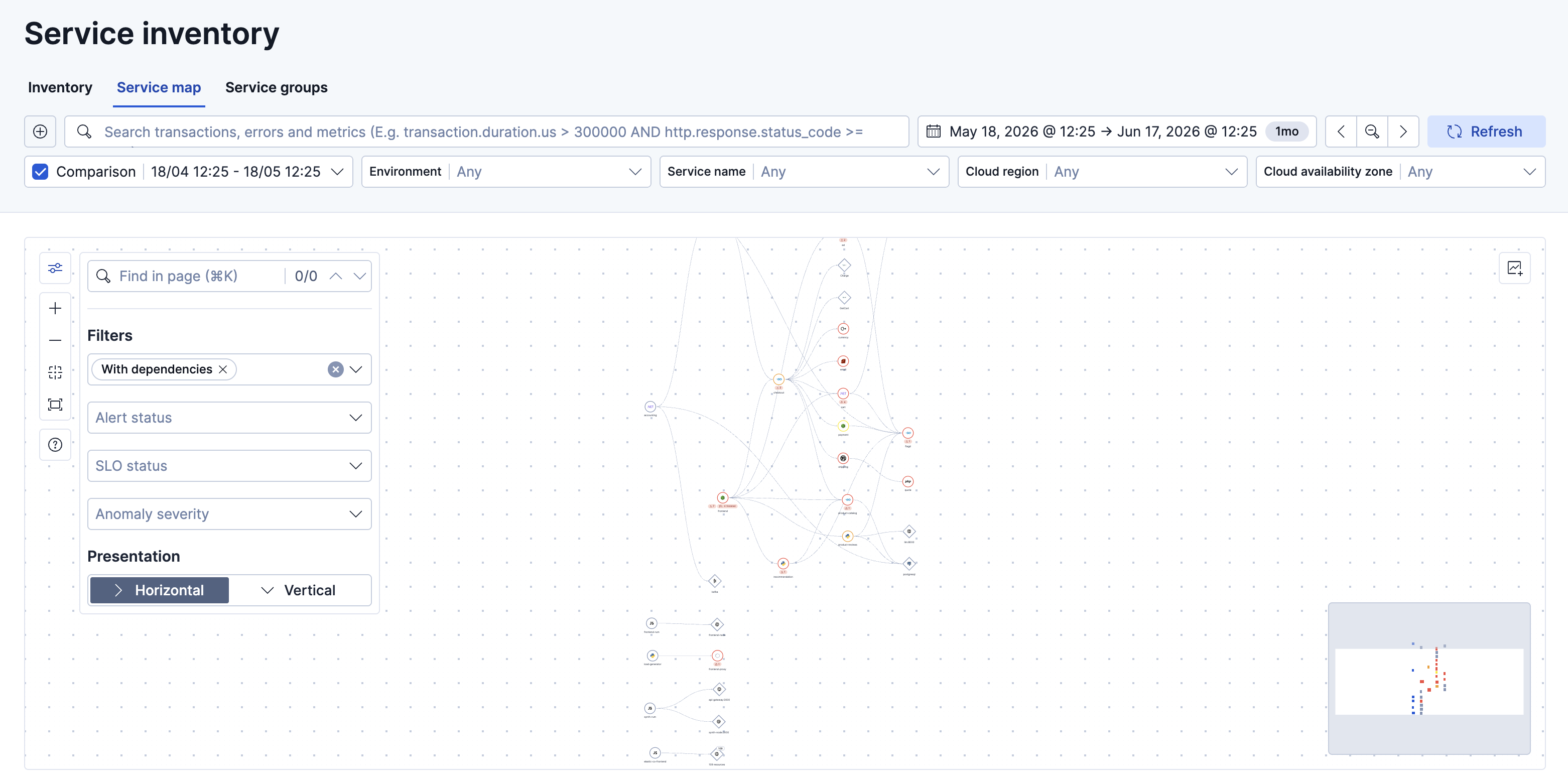

Use the map controls to adjust the layout, filter what’s displayed, and navigate large maps:
  • Presentation: Switch between Horizontal and Vertical layout to best fit your architecture.
  • Find in page: Search for a specific service by name to locate and highlight it on the map.
  • Filters: Use the Dependencies, Alert status, SLO status, and Anomaly severity drop-downs to focus the map on specific services.
To save the current service map view to a Kibana dashboard, click the Copy to dashboard icon located in the upper-right corner of the map.

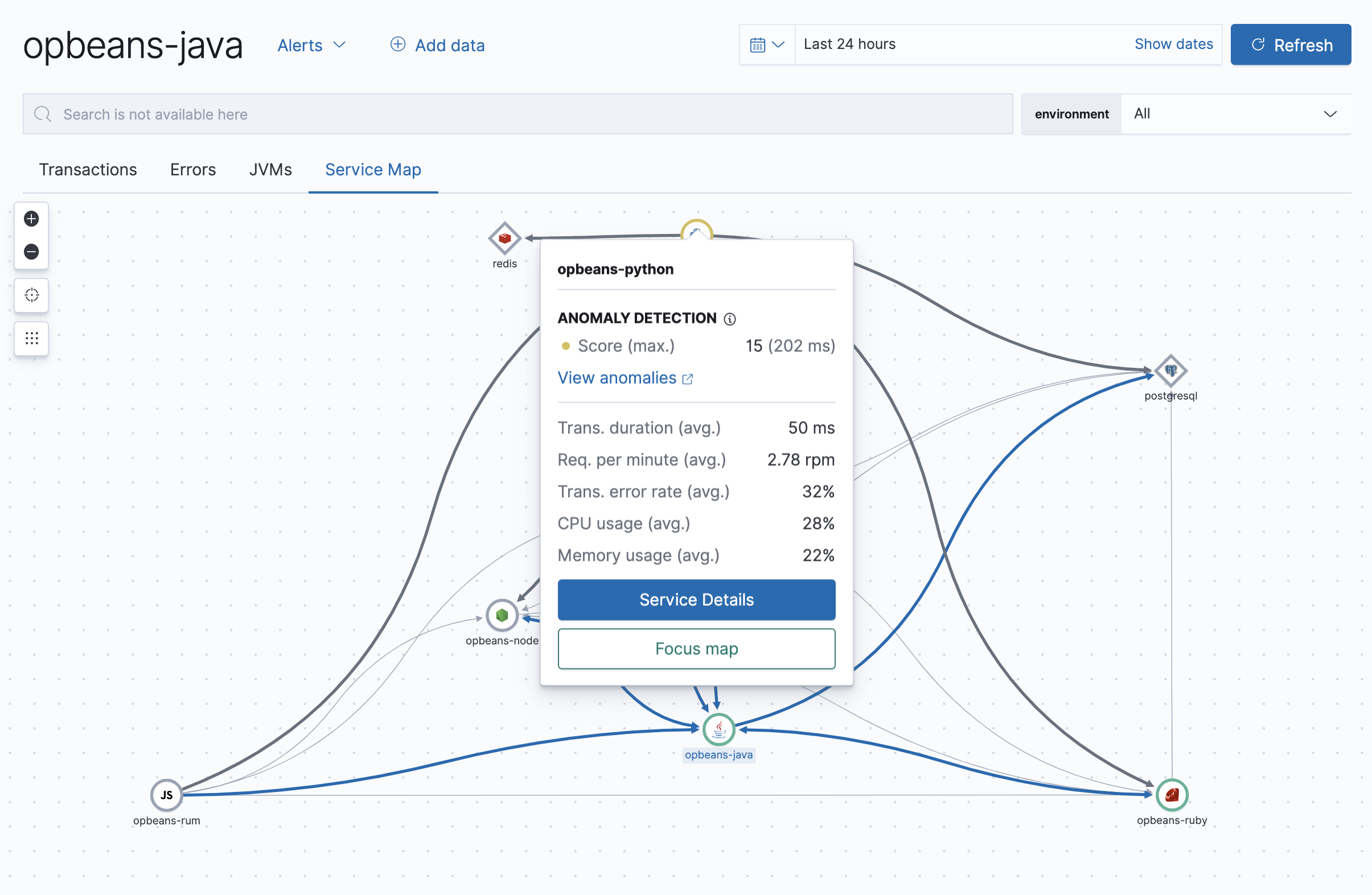

When you click an instrumented service node (circle shape), a service flyout panel opens with a summary of the service’s RED metrics and infrastructure usage. Use the footer menu to open traces, logs, alerts, or SLOs for the service without leaving the map. Dependency nodes (diamond shape) and connections still use a compact popover.
Service flyout panel open alongside the service map, showing RED metrics and a transactions list for the selected service
A minimap in the corner of the map lets you see where you are in a large architecture and quickly navigate to a different area.
Service map showing the controls panel with filters and presentation toggle, the map canvas with circle and diamond nodes, and the minimap in the bottom-right corner
You can create machine learning jobs to calculate anomaly scores on APM transaction durations within the selected service. When these jobs are active, service maps display a color-coded anomaly indicator on each service node based on the detected anomaly score.
For a description of what each color means, refer to Anomaly score colors.

Example view of anomaly scores on service maps in the Applications UI
If an anomaly has been detected, click View anomalies to view the anomaly detection metric viewer. This time series analysis displays additional details on the severity and time of the detected anomalies.
