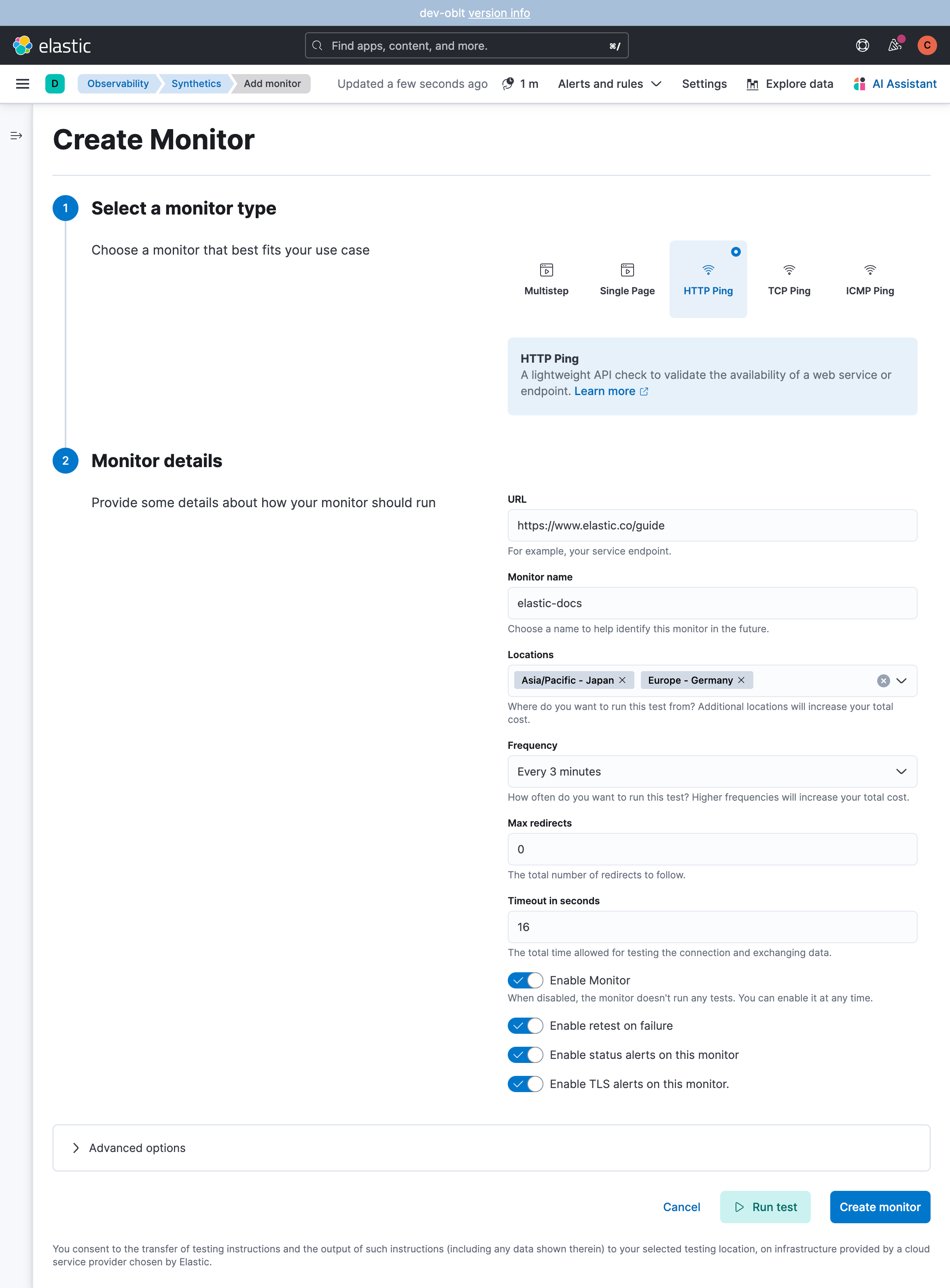

Lightweight monitors can be configured using either the Synthetics UI or Project monitors.
To use the UI, go to the Synthetics UI in Kibana or in your Observability Serverless project to create and configure monitors. For step-by-step instructions, refer to Use the Synthetics UI.
To use YAML files to create lightweight monitors in a Synthetics project, set up the Synthetics project and configure monitors in YAML files in the lightweight directory.
