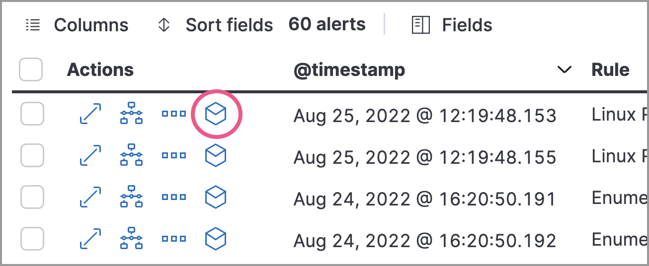

  1. First, display a list of events by doing one of the following:
    • Find Hosts in the main menu, or search for Security/Explore/Hosts by using the global search field, then select the Events tab. A list of all your hosts' events appears at the bottom of the page.
    • Find Alerts in the main menu or by using the global search field, then scroll down to the Alerts table.
  2. Filter events that can be visually analyzed by entering either of the following queries in the KQL search bar, then selecting Enter:
    • agent.type:"endpoint" and process.entity_id :*
      Or
    • agent.type:"winlogbeat" and event.module: "sysmon" and process.entity_id : *
  3. Events that can be visually analyzed are denoted by a cubical Analyze event icon. Select this option to open the event in the visual analyzer. The event analyzer is accessible from the Hosts, Alerts, and Timelines pages, as well as the alert details flyout.
    analyze event button
    Note
    Events that cannot be analyzed will not have the Analyze event option available. This might occur if the event has incompatible field mappings.

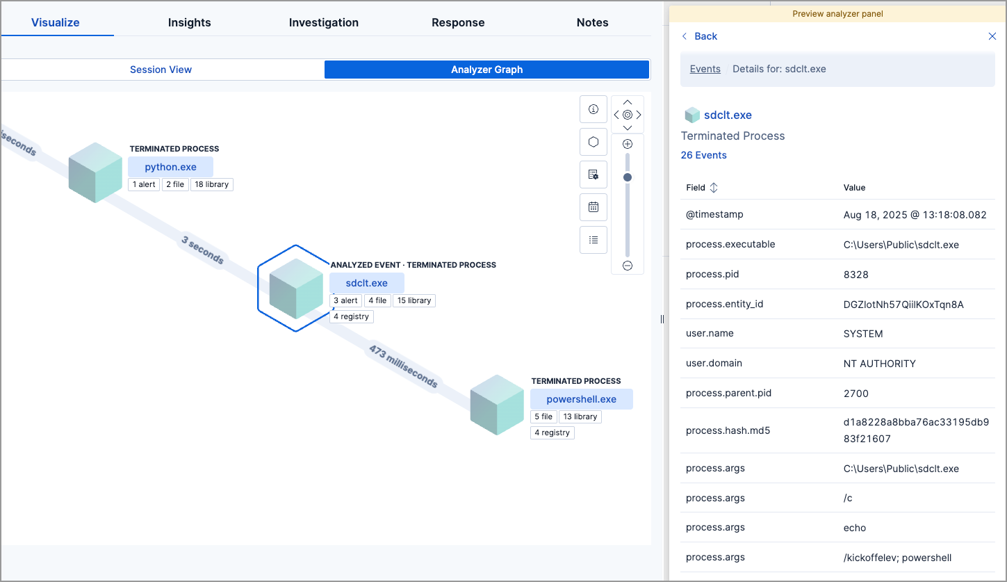

Within the visual analyzer, each cube represents a process, such as an executable file or network event. Click and drag in the analyzer to explore the hierarchy of all process relationships.
To understand what fields were used to create the process, select the Process Tree to show the schema that created the graphical view. The fields included are:
  • SOURCE: Can be either endpoint or winlogbeat
  • ID: Event field that uniquely identifies a node

The left panel contains a list of all processes related to the event, starting with the event chain’s first process. Analyzed Events — the event you selected to analyze from the events list or Timeline — are highlighted with a light blue outline around the cube.
process list
In the graphical view, you can:
  • Zoom in and out of the graphical view using the slider on the far right
  • Click and drag around the graphical view to more process relationships
  • Observe child process events that spawned from the parent process
  • Determine how much time passed between each process
  • Identify all events related to each process
graphical view
To learn more about each related process, select the process in the left panel or the graphical view. The left panel displays process details such as:
  • The number of events associated with the process
  • The timestamp of when the process was executed
  • The file path of the process within the host
  • The process-pid
  • The user name and domain that ran the process
  • Any other relevant process information
  • Any associated alerts
process details

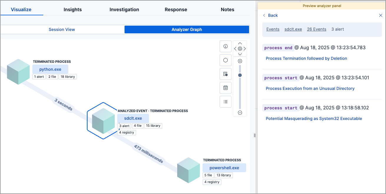

To examine alerts associated with the event, select the alert pill (x alert). The left pane lists the total number of associated alerts, and alerts are ordered from oldest to newest. Each alert shows the type of event that produced it (event.category), the event timestamp (@timestamp), and rule that generated the alert (kibana.alert.rule.name). Click on the rule name to open the alert’s details.
In the example screenshot below, five alerts were generated by the analyzed event (lsass.exe). The left pane displays the associated alerts and basic information about each one.
