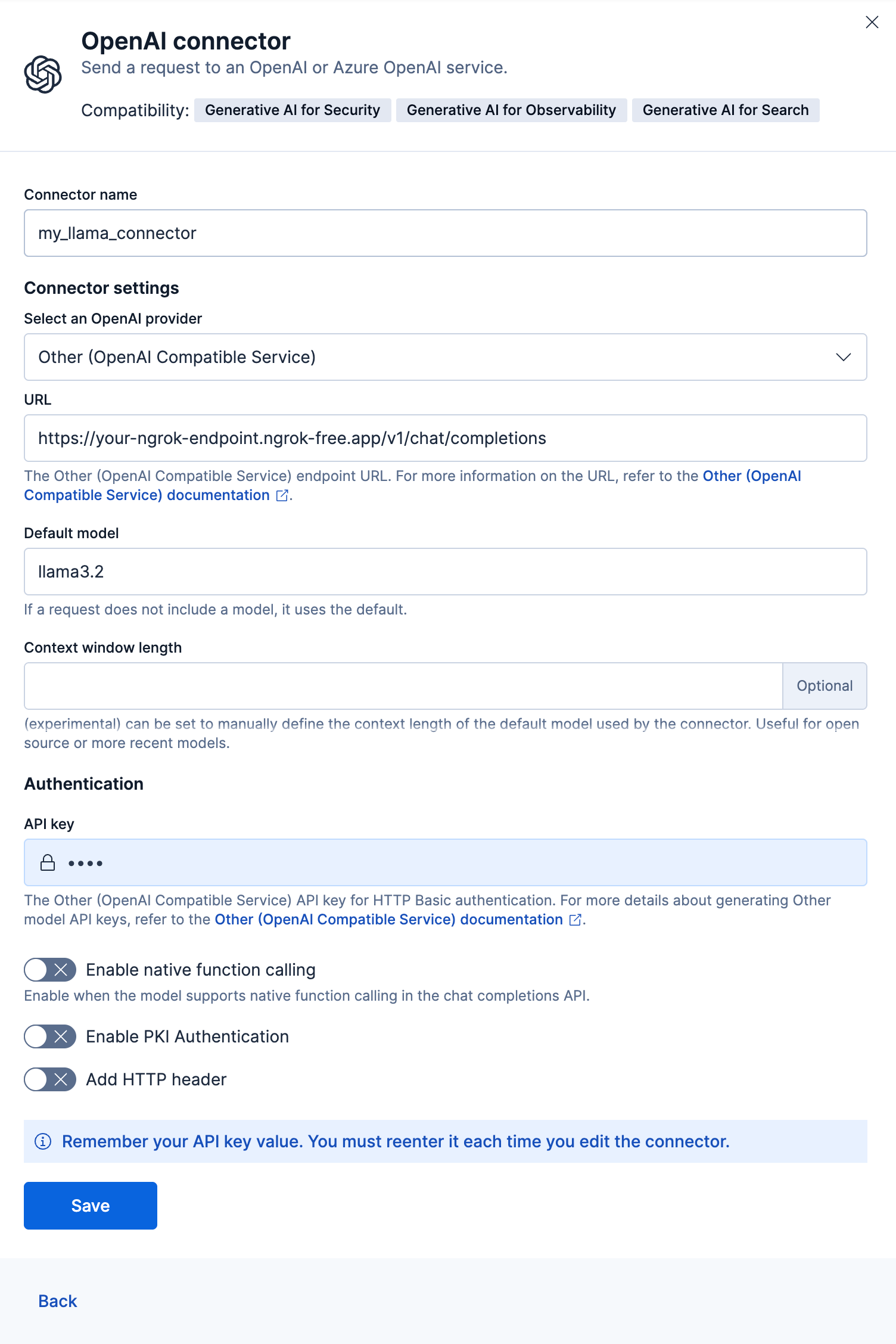

  1. In Kibana, go to Search > Playground, and click Connect to an LLM.
  2. Select OpenAI on the fly-out.
  3. Provide a name for the connector.
  4. Under Connector settings, select Other (OpenAI Compatible Service) as the OpenAI provider.
  5. Paste the ngrok-generated URL into the URL field and add the v1/chat/completions endpoint. For example: https://your-ngrok-endpoint.ngrok-free.app/v1/chat/completions
  6. Specify the default model, for example, llama3.2.
  7. Provide any random string for the API key (it will not be used for requests).
  8. Save. Configuring an LLM connector in Playground
  9. Click Add data sources and connect your index.
You can now use Playground with the LLM running locally.
