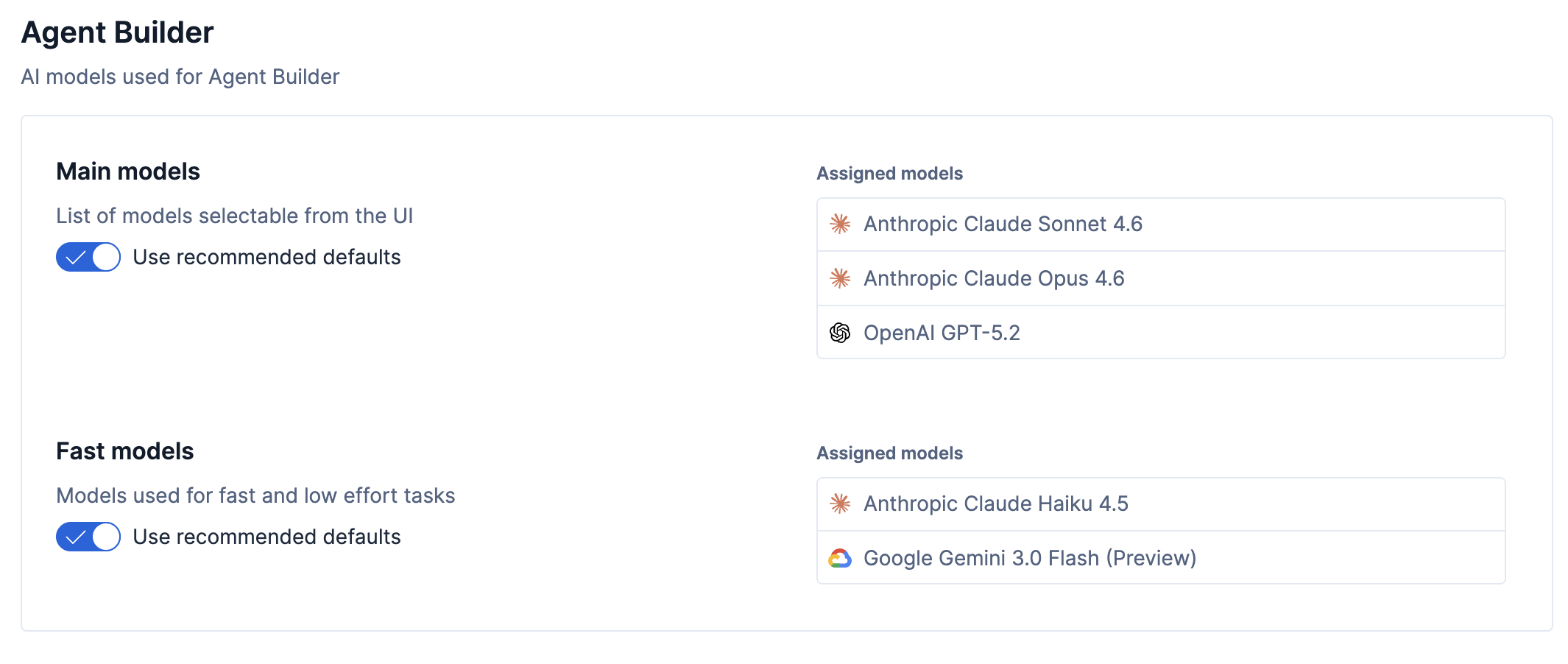

Elastic Agent Builder uses a recommended Elastic Managed LLM for fast routing. When more than one recommended fast model is available, such as Claude Haiku 4.5 and Google Gemini Flash, it uses the first one. To prefer a specific model, open the Feature settings page, go to the Agent Builder section, and order the models under Fast models so your preferred one is at the top. To find this page, refer to Change the default model.
In 9.5, only recommended Elastic Managed LLMs are used for fast routing. Assigning a custom or non-recommended model has no effect on the fast model.
Main models and Fast models cards in the Agent Builder section of the Feature settings page

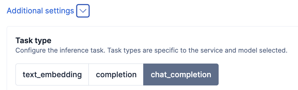

To use additional models that aren't preconfigured, create a connector for your model provider.
  1. Find connectors under Alerts and Insights / Connectors in the global search bar.
  2. Select Create Connector and select your model provider.
  3. Configure the connector with your API credentials and preferred model.
  4. Expand Additional settings and select chat_completion as the task type.
    Additional settings expanded showing chat_completion task type selected
