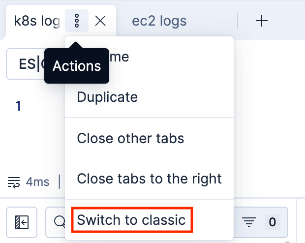

    • Switch to ES|QL in the contextual menu ( ) of the active Discover tab. This affects only that tab.

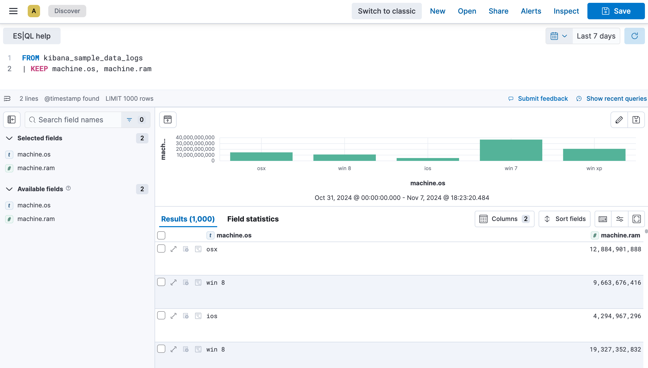

    Let’s say we want to find out what operating system users have and how much RAM is on their machine.
  3. Set the time range to Last 7 days.
  4. Copy the following query. To make queries more readable, you can put each processing command on a new line.
    FROM kibana_sample_data_logs
    | KEEP machine.os, machine.ram
    1. We're specifically looking for data from the sample web logs we installed.
    2. We’re only keeping the machine.os and machine.ram fields in the results table.
    Note
    ES|QL keywords are not case sensitive.
  5. Select Search (or ▶Run in earlier versions).

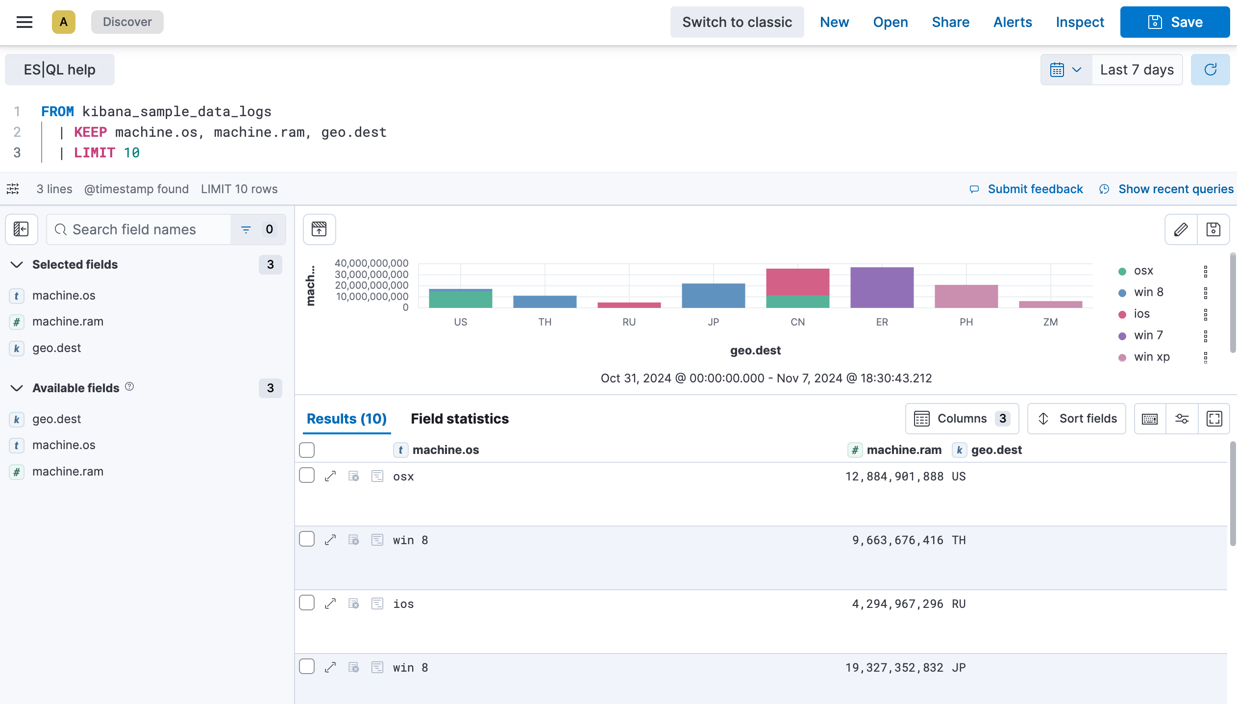

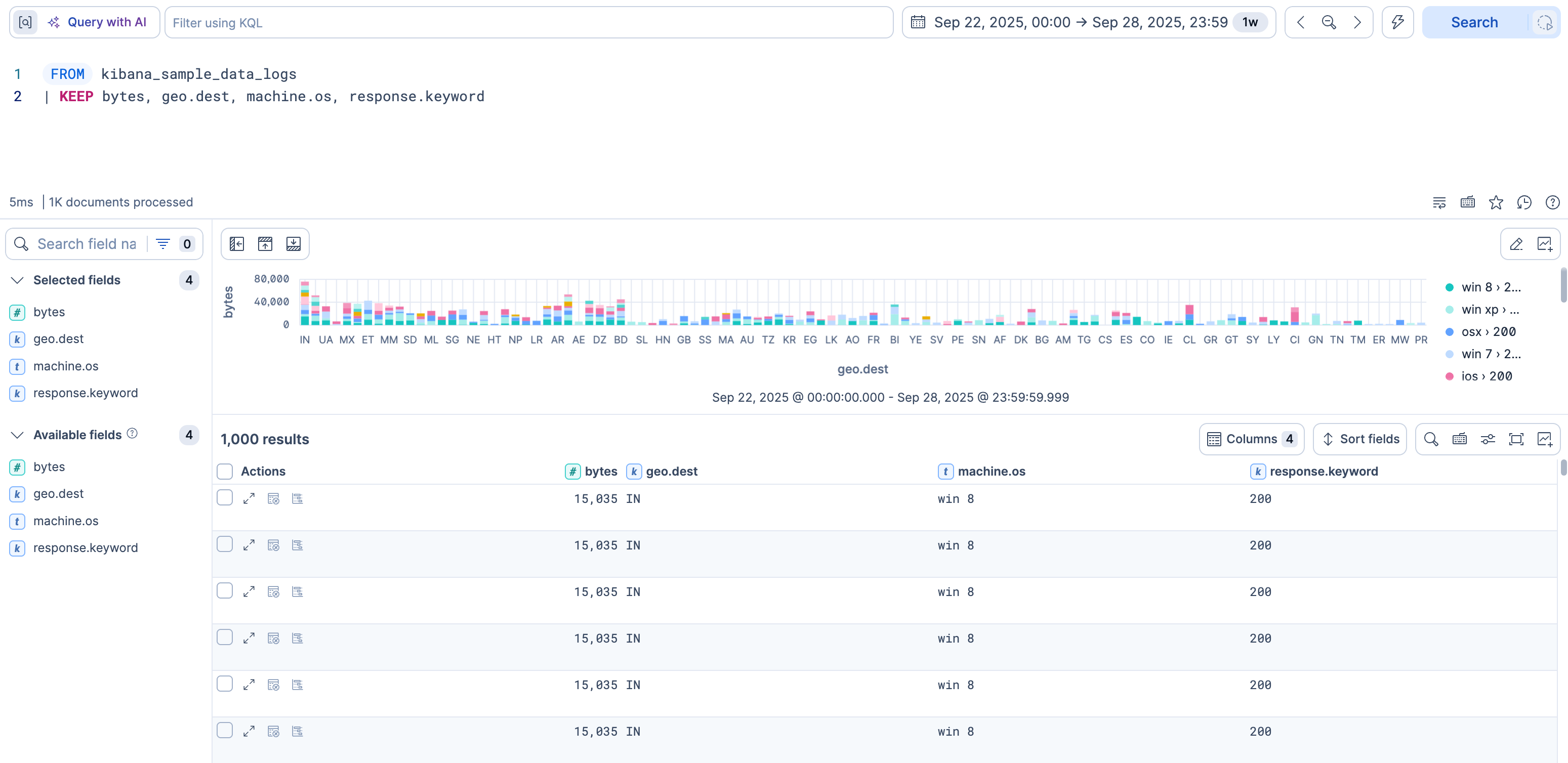

Let’s add geo.dest to our query to find out the geographical destination of the visits and limit the results.
  1. Copy the query below:
    | KEEP machine.os, machine.ram, geo.dest
    | LIMIT 10
  2. Select Search (or ▶Run in earlier versions) again. You can notice that the table is now limited to 10 results. The visualization also updated automatically based on the query, and broke down the data for you.
    Note
    When you don’t specify any specific fields to retain using KEEP, the visualization isn’t broken down automatically. Instead, an additional option appears above the visualization and lets you select a field manually.

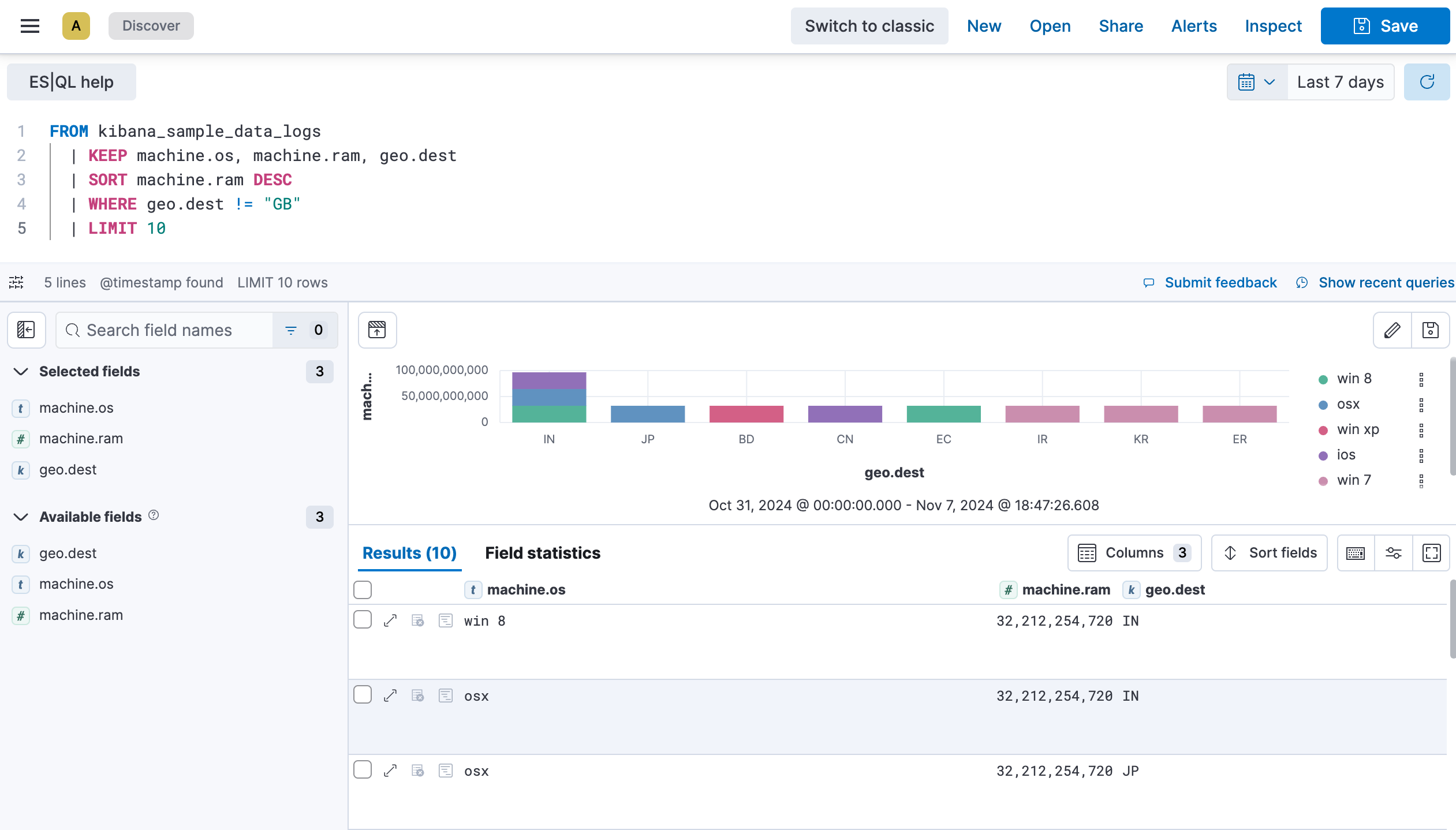

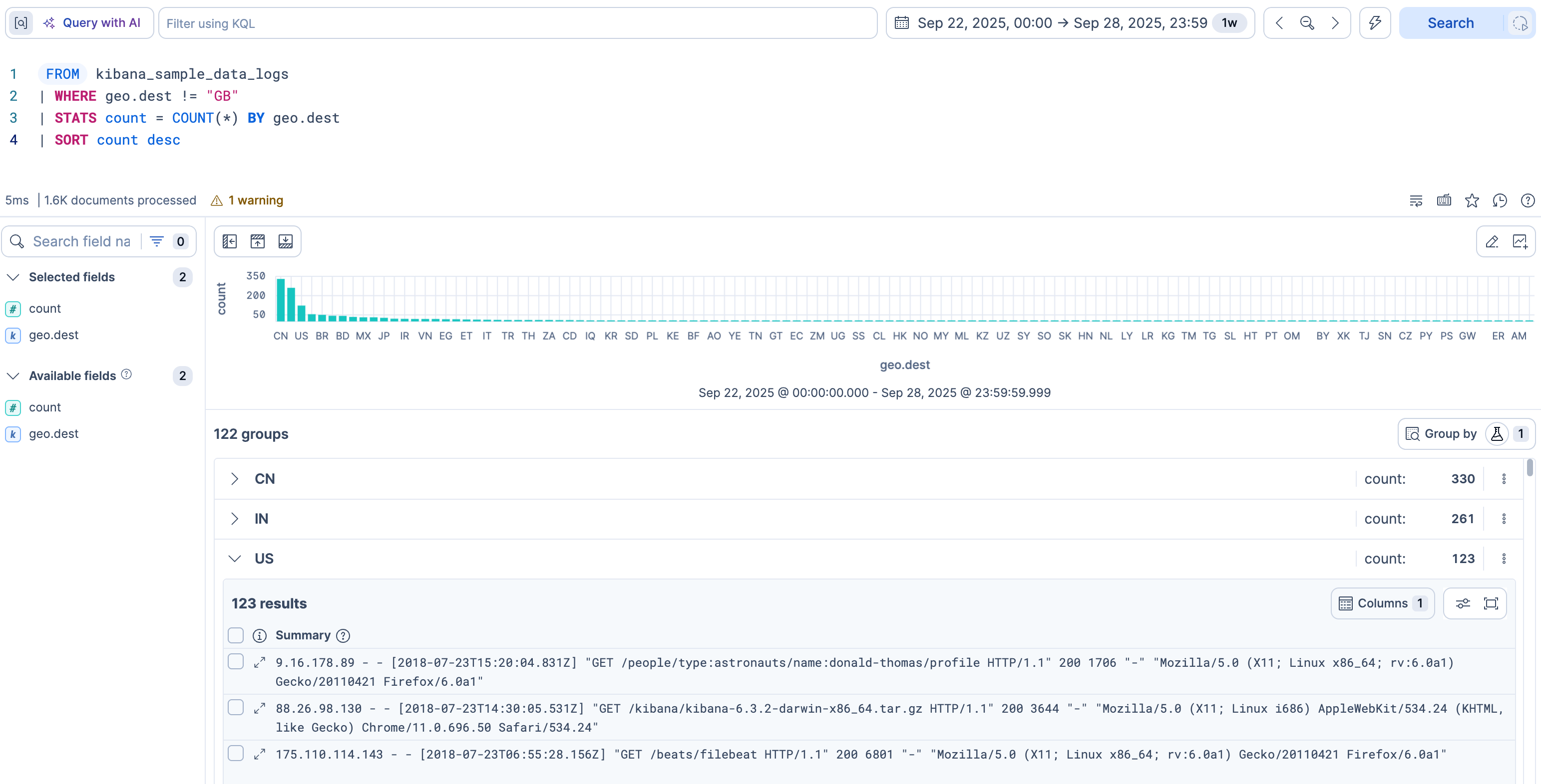

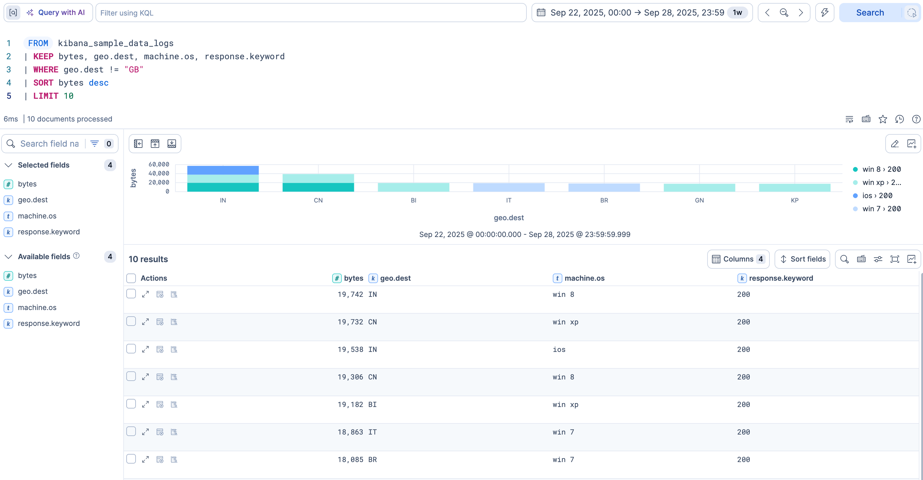

We will now take it a step further to sort the data by machine RAM and filter out the GB destination.
    | SORT machine.ram desc
    | WHERE geo.dest != "GB"
    | LIMIT 10
  2. Select Search (or ▶Run in earlier versions) again. The table and visualization no longer show results for which the geo.dest field value is "GB", and the results are now sorted in descending order in the table based on the machine.ram field.
  3. Click Save to save the query and visualization to a dashboard.

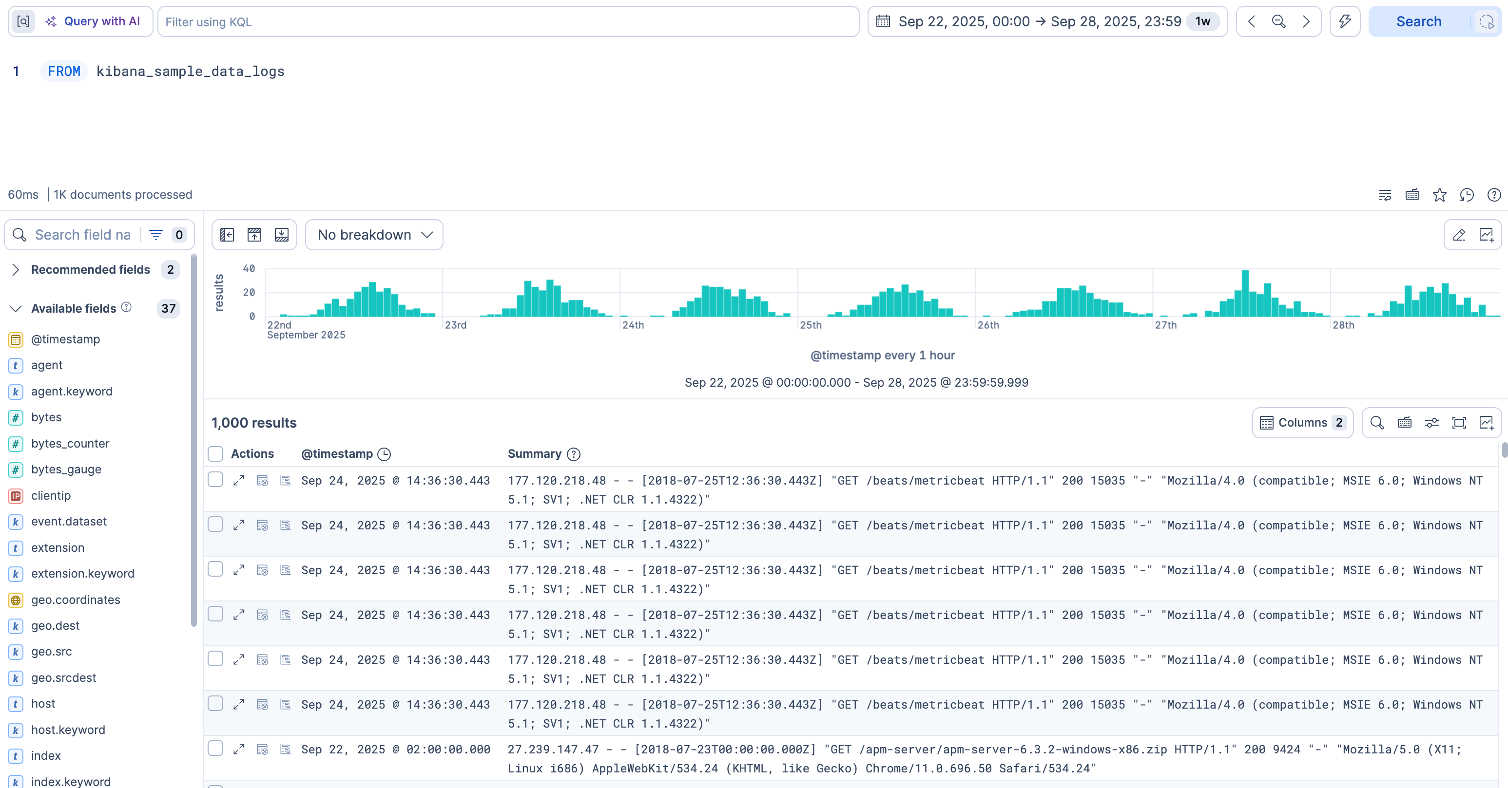

By default, the results table shows the @timestamp field and a Summary column that lists each result's key-value pairs. To customize the visible columns without changing the query, add fields from the fields list.
When the query doesn't contain transformational commands such as KEEP or STATS, the time field remains the first column after you add other fields. The time field is also included in CSV exports from Discover and from Discover session panels on dashboards.
To hide the time field, enable Hide 'Time' column (doc_table:hideTimeColumn).

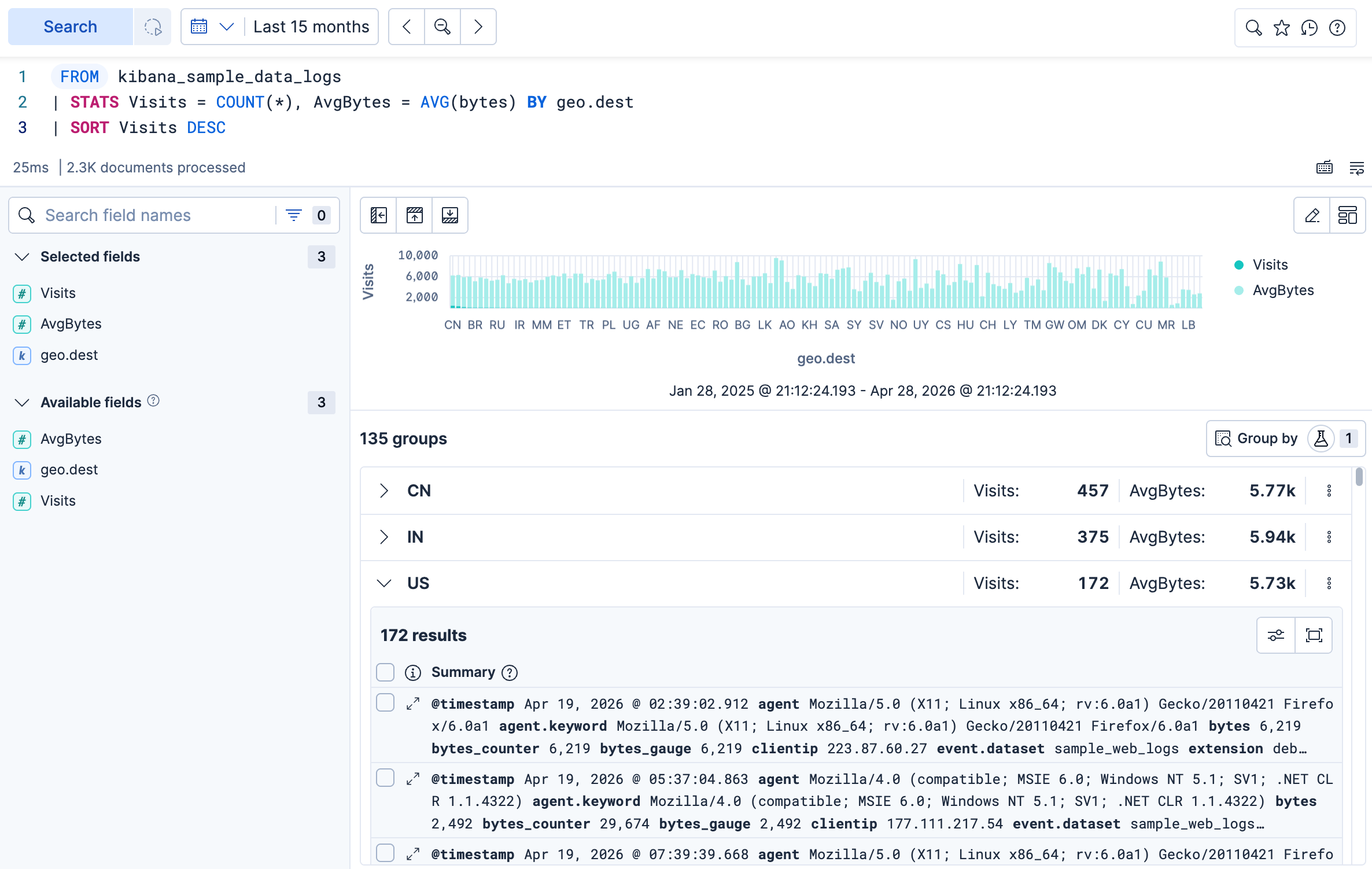

| KEEP @timestamp, bytes, geo.dest
| SORT bytes DESC

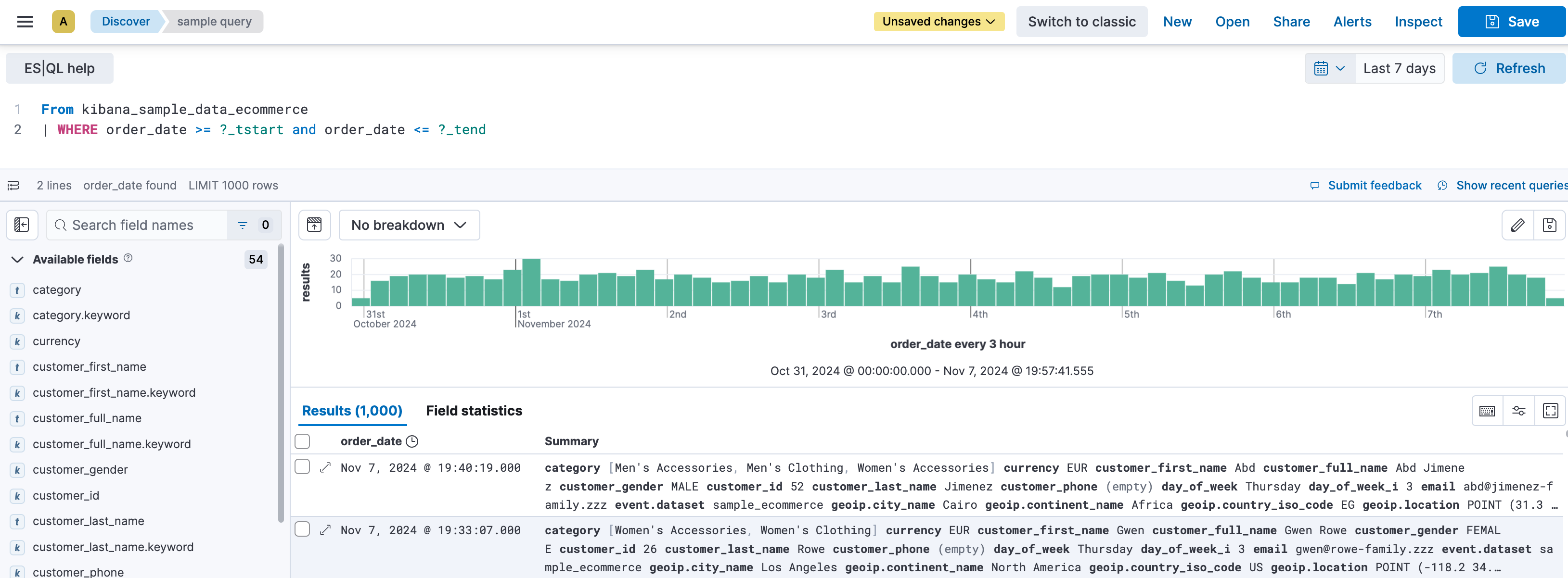

By default, ES|QL identifies time series data when an index contains a @timestamp field. This enables the time range selector and visualization options for your query.
If your index doesn’t have an explicit @timestamp field, but has a different time field, you can still enable the time range selector and visualization options by calling the ?_tstart and ?_tend parameters in your query.

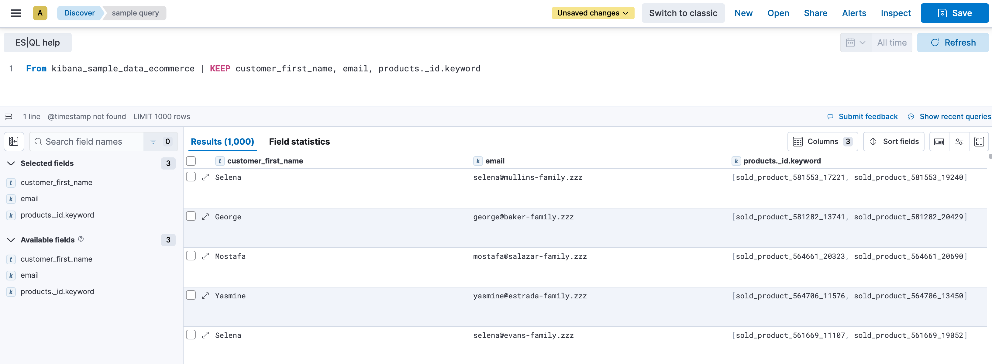

For example, the eCommerce sample data set doesn’t have a @timestamp field, but has an order_date field.
By default, when querying this data set, time series capabilities aren’t active. No visualization is generated and the time picker is disabled.
FROM kibana_sample_data_ecommerce
| KEEP customer_first_name, email, products._id.keyword

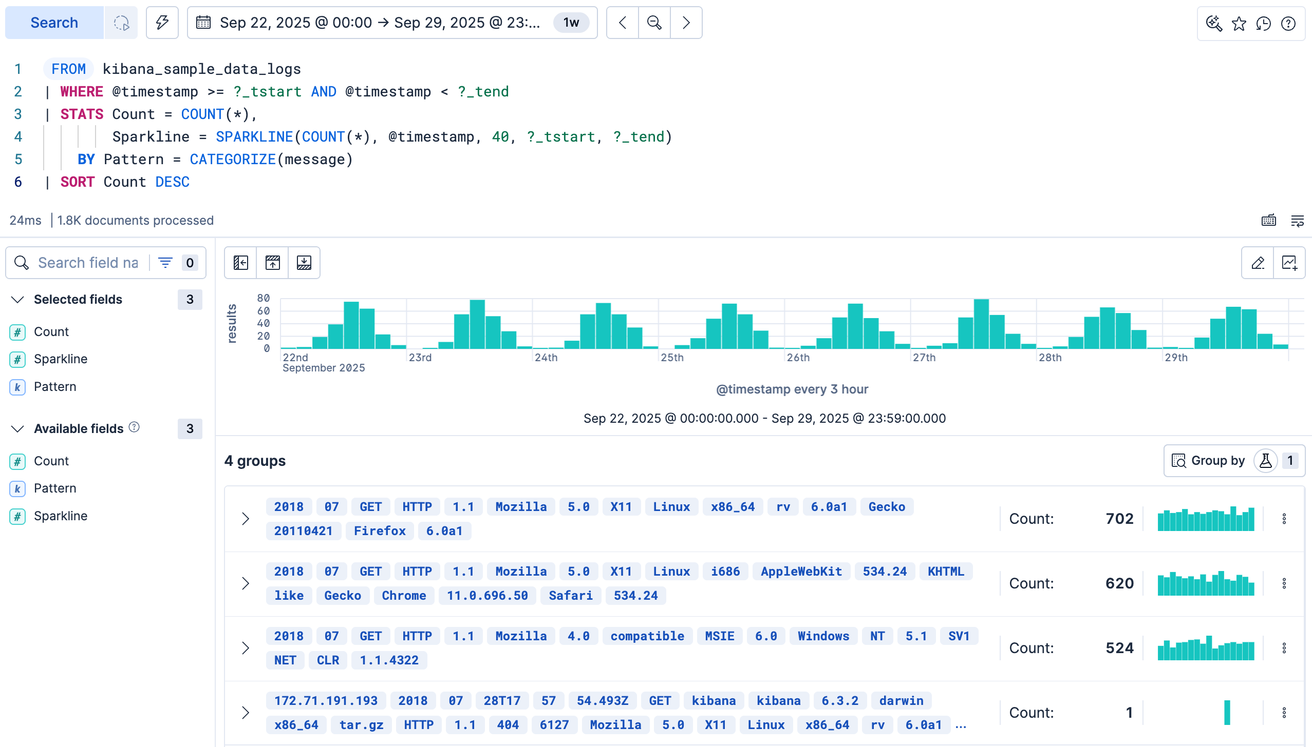

While still querying the same data set, by adding the ?_tstart and ?_tend parameters based on the order_date field, Discover enables times series capabilities.
| WHERE order_date >= ?_tstart and order_date <= ?_tend

When your ES|QL query uses a STATS BY clause with a single grouping field, Discover displays the results as expandable groups instead of a flat table. Each row represents one unique value of the grouping field, and you can expand it to inspect the underlying documents without leaving the query. The results count above the table reports the number of groups instead of the number of documents.
Note
When searching large datasets, you can get faster, estimated results by using Fast mode. Refer to Use ES|QL in the Kibana UI > Get faster results with approximate STATS.
Grouped results layout in Discover, with one row expanded to show underlying documents
The grouped layout activates when the BY clause contains a single field reference or a single CATEGORIZE call. Other grouping functions like BUCKET or TBUCKET, and queries that group by more than one field (for example, BY clientip, extension), keep the standard flat results table. Queries that use TS_INFO or METRICS_INFO also keep the flat results table, because those commands return synthetic metric-metadata rows that have no underlying documents to expand.
When the grouping field uses CATEGORIZE, each row title shows the detected pattern with token highlighting, so you can scan repeated message structures at a glance. For example:

When the query also computes a SPARKLINE over time, Discover renders an inline chart next to the row aggregates. For example, the following query categorizes log messages and renders a sparkline for each pattern:
| WHERE @timestamp >= ?_tstart AND @timestamp < ?_tend
| STATS Count = COUNT(*),
        Sparkline = SPARKLINE(COUNT(*), @timestamp, 40, ?_tstart, ?_tend)
    BY Pattern = CATEGORIZE(message)
| SORT Count DESC
On larger data sets, add a SAMPLE command before STATS to keep the categorization fast, and divide COUNT(*) by the same sample fraction to keep the counts representative. For example, SAMPLE 0.001 followed by Count = COUNT(*) / 0.001.
A grouped row showing a CATEGORIZE pattern with token highlighting and an inline sparkline

You can go back to the classic data view and KQL mode in Discover at any time. When you switch from ES|QL mode to classic mode, your ES|QL query is lost.
  1. Open the Discover tab that you want to switch to classic mode.
  2. Switch the active tab from either location:
    • From the tab's contextual menu ( ), select Switch to classic.
    • From the application menu, select Switch to Classic.
    This affects only the active Discover tab.
Tip
The contextual menu Switch to classic option only appears for the currently active tab. To see it for another tab, you must load that tab first.
From the application menu, select Switch to classic. This only affects your current Discover tab.
