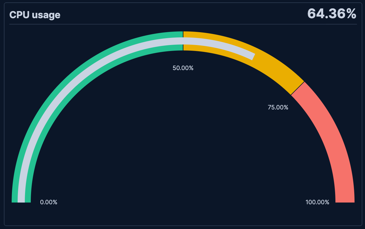

- Set meaningful bounds
- Define the minimum and maximum values that make sense for your metric. A CPU usage gauge should range from 0 to 100, while a sales target might range from 0 to your quarterly goal.
- Use color bands for thresholds
- Configure color ranges to indicate performance levels. Use green for acceptable values, yellow for warning, and red for critical thresholds.

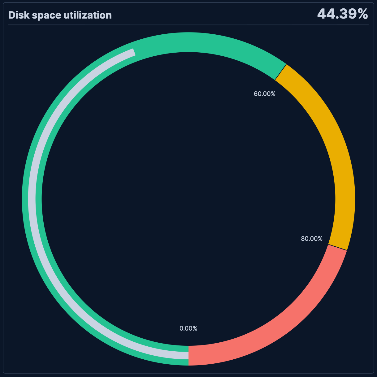

- Choose the right shape
- Select a gauge shape that fits your dashboard layout. Use Arc shapes for traditional gauge appearance, or Linear for a more compact horizontal or vertical display.

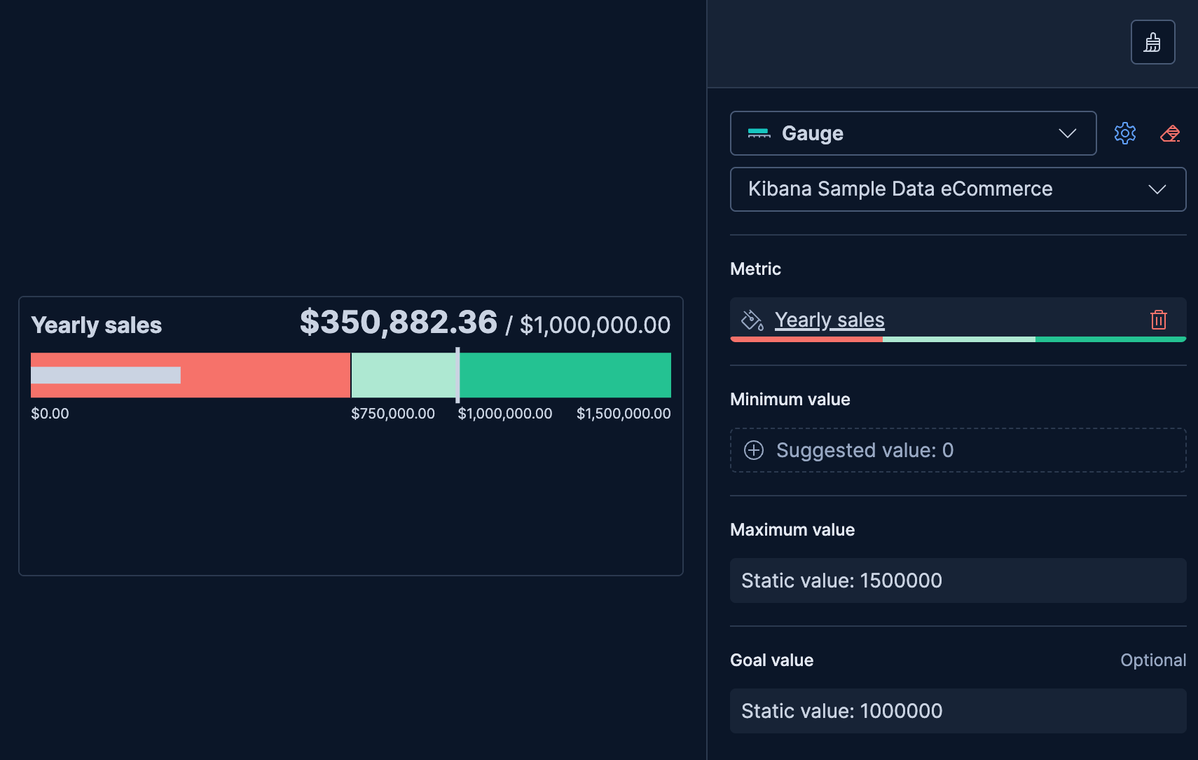

Use a gauge to track progress toward a specific target, such as monthly sales goals or project completion percentage.
- Create a Gauge chart and select your data view.
- Configure the Metric dimension with your progress value (for example,
Sum(sales_amount)). - Configure the Minimum value dimension as a static value of
0. - Configure the Maximum value dimension as a static value matching your target (for example,
100000for a $100K sales goal). - Configure the Goal dimension as a static value matching your target to display a goal marker on the gauge.
- Select the Metric dimension, enable Band colors, and configure Color mapping with bands to show progress levels.
Create this chart using the API
This example creates a horizontal bullet gauge that sums order revenue from the eCommerce sample data, providing a quick view of progress toward a sales goal.
These API request examples are kept up to date with the latest version of the APIs, so some fields might differ if you're using an earlier version. For a history of breaking changes, refer to the Kibana breaking changes or the Elastic Cloud Serverless breaking changes.

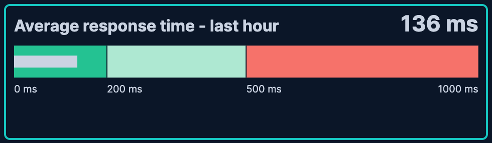

This example shows a gauge with server response time and color-coded health indicators.
| Band | Range | Color | Meaning |
| Healthy | 0-200ms | Green | Normal response times |
| Warning | 200-500ms | Light green | Elevated response times |
| Critical | 500ms+ | Red | Unacceptable performance |
This example creates a gauge with three color-coded threshold bands so the arc turns green, yellow, or red depending on the average byte count.

- Ticks on bands: Toggle to place tick marks at band boundaries instead of distributing them evenly along the gauge scale.
The Minimum value dimension defines the lower bound of the gauge range.
- Data
Set a static value, use a field with an aggregation like
Min, or create a custom calculation with a formula. When adding this dimension, you can enter a fixed number directly (static value) or select a field to compute the minimum dynamically. If not configured, the gauge infers a minimum from the data.Advanced settingsDepending on the data you defined, several options allow you to apply additional filtering to the data taken into account to compute the final value to show.
Based on the type of visualization you're creating, only some of the following options can be available:
- Normalize by unit: Normalize the metric values to show per unit of time.
- Filter by: Specify a query.
- Reduced time range: Reduce the time range specified on the dashboard's time filter by the specified duration.
- Time shift: Shift the time range by the specified duration. This is useful if the value should use a different time range than the one selected on the dashboard.
- Hide zero values: Don't show values equal to zero. This option is on by default.
NoteThe minimum value must be less than the maximum value. If the minimum is greater than or equal to the maximum, the gauge displays an error.
- Appearance
- Name: Customize the label for the minimum value.
The Maximum value dimension defines the upper bound of the gauge range.
- Data
Max, or create a custom calculation with a formula. When adding this dimension, you can enter a fixed number directly (static value) or select a field to compute the maximum dynamically. If not configured, the gauge infers a maximum from the data.Advanced settingsDepending on the data you defined, several options allow you to apply additional filtering to the data taken into account to compute the final value to show.
- Appearance
- Name: Customize the label for the maximum value.
The Goal dimension displays a target marker on the gauge, providing a visual reference point for the metric value.
- Data
Set a static value, use a field with an aggregation, or create a custom calculation with a formula. When adding this dimension, you can enter a fixed number directly (static value) or select a field to compute the goal dynamically. The goal marker appears as a line or indicator on the gauge scale.
- Appearance
- Name: Customize the label for the goal value.

- CPU usage monitoring
Monitor system CPU usage with threshold-based coloring:
- Example based on: Kibana Sample Data Logs
- Metric: Formula
average(machine.ram)/20000000000formatted as percent - Maximum: Formula
max(machine.ram)/32211000000 - Shape: Semi-circle
- Color bands: 0–50% (green), 50–75% (yellow), 75%+ (red)
This example creates a CPU-monitoring gauge with green/yellow/red threshold bands, using machine.ram from the logs sample data as a proxy for a CPU-like metric.
POST kbn://api/visualizations
"type": "gauge",
"title": "CPU usage",
"filters": [],
"query": { "expression": "" },
"styling": { "shape": { "type": "semi_circle" } },
"metric": {
"operation": "formula",
"formula": "average(machine.ram)/20000000000",
"label": "CPU usage",
"format": { "type": "percent", "decimals": 2, "compact": false },
"max": { "operation": "formula", "formula": "max(machine.ram)/32211000000" },
"title": { "visible": true },
"ticks": { "visible": true, "mode": "bands" },
"color": {
"type": "dynamic",
"range": "percentage",
"steps": [
{ "gte": 0, "lt": 50, "color": "#24c292" },
{ "gte": 50, "lt": 75, "color": "#EAAE01" },
{ "gte": 75, "color": "#f6726a" }
"data_source": {
"type": "data_view_spec",
"index_pattern": "kibana_sample_data_logs",
"time_field": "timestamp"
formulacomputes the ratio of average RAM to a reference value, producing a 0–1 ratio formatted as a percentage. Replace with your actual CPU metric field (for example,average(system.cpu.total.pct)).range: "percentage"maps the color thresholds proportionally across the gauge's 0–100% scale: green below 50%, yellow between 50–75%, and red above 75%.

- Disk space utilization
Display disk space usage as a percentage of capacity:
- Metric: Formula
average(machine.ram)/29000000000formatted as percent - Maximum: Formula
max(machine.ram)/32211000000 - Shape: Circle
- Color bands: 0–60% (green), 60–80% (yellow), 80%+ (red)
This example creates a full-circle disk utilization gauge with color bands that shift from green to red as usage increases, using machine.ram from the logs sample data as a proxy.
"type": "gauge",
"title": "Disk space utilization",
"filters": [],
"styling": {
"shape": { "type": "circle" }
"metric": {
"formula": "average(machine.ram)/29000000000",
"label": "Disk space utilization",
"color": {
"type": "dynamic",
"steps": [
{ "gte": 0, "lt": 60, "color": "#24c292" },
{ "gte": 60, "lt": 80, "color": "#EAAE01" },
{ "gte": 80, "color": "#f6726a" }
"data_source": {
circledraws a full 360-degree gauge, which works well for utilization percentages where the full range is always visible.- The
formuladivides average RAM by a reference capacity value to produce a 0–1 ratio formatted as percent. Replace with your actual disk metric (for example,sum(system.filesystem.used.bytes) / sum(system.filesystem.total.bytes)). - The
percentagerange maps thresholds proportionally: green below 60%, yellow between 60–80%, and red above 80%, so the gauge turns red only when disk usage becomes critical.
