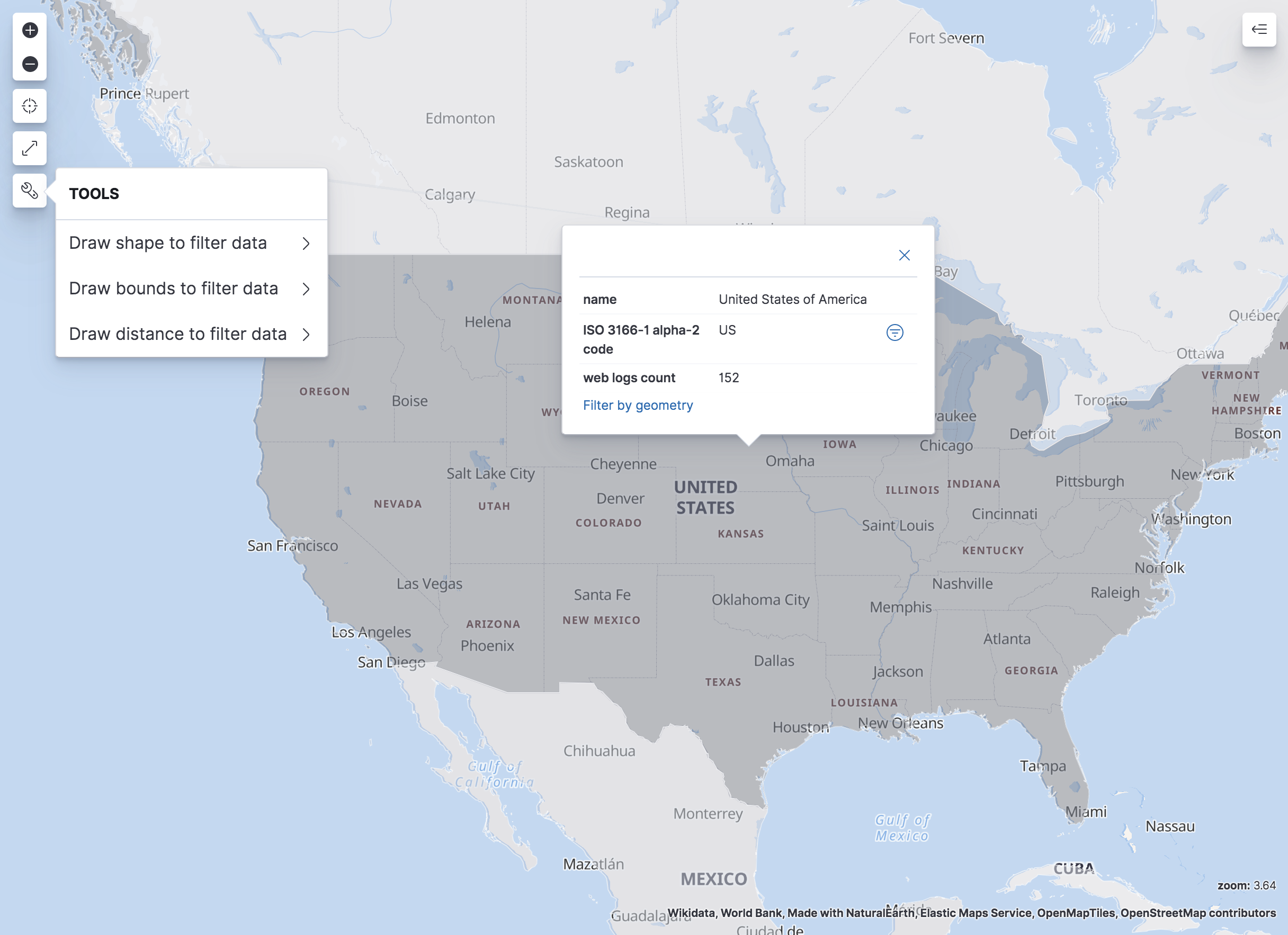

You can create spatial filters in two ways:
  • Click the tool icon , and then draw a shape, bounding box, or distance on the map to define the spatial filter.
  • Click Filter by geometry in a locked tooltip, and then use the feature’s geometry for the spatial filter.
A phrase filter narrows search results to documents that contain the specified text. You can create a phrase filter by selecting the icon next to a property in a locked tooltip. If the map is a dashboard panel with drilldowns, you can apply a phrase filter to a drilldown by selecting the drilldown action.
