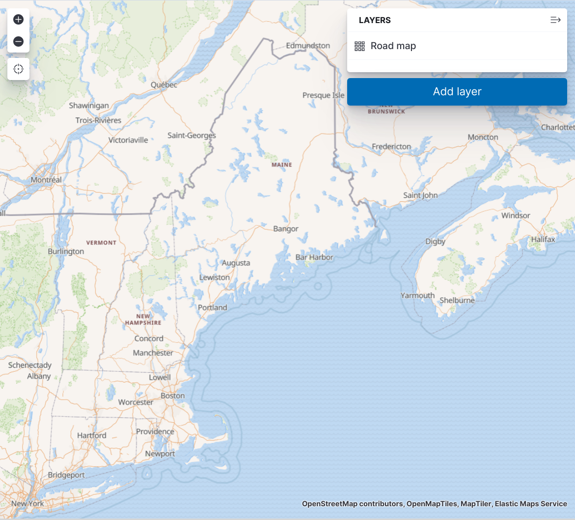

  1. Create a new map.
  2. Zoom in on the New England area in the northeast United States.
    You’re adding flight paths to this area, and this sets up the map for a good view of the data.
    fu gs new england map

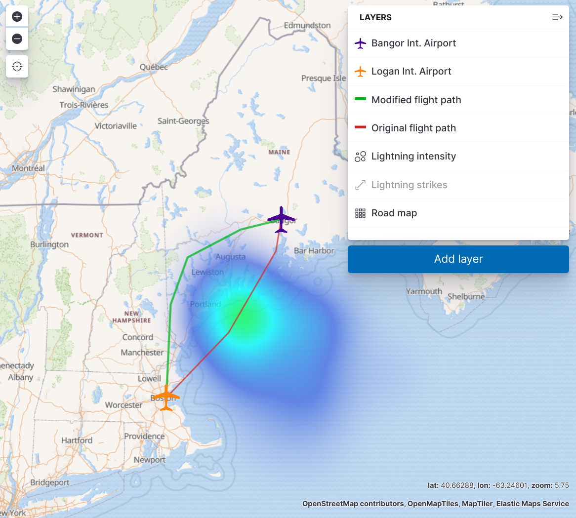

    With your new lightning heat map layer, your map should look like this:
    fu gs lightning intensity
Consider ways you might improve the appearance of the final map. Small changes in how and when layers are shown can help tell a better story with your data. Here are a few final tweaks you might make:
  • Update layer names
  • Adjust styles for each layer
  • Adjust the layer order
  • Decide which layers to show at different zoom levels
When you’ve finished, again be sure to save your work .
Your final map might look like this:
fu gs final map
