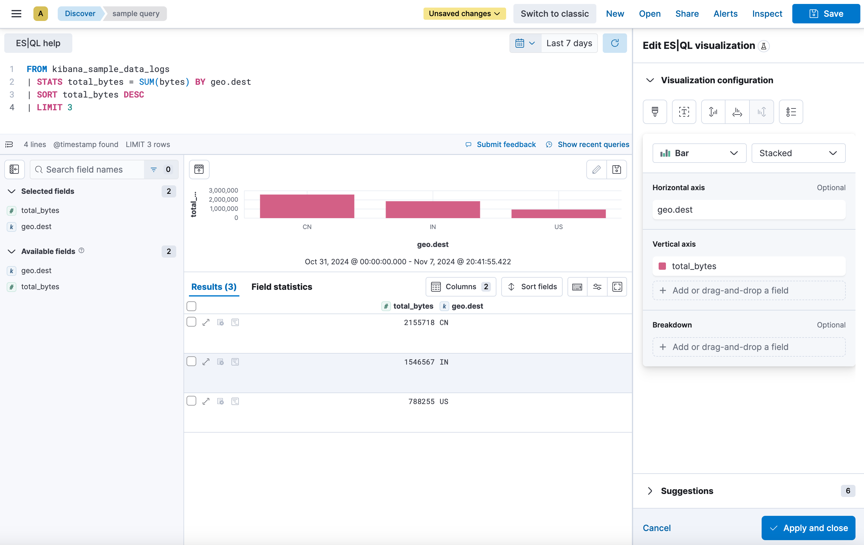

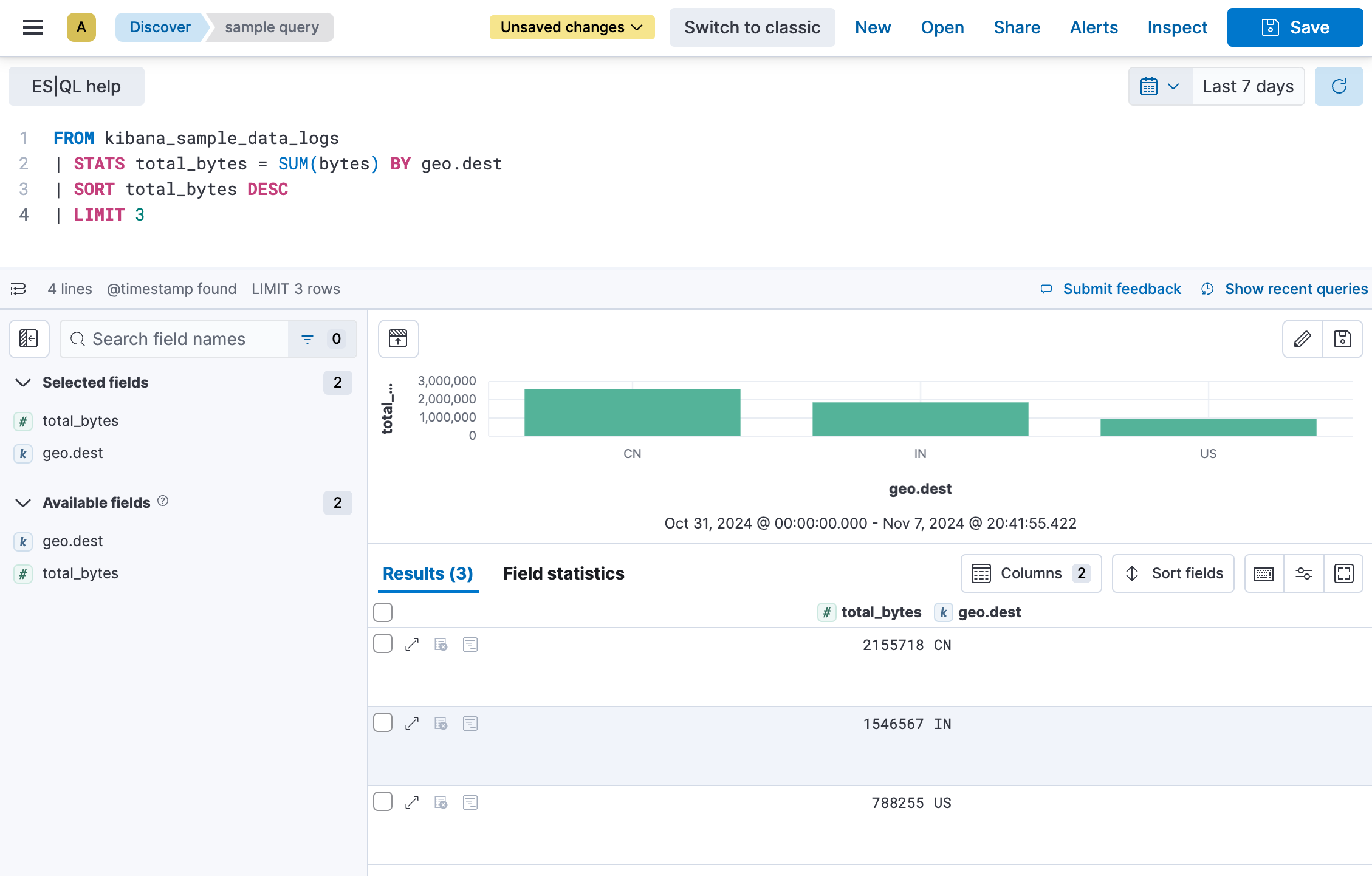

Discover Explore data, visualize results, and save findings to dashboards ES|QL editor

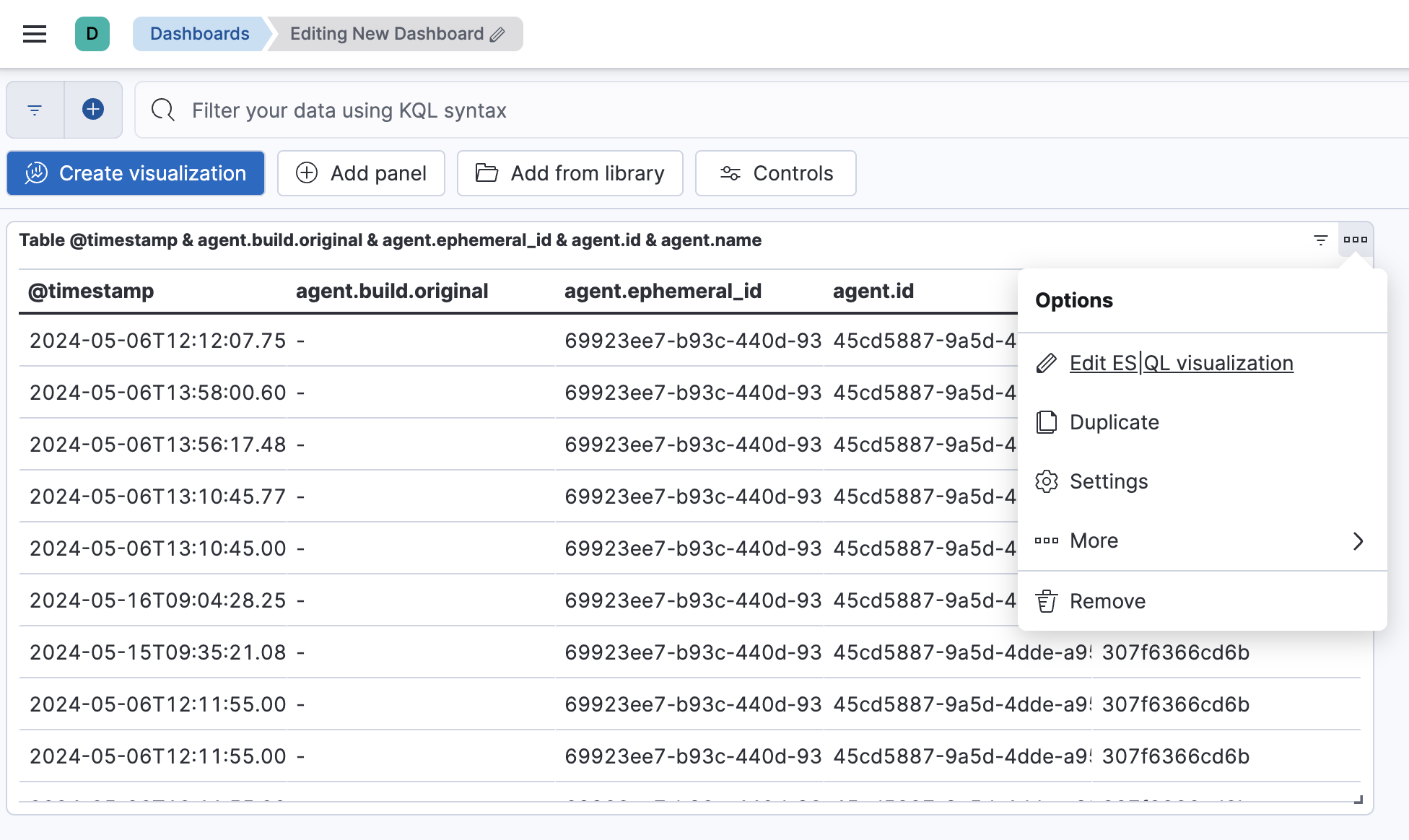

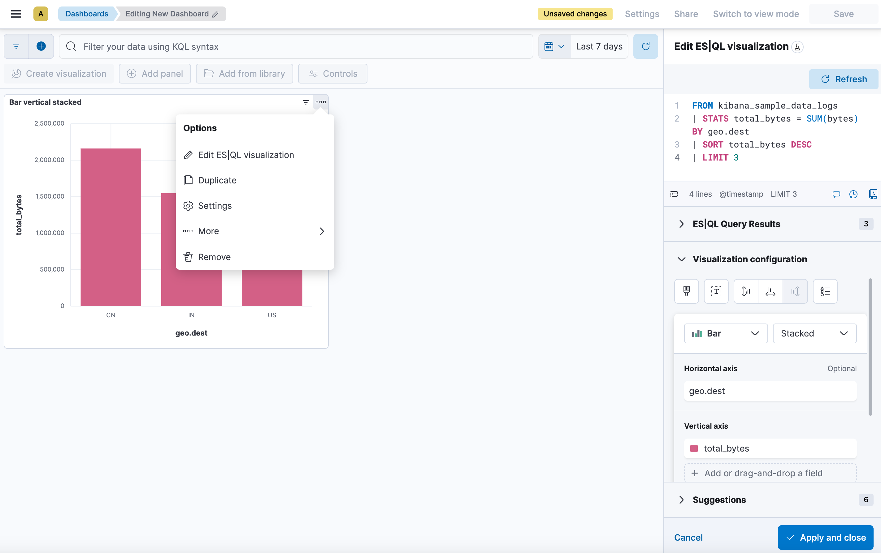

Dashboards and visualizations Create visualization panels and interactive controls ES|QL editor

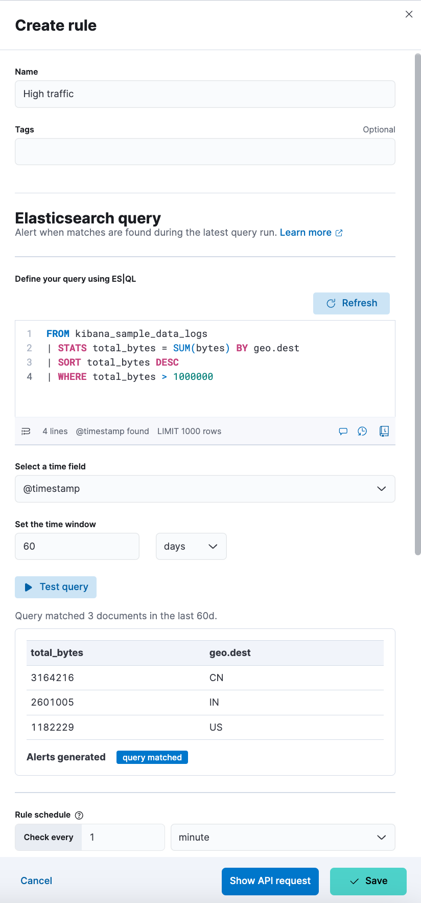

Kibana Universal Alerting Create alerting rules based on ES|QL queries Rule form or YAML editor
Kibana Universal Alerting Build and preview rules with separate base, alert, and recovery queries Task-specific editor and YAML editor

After any SET statements, every ES|QL query starts with a source command that retrieves data:
You can then chain one or more processing commands using pipe (|) characters. For example, WHERE filters rows and STATS aggregates data:
FROM kibana_sample_data_logs
| WHERE response.keyword == "200"
| STATS total_bytes = SUM(bytes) BY geo.dest

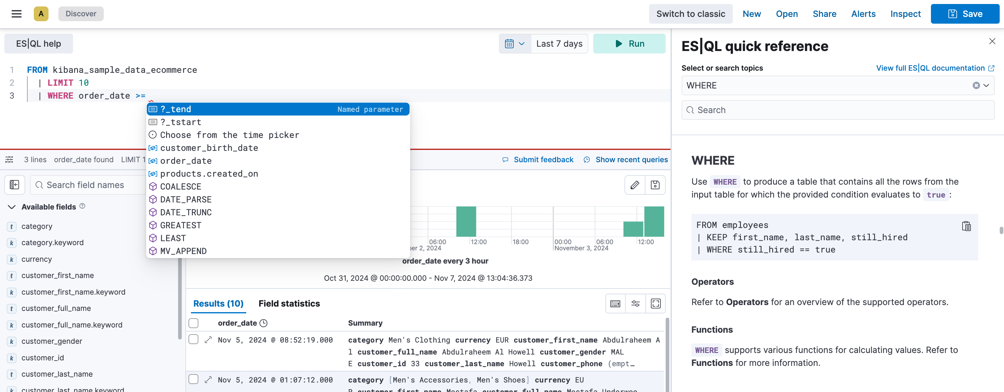

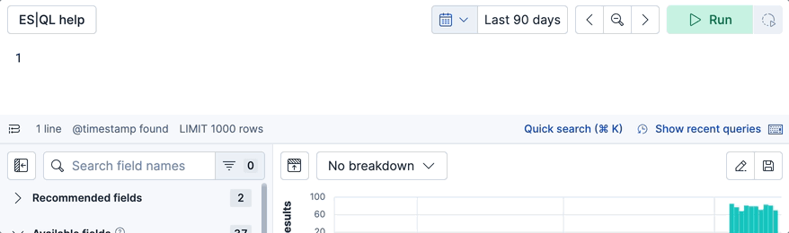

The ES|QL editor includes several built-in tools to help you write queries efficiently:

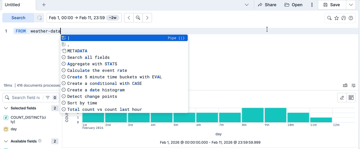

ES|QL features in-app help, inline suggestions, and an autocomplete menu so you can get started faster and don't have to leave the application to check syntax.
The ES|QL syntax reference and the autocomplete menu

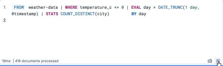

For readability, you can put each processing command on a new line and add indentation. Use the Prettify query button from the query editor's footer to format your query automatically. You can also adjust the editor's height by dragging its bottom border.
Automatic line breaks and indentation for ES|QL queries

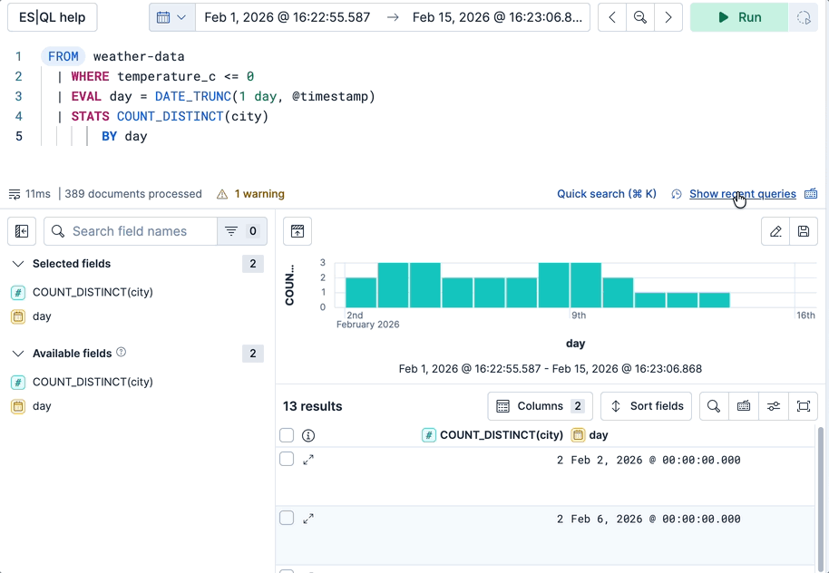

A query might result in warnings, for example when querying an unsupported field type. When that happens, the editor's footer shows the number of warnings, for example 2 warnings. Select it to see the detailed warnings.

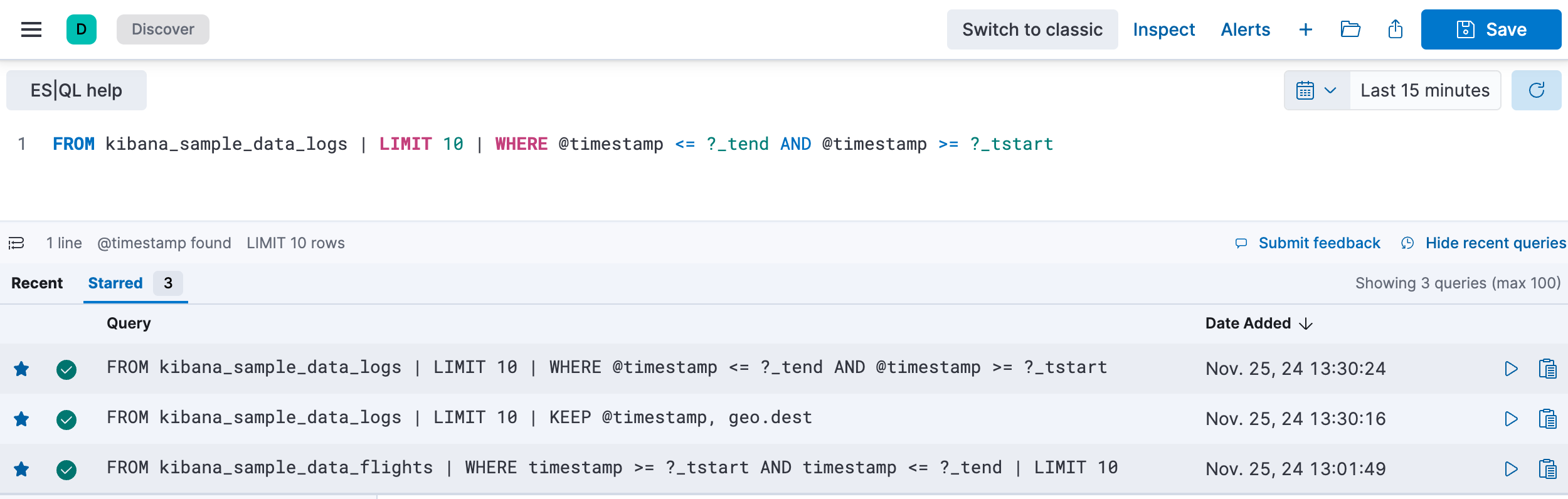

After running a query, the editor's footer displays statistics about the last run, including the number of documents processed. These statistics are available in Discover and in ES|QL visualizations in dashboards.

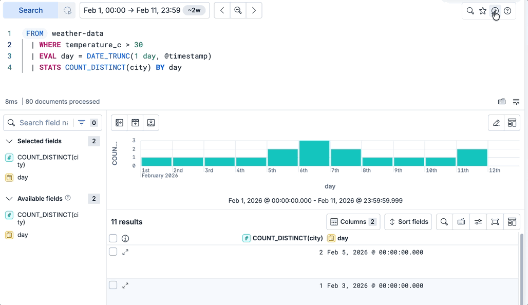

⌘Cmd + i ⌃Ctrl + i Prettify query

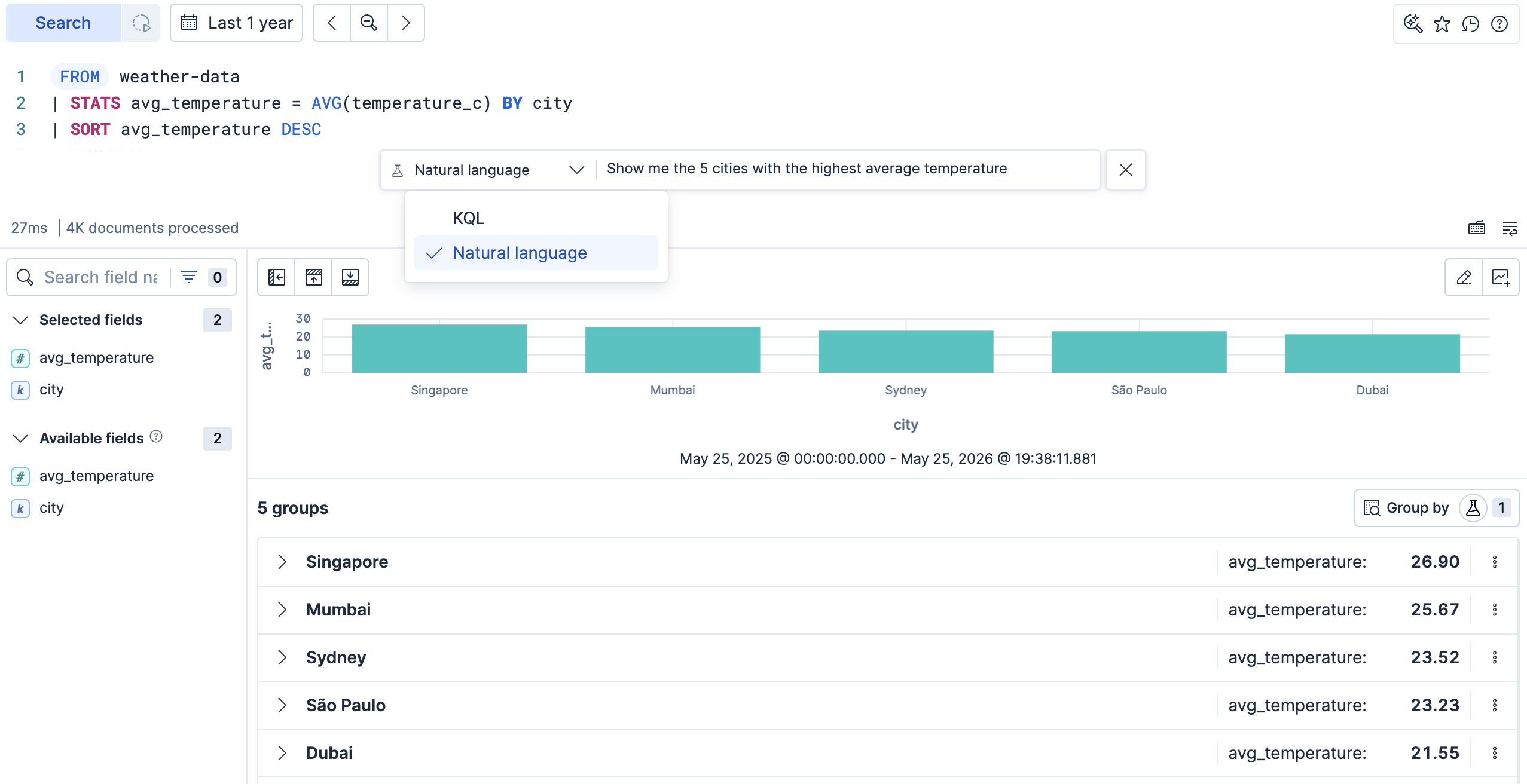

Not sure how to write an ES|QL query? Describe what you want from your data in natural language and a specialized AI agent writes the query for you.
  1. If the search bar isn't visible, open it ( ).
  2. From the mode selector, select Natural language.
  3. In the input, describe the query you want. For example, Show the average response time per host for the last 24 hours.
  4. Press Enter to submit your request. The editor replaces or updates the current query, runs it, and saves it to your query history.
  5. Review the generated query and refine it with any other ES|QL command or function that you need.
Tip
The current query in the editor is sent to the LLM as context, so you can ask follow-up requests that build on it. For example, after running a generated query, ask Group the results by region to extend it.
Natural language mode in the ES|QL editor search bar

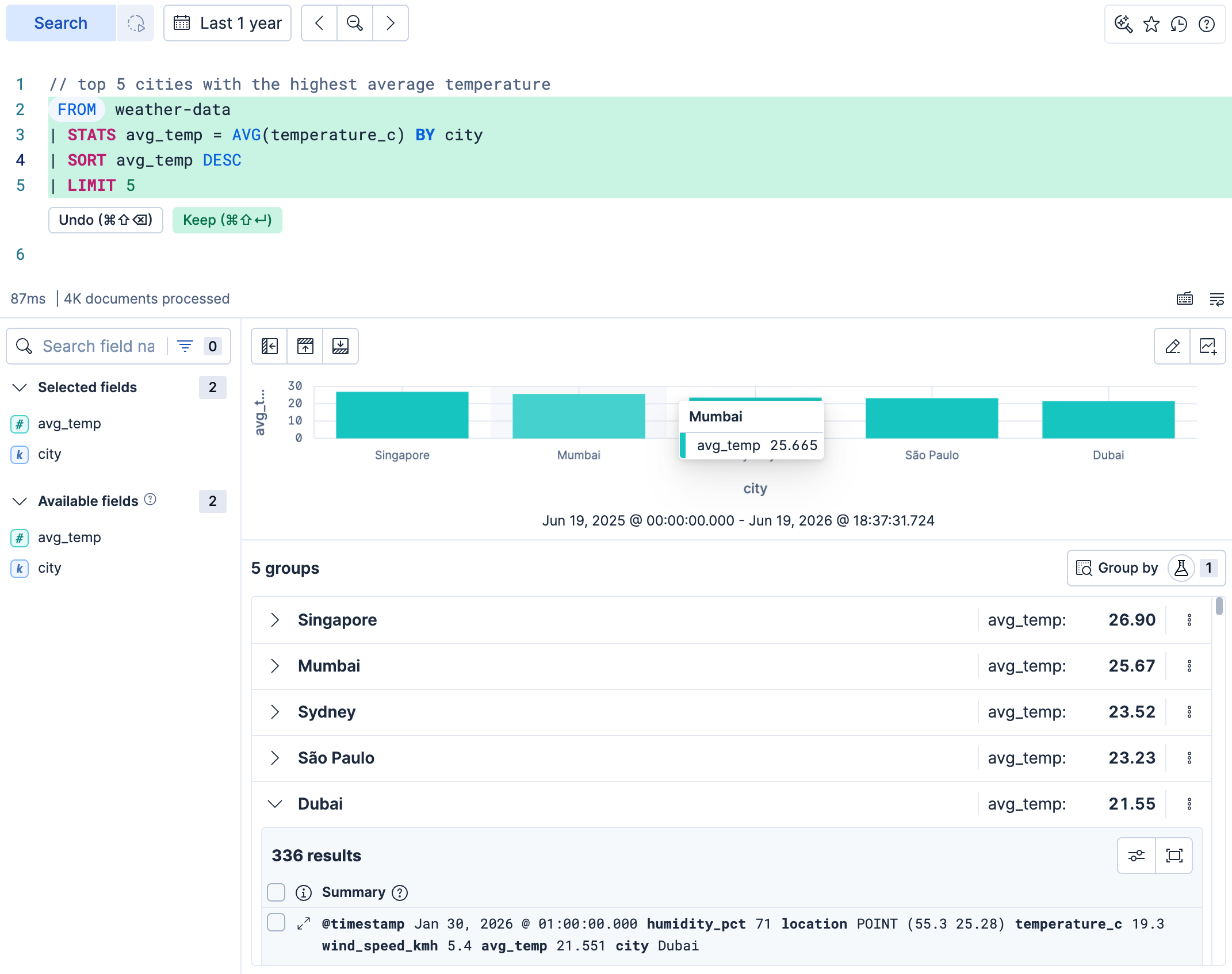

Write a // comment that describes what you want, then press ⌘Cmd + j (Mac) or ⌃Ctrl + j (Windows/Linux). The editor sends your comment to the AI agent and inserts the generated ES|QL on the next line.
You can use this to:
  • Write a query from scratch when the editor is empty. For example, type // Show the top 10 destinations by flight count and press ⌘Cmd + j to generate a complete query.
  • Add a step to an existing query. Place the comment between pipes (for example // filter for delayed flights) and the AI agent generates a single pipe to append. If the AI agent determines that your comment describes a change to the next pipe rather than a new step, it modifies that pipe instead.
While the AI agent is generating, a Generating... indicator appears next to your comment. Press the shortcut again to cancel the in-flight request and start a new one.
When the generated code is ready, the editor highlights it and shows review actions:
  • Keep (⌘Cmd + ⇧Shift + ↵Enter on Mac, ⌃Ctrl + ⇧Shift + ↵Enter on Windows/Linux) accepts the change and leaves your comment in place so you can refine it and regenerate.
  • Undo (⌘Cmd + ⇧Shift + ⌫Backspace on Mac, ⌃Ctrl + ⇧Shift + ⌫Backspace on Windows/Linux) removes the generated code.
The ES|QL editor showing a query generated from a comment, highlighted with Keep and Undo review actions
When the AI agent rewrites an existing pipe instead of adding one, the original pipe appears with a strikethrough and the Keep button becomes Replace, indicating that accepting the suggestion removes the original pipe.

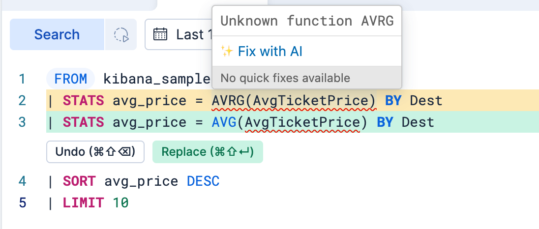

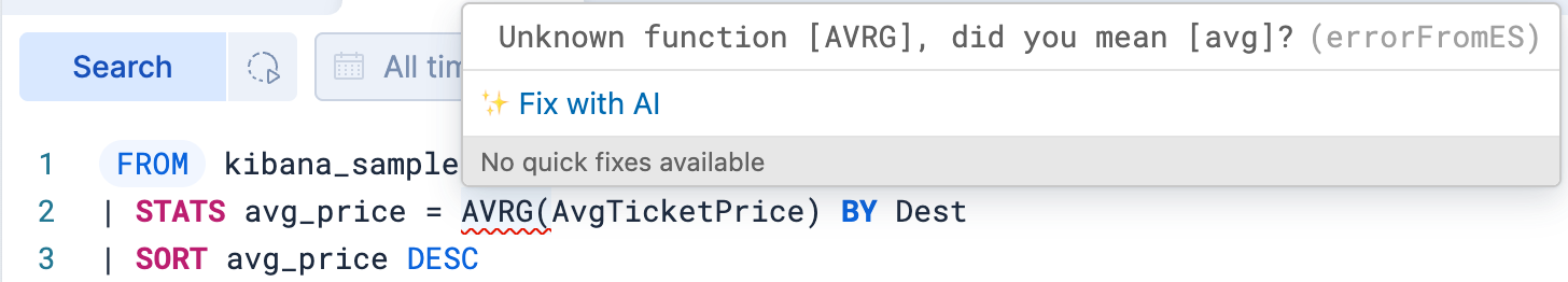

When your query fails validation, hover over the underlined error in the editor. The error popup includes a ✨ Fix with AI link. Select it to send the query and the error to the AI agent and have it propose a corrected version.
An ES|QL query error popup showing the Fix with AI link
The proposed fix appears directly below your query, with the original lines and the suggested replacement highlighted in different colors. The same review actions as for comment-driven generation apply:
  • Replace (⌘Cmd + ⇧Shift + ↵Enter on Mac, ⌃Ctrl + ⇧Shift + ↵Enter on Windows/Linux) replaces the original lines with the suggested fix.
  • Undo (⌘Cmd + ⇧Shift + ⌫Backspace on Mac, ⌃Ctrl + ⇧Shift + ⌫Backspace on Windows/Linux) discards the suggestion and restores the original query.
An ES|QL editor showing the original lines and the proposed AI fix highlighted in different colors, with Replace and Undo actions

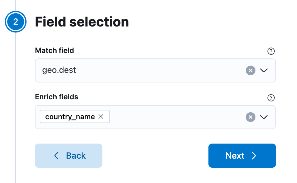

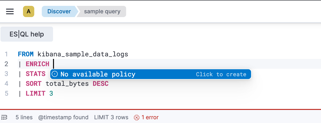

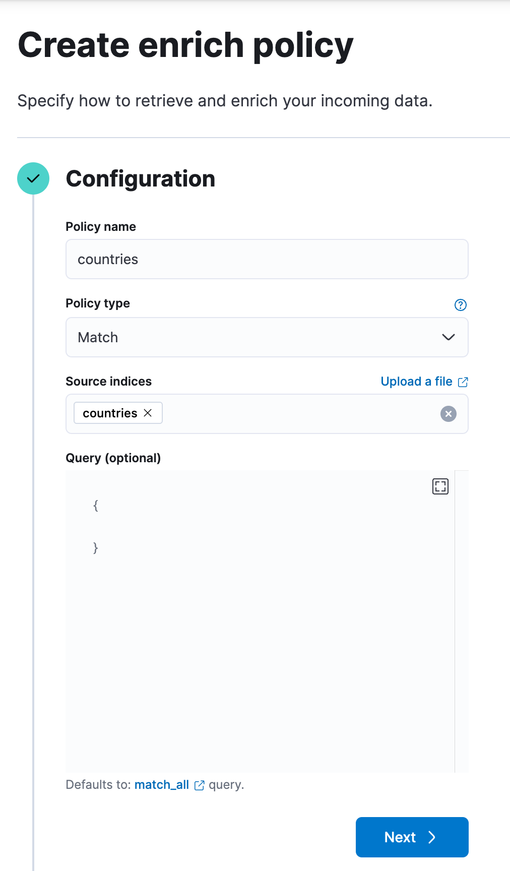

The ES|QL ENRICH command enables you to enrich your query dataset with fields from another dataset. Before you can use ENRICH, you need to create and execute an enrich policy. If a policy exists, autocomplete suggests it. If not, select Click to create to create one.
The ES|QL editor showing the ENRICH command, with an autocomplete suggestion that reads
For detailed steps to create an enrich policy from the editor, refer to Enrich your data.

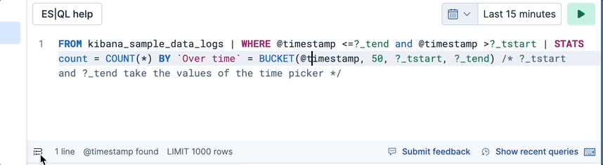

To display data within a specified time range, you can use the standard time filter, custom time parameters, or a WHERE command.
Kibana enables the standard time filter when the indices you're querying have a field named @timestamp.
If your indices do not have a field named @timestamp, you can use the ?_tstart and ?_tend parameters to specify a time range. These parameters work with any timestamp field and automatically sync with the time filter.
FROM my_index
| WHERE custom_timestamp >= ?_tstart AND custom_timestamp < ?_tend
You can also use the ?_tstart and ?_tend parameters with the BUCKET function to create auto-incrementing time buckets in ES|QL visualizations. For example:
| STATS average_bytes = AVG(bytes) BY BUCKET(@timestamp, 50, ?_tstart, ?_tend)

The ES|QL editor keeps track of your queries so you can reuse and organize them.
ES|QL editor query history and starred queries
You can reuse your recent ES|QL queries. In the ES|QL editor, select Show recent queries.
You can then:
  • scroll through your most recent queries
  • search for specific queries of your history
Note
The maximum number of queries in the history depends on the version you're using:
  • The query history can keep up to 50 KB of queries, which represents about 200 large queries, or about 300 short queries.
  • The query history keeps your 20 most recent queries.
From the query history, you can mark some queries as favorite to find and access them faster later.
  1. In the ES|QL editor, select Show recent queries.
  2. On the Recent tab, star the queries you want.
To find your starred queries later, open the Starred tab.

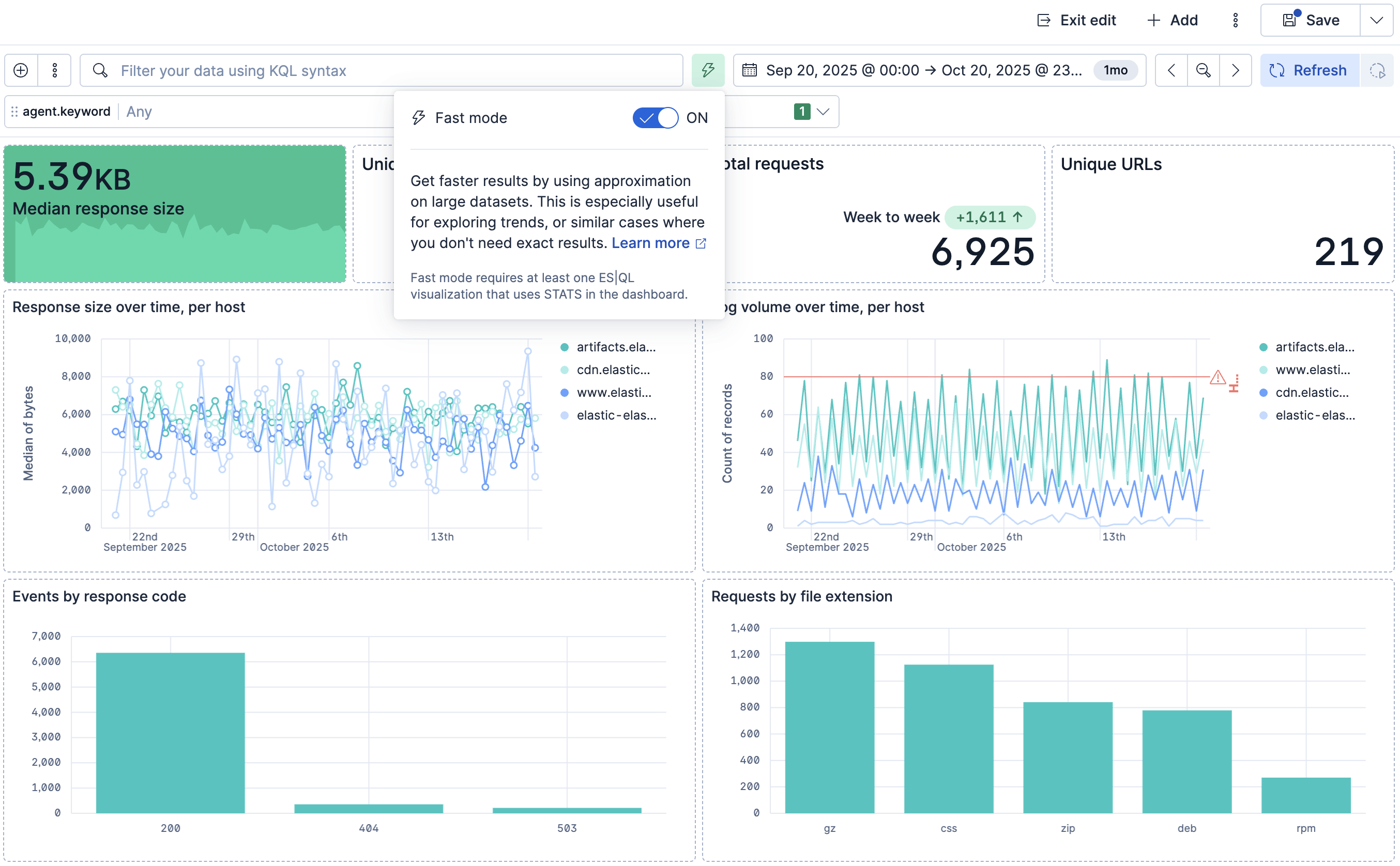

Fast mode is the Kibana UI control for ES|QL approximation. Select the Fast mode option to turn it on.
The Fast mode option turned on in the query bar
Where it applies depends on the context:
  • In Discover, in ES|QL mode, the button is always available, but Fast mode applies only to queries that use exactly one STATS command.
  • In Dashboards or when previewing a dashboard created with Elastic Agent Builder, Fast mode can return faster, estimated results for ES|QL visualizations, ES|QL-based Discover sessions, custom panels that have an ES|QL query, and ES|QL-powered Vega and Vega-Lite panels that use one STATS command. You can turn Fast mode on when the dashboard includes at least one ES|QL-based panel.
