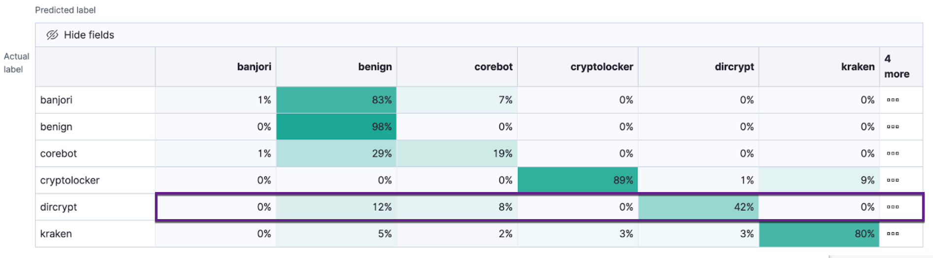

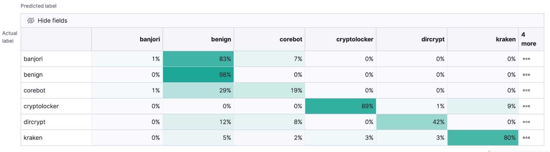

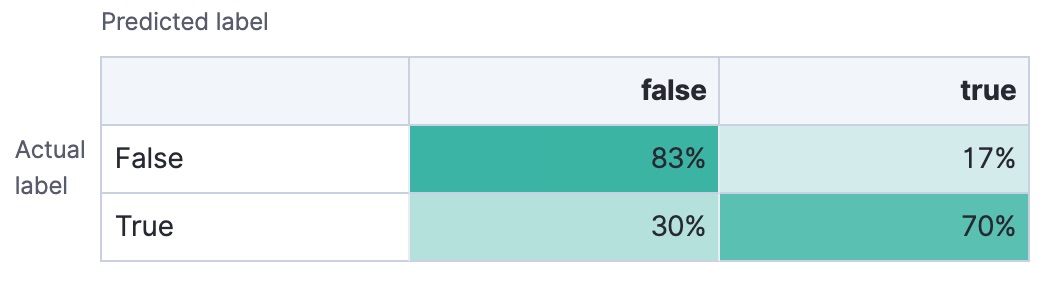

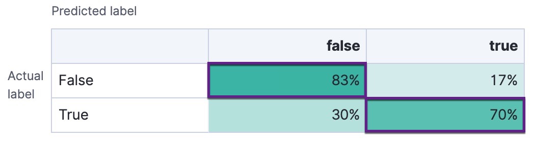

The multiclass confusion matrix provides a summary of the performance of the classification analysis. It contains the number of occurrences where the analysis classified data points correctly with their actual class as well as the number of occurrences where it misclassified them.
This is an example of a confusion matrix for a binary problem:
It is a two by two matrix because there are only two classes (true and false). It shows the proportion of data points that is correctly identified as members of a each class and the proportion that is misidentified.
As the number of classes increases, the confusion matrix becomes more complex:
This matrix contains the actual labels on the left side while the predicted labels are on the top. The proportion of correct and incorrect predictions is broken down for each class. This enables you to examine how the classification analysis confused the different classes while it made its predictions.

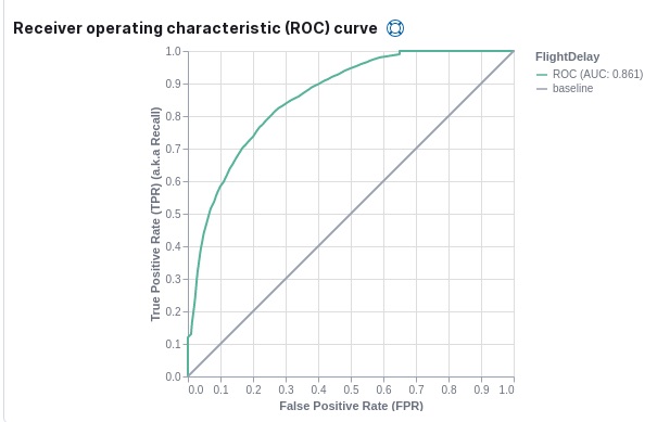

The receiver operating characteristic (ROC) curve is a plot that represents the performance of the classification process at different predicted probability thresholds. It compares the true positive rate for a specific class against the rate of all the other classes combined ("one versus all" strategy) at the different threshold levels to create the curve.
For example, there are three classes: A, B, and C, and AUC ROC is calculated for A. In this case, the number of correctly classified As (true positives) are compared to the number of Bs and Cs that are misclassified as As (false positives).
From this plot, you can compute the area under the curve (AUC) value, which is a number between 0 and 1. The higher the AUC, the better the model is at predicting As as As, in this case.
To use this evaluation method, you must set num_top_classes to -1 or a value greater than or equal to the total number of classes when you create the data frame analytics job.

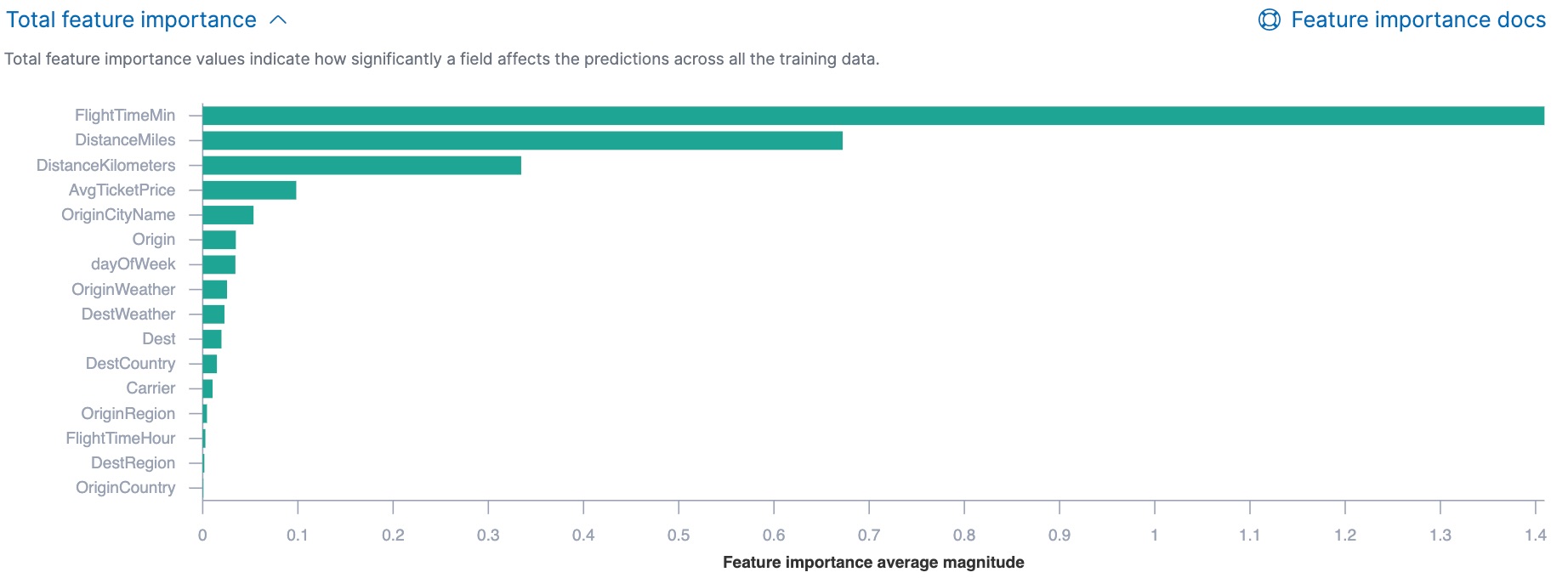

Feature importance provides further information about the results of an analysis and helps to interpret the results in a more subtle way. If you want to learn more about feature importance, refer to Feature importance.

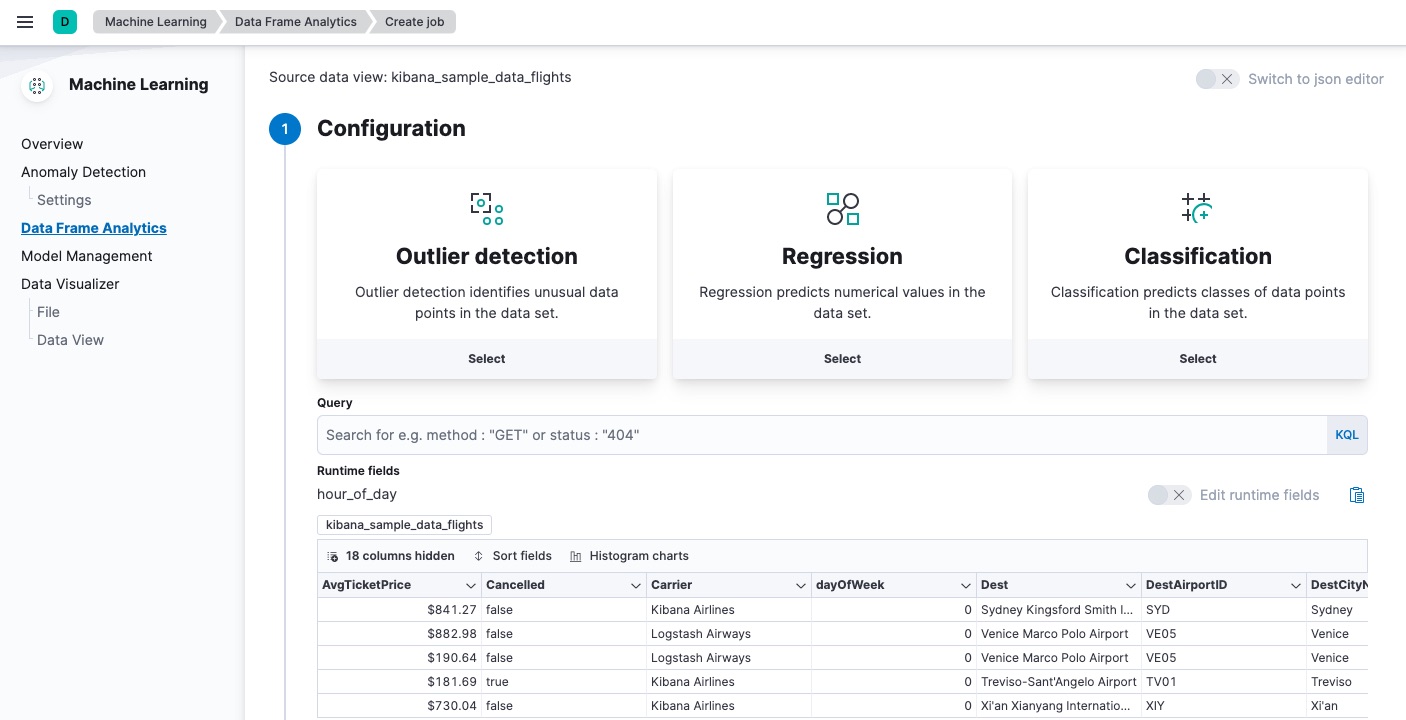

Create a data frame analytics job. You can use the wizard on the Machine Learning > Data Frame Analytics tab in Kibana or the create data frame analytics jobs API.
- Choose
kibana_sample_data_flightsas the source index. - Choose
classificationas the job type. - Choose
FlightDelayas the dependent variable, which is the field that we want to predict with the classification analysis. - Add
Cancelled,FlightDelayMin, andFlightDelayTypeto the list of excluded fields. It is recommended to exclude fields that either contain erroneous data or describe thedependent_variable. The wizard includes a scatterplot matrix, which enables you to explore the relationships between the numeric fields. The color of each point is affected by the value of the dependent variable for that document, as shown in the legend. You can highlight an area in one of the charts and the corresponding area is also highlighted in the rest of the charts. You can use this matrix to help you decide which fields to include or exclude.

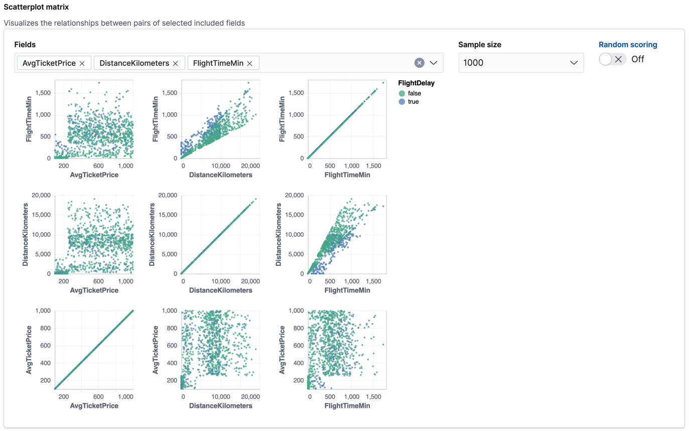

If you want these charts to represent data from a larger sample size or from a randomized selection of documents, you can change the default behavior. However, a larger sample size might slow down the performance of the matrix and a randomized selection might put more load on the cluster due to the more intensive query. 5. Choose a training percent of
10which means it randomly selects 10% of the source data for training. While that value is low for this example, for many large data sets using a small training sample greatly reduces runtime without impacting accuracy. 6. If you want to experiment with feature importance, specify a value in the advanced configuration options. In this example, a maximum of 10 feature importance values per document will return. This option affects the speed of the analysis, so by default it is disabled. 7. Use the default memory limit for the job. If the job requires more than this amount of memory, it fails to start. If the available memory on the node is limited, this setting makes it possible to prevent job execution. 8. Add a job ID (such asmodel-flight-delays-classification) and optionally a job description. 9. Add the name of the destination index that will contain the results. In Kibana, the index name matches the job ID by default. It will contain a copy of the source index data where each document is annotated with the results. If the index does not exist, it will be created automatically. 10. Use default values for all other options.- Choose

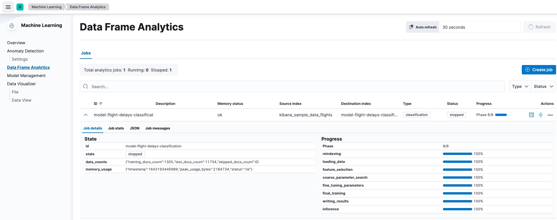

Start the job in Kibana or use the start data frame analytics jobs API.
The job takes a few minutes to run. Runtime depends on the local hardware and also on the number of documents and fields that are analyzed. The more fields and documents, the longer the job runs. It stops automatically when the analysis is complete.
API example
POST _ml/data_frame/analytics/model-flight-delays-classification/_start
- Check the job stats to follow the progress in Kibana or use the get data frame analytics jobs statistics API.
When the job stops, the results are ready to view and evaluate. To learn more about the job phases, see How data frame analytics jobs work.

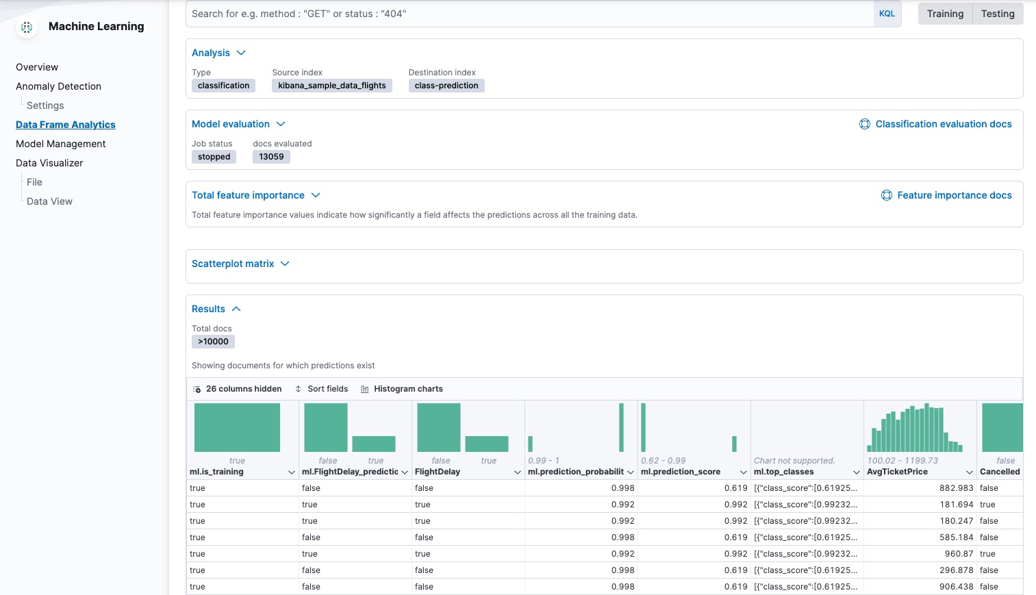

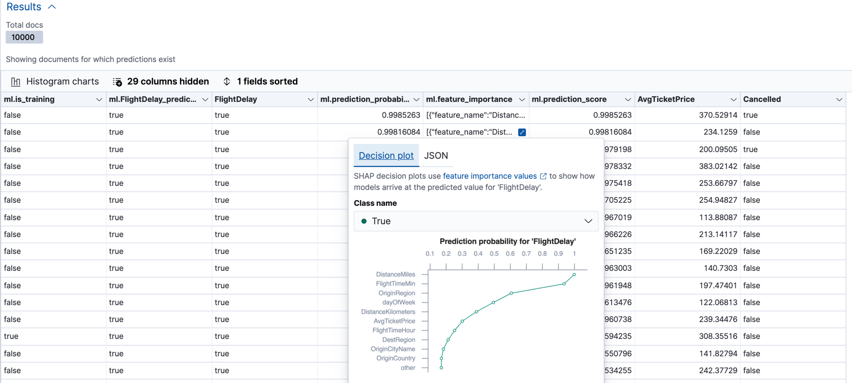

Now you have a new index that contains a copy of your source data with predictions for your dependent variable.
When you view the classification results in Kibana, it shows the contents of the destination index in a tabular format. It also provides information about the analysis details, model evaluation metrics, total feature importance values, and a scatterplot matrix.
The table shows a column for the dependent variable (FlightDelay), which contains the ground truth values that you are trying to predict. It also shows a column for the predicted values (ml.FlightDelay_prediction), which were generated by the classification analysis. The ml.is_training column indicates whether the document was used in the training or testing data set. You can use the Training and Testing filter options to refine the contents of the results table. You can also enable histogram charts to get a better understanding of the distribution of values.
If you want to understand how certain the model is about each prediction, you can examine its probability and score (ml.prediction_probability and ml.prediction_score). The higher these values are, the more confident the model is that the data point belongs to the named class. If you examine the destination index more closely in the Discover app in Kibana or use the standard Elasticsearch search command, you can see that the analysis predicts the probability of all possible classes for the dependent variable. The top_classes object contains the predicted classes with the highest scores.
If you have a large number of classes, your destination index contains a large number of predicted probabilities for each document. When you create the classification job, you can use the num_top_classes option to modify this behavior.
API example
GET model-flight-delays-classification/_search
The snippet below shows the probability and score details for a document in the destination index:
"FlightDelay" : false,
"ml" : {
"FlightDelay_prediction" : false,
"top_classes" : [
"class_name" : false,
"class_probability" : 0.9427605087816684,
"class_score" : 0.3462468700158476
"class_name" : true,
"class_probability" : 0.057239491218331606,
"class_score" : 0.057239491218331606
"prediction_probability" : 0.9427605087816684,
"prediction_score" : 0.3462468700158476,
- An array of values specifying the probability of the prediction and the score for each class.
The class with the highest score is the prediction. In this example, false has a class_score of 0.35 while true has only 0.06, so the prediction will be false. For more details about these values, see class_score.
If you chose to calculate feature importance, the destination index also contains ml.feature_importance objects. Every field that is included in the analysis (known as a feature of the data point) is assigned a feature importance value. It has both a magnitude and a direction (positive or negative), which indicates how each field affects a particular prediction. Only the most significant values (in this case, the top 10) are stored in the index. However, the trained model metadata also contains the average magnitude of the feature importance values for each field across all the training data. You can view this summarized information in Kibana:
You can also see the feature importance values for each individual prediction in the form of a decision plot:
In Kibana, the decision path shows the relative impact of each feature on the probability of the prediction. The features with the most significant positive or negative impact appear at the top of the decision plot. Thus in this example, the features related to flight time and distance had the most significant influence on the probability value for this prediction. This type of information can help you to understand how models arrive at their predictions. It can also indicate which aspects of your data set are most influential or least useful when you are training and tuning your model.
If you do not use Kibana, you can see the summarized feature importance values by using the get trained model API and the individual values by searching the destination index.

GET _ml/trained_models/model-flight-delays-classification*?include=total_feature_importance
The snippet below shows an example of the total feature importance and the corresponding baseline in the trained model metadata:
"count" : 1,
"trained_model_configs" : [
"model_id" : "model-flight-delays-classification-1601405047985",
"metadata" : {
"feature_importance_baseline" : {
"classes" : [
"baseline" : -1.5869016940485443
"baseline" : 1.5869016940485443
"total_feature_importance" : [
"feature_name" : "dayOfWeek",
"classes" : [
"importance" : {
"mean_magnitude" : 0.037513174351966404,
"min" : -0.20132653028125566,
"max" : 0.20132653028125566
"importance" : {
"feature_name" : "OriginWeather",
"classes" : [
"importance" : {
"mean_magnitude" : 0.05486662317369895,
"min" : -0.3337477336556598,
"max" : 0.3337477336556598
"importance" : {
- This object contains the baselines that are used to calculate the feature importance decision paths in Kibana.
- This value is the average of the absolute feature importance values for the
dayOfWeekfield across all the training data when the predicted class isfalse. - This value is the minimum feature importance value across all the training data for this field when the predicted class is
false. - This value is the maximum feature importance value across all the training data for this field when the predicted class is
false.
To see the top feature importance values for each prediction, search the destination index. For example:
The snippet below shows an example of the feature importance details for a document in the search results:
"ml" : {
"feature_importance" : [
"feature_name" : "DistanceMiles",
"classes" : [
"importance" : -1.4766536146534828
"importance" : 1.4766536146534828
"feature_name" : "FlightTimeMin",
"classes" : [
"importance" : 1.0919201754729184
"importance" : -1.0919201754729184
The sum of the feature importance values for each class in this data point approximates the logarithm of its odds.
Lastly, Kibana provides a scatterplot matrix in the results. It has the same functionality as the matrix that you saw in the job wizard. Its purpose is to help you visualize and explore the relationships between the numeric fields and the dependent variable.
Though you can look at individual results and compare the predicted value (ml.FlightDelay_prediction) to the actual value (FlightDelay), you typically need to evaluate the success of your classification model as a whole.
Kibana provides a normalized confusion matrix that contains the percentage of occurrences where the analysis classified data points correctly with their actual class and the percentage of occurrences where it misclassified them.
As the sample data may change when it is loaded into Kibana, the results of the analysis can vary even if you use the same configuration as the example. Therefore, use this information as a guideline for interpreting your own results.
If you want to see the exact number of occurrences, select a quadrant in the matrix. You can also use the Training and Testing filter options to refine the contents of the matrix. Thus you can see how well the model performs on previously unseen data. You can check how many documents are true in the testing data, how many of them are identified correctly (true positives) and how many of them are identified incorrectly as false (false negatives).
Likewise if you select other quadrants in the matrix, it shows the number of documents that have the false class as their actual value in the testing data. The matrix shows the number of documents that are correctly identified as false (true negatives) and the number of documents that are incorrectly predicted as true (false positives). When you perform classification analysis on your own data, it might take multiple iterations before you are satisfied with the results and ready to deploy the model.
Kibana also provides the receiver operating characteristic (ROC) curve as part of the model evaluation. The plot compares the true positive rate (y-axis) to the false positive rate (x-axis) for each class; in this example, true and false. From this plot, the area under the curve (AUC) value is computed. It is a number between 0 and 1. The higher the AUC, the better the model is at predicting the classes correctly.
You can also generate these metrics with the data frame analytics evaluate API. For more information about interpreting the evaluation metrics, see 6. Evaluate and interpret the result.
