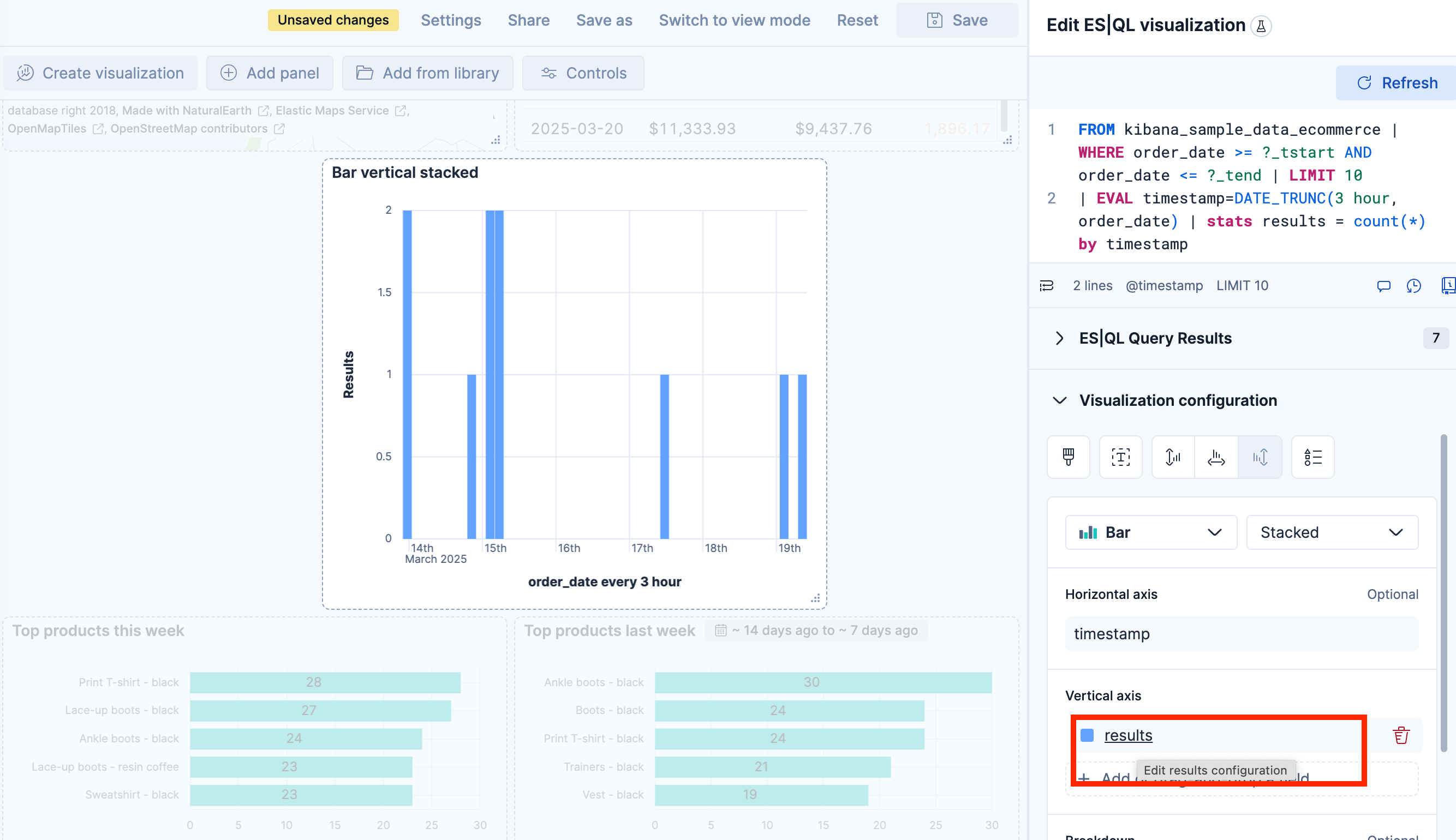

  1. Add a new panel from your dashboard.
    • Select Add in the application menu and, if required, New panel.
    • Select Add panel in the application menu.
    Tip
    If you haven't created a data view and you don't have a dashboard yet, the Dashboards page offers you the possibility to Try ES|QL right away. By selecting this option, a dashboard is created with an ES|QL visualization that you can interact with and configure using ES|QL.
  2. Select Create visualization (query) (Visualization (query) or ES|QL under Visualizations in earlier versions).
    An ES|QL editor appears and lets you configure your query and its associated visualization. The Suggestions panel can help you find alternative ways to configure the visualization.
    Tip
    Check the ES|QL reference to get familiar with the syntax and optimize your query.
  3. When editing your query or its configuration, run the query to update the preview of the visualization.
    Previewing an ESQL visualization
    Note
    When you edit the query and run it again, the visualization configuration persists as long as it is compatible with the query changes. Refer to Lens visualizations using ES|QL queries > Chart configuration persistence over ES|QL query update for more details.
  4. You can bind controls to your ES|QL visualizations in dashboards by creating ES|QL controls.
  5. Select Apply and close to save the visualization to the dashboard.

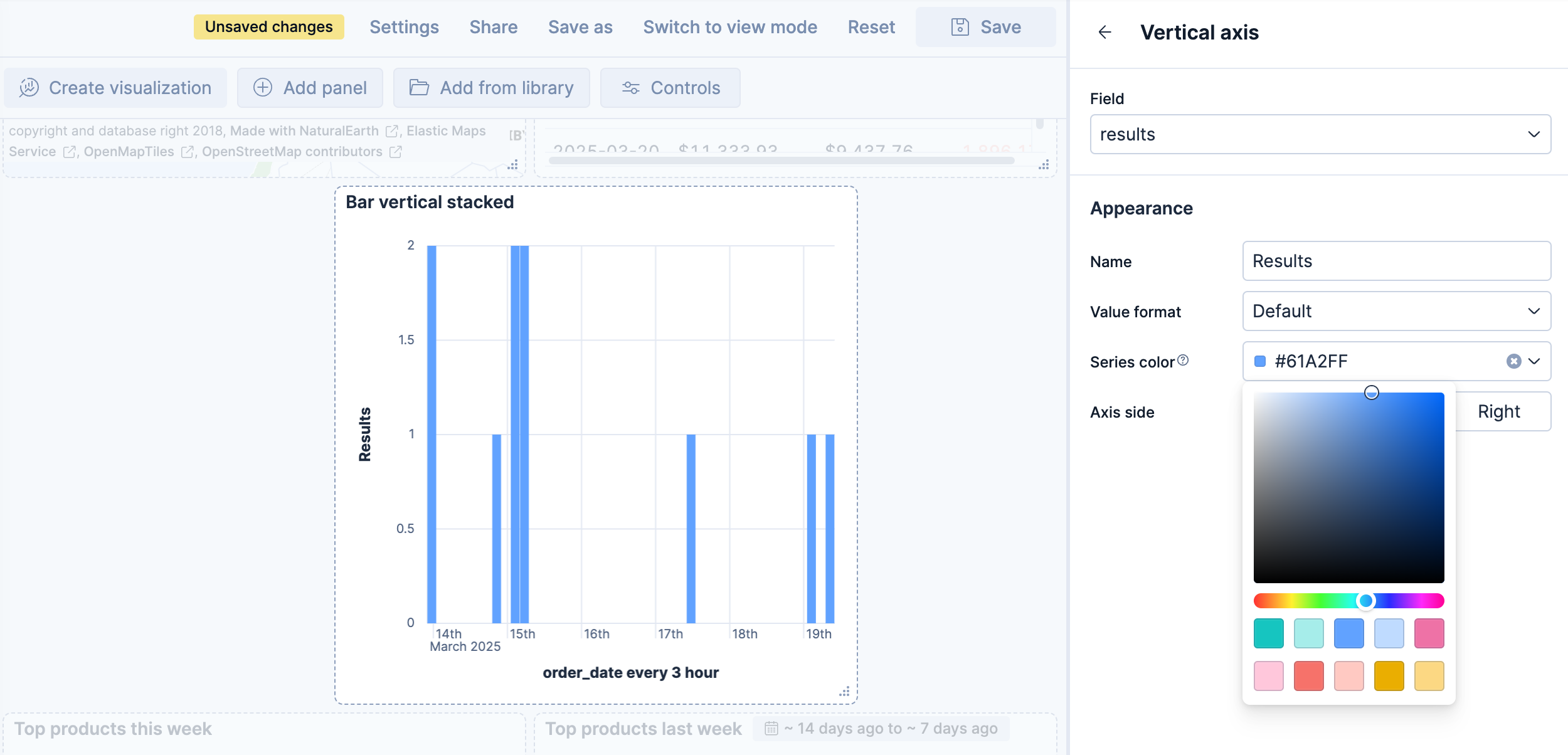

When editing an ES|QL visualization, you can customize the appearance of the chart. To do that:
  1. Click one of the fields representing an axis of the chart to open its details.
    Click on the axis field to open its details
  2. Define the appearance of your choice from the available options.
    Appearance customization options for ESQL charts
  3. Return to the previous menu, then Apply and close the configuration to save your changes.

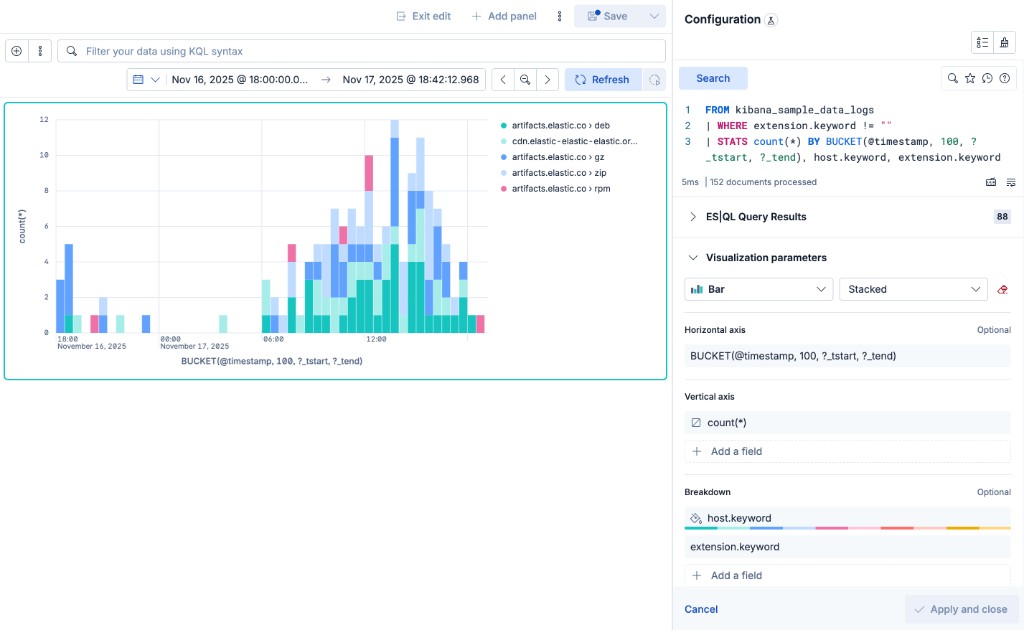

On bar, line, and area charts built from an ES|QL query, the Breakdown dimension can hold more than one field at the same time. Each unique combination of values is rendered as its own series, with the values joined by a › separator in the legend.
When the query groups a metric by more than one field, Kibana places the first field on the Horizontal axis and the remaining fields in the Breakdown dimension. For example, the following query counts web log events over time, broken down by host and file extension:
FROM kibana_sample_data_logs
| WHERE extension.keyword != ""
| STATS count(*) BY BUCKET(@timestamp, 100, ?_tstart, ?_tend), host.keyword, extension.keyword
In the resulting chart, the time buckets are placed on the Horizontal axis, while host.keyword and extension.keyword are combined in the Breakdown dimension. Each legend entry represents a unique combination, such as artifacts.elastic.co › deb or artifacts.elastic.co › gz.
Stacked bar chart of web log events over time, broken down by host and file extension
To add another field to the breakdown, select Add a field under Breakdown and choose a column from your query. You can also drag the fields inside the Breakdown dimension to change the order in which their values appear in the combined label.
