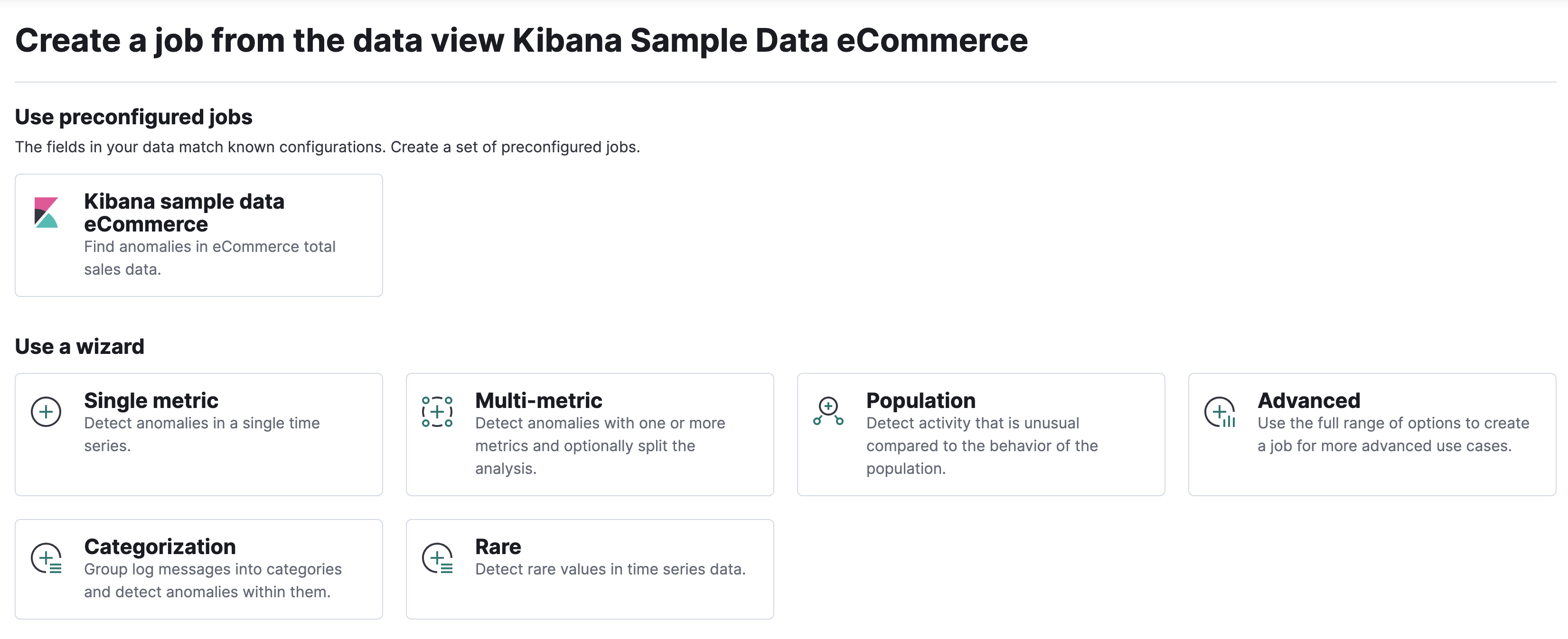

You can create anomaly detection jobs by using the create anomaly detection jobs API. Kibana also provides wizards to simplify the process, which vary depending on whether you are using the Machine Learning app, Elastic Security app or Observability apps. To open Anomaly Detection, find Machine Learning in the main menu, or use the global search field.
Create New Job
  • The single metric wizard creates simple jobs that have a single detector. A detector applies an analytical function to specific fields in your data. In addition to limiting the number of detectors, the single metric wizard omits many of the more advanced configuration options.
  • The multi-metric wizard creates jobs that can have more than one detector, which is more efficient than running multiple jobs against the same data.
  • The population wizard creates jobs that detect activity that is unusual compared to the behavior of the population.
  • The categorization wizard creates jobs that group log messages into categories and use count or rare functions to detect anomalies within them.
  • The advanced wizard creates jobs that can have multiple detectors and enables you to configure all job settings.
Kibana can also recognize certain types of data and provide specialized wizards for that context. For example, there are anomaly detection jobs for the sample eCommerce orders and sample web logs data sets, as well as for data generated by the Elastic Security and Observability solutions, Beats, and Elastic Agent Integrations. For a list of all the preconfigured jobs, see Supplied configurations.
