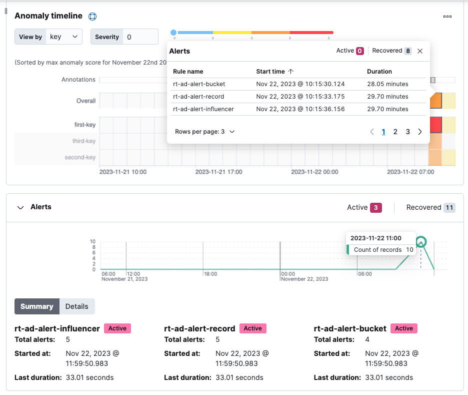

If you have Anomaly detection alert rules applied to an anomaly detection job and an alert has occurred for the rule, you can view how the alert correlates with the anomaly detection results in the Anomaly Explorer by using the Anomaly timeline swimlane and the Alerts panel. The Alerts panel contains a line chart with the alerts count over time. The cursor on the line chart is in sync with the anomaly swimlane making it easier to review anomalous buckets with the spike produced by the alerts. The panel also contains aggregated information for each alert rule associated with the job selection such as the total number of active, recovered, and untracked alerts for the selected job and time range. An alert context menu is displayed when an anomaly swimlane cell is selected with alerts in the chosen time range. The context menu contains the alert counters for the selected time buckets.
Alerts table in the Anomaly Explorer
