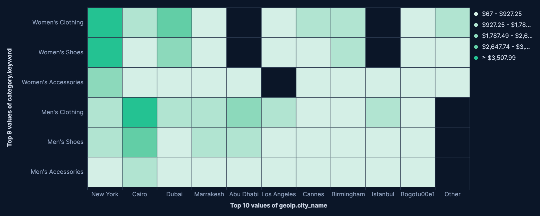

Heat map charts display data as a grid of colored cells, where each cell's color represents the magnitude of a value. They are ideal for visualizing patterns across two categorical or temporal dimensions, identifying correlations, and spotting anomalies in large datasets.

To build a heat map chart:
Lens is Kibana's main visualization editor. You can access it:
- From a dashboard: On the Dashboards page, open or create the dashboard where you want to add the visualization, then add a new visualization.
- From the Visualize library page by creating a new visualization.
New visualizations often start as Bar charts.
Using the Visualization type dropdown, select Heat map.
- Select the data view that contains your data.
- Configure the Horizontal axis dimension to define the columns of the heat map.
- Configure the Cell value dimension to define the metric that determines cell colors.
Optionally:
- Configure the Vertical axis dimension to define the rows of the heat map. Without a vertical axis, the heat map displays a single row of colored cells.
The chart preview updates to show a grid of colored cells. Cell colors represent the magnitude of the metric value. If the grid appears empty, verify that the axes have data for the current time range.

- Sales performance by product and region
Compare product sales across geographic regions:
- Example based on: Kibana Sample Data eCommerce
- Horizontal axis:
geoip.city_name(Top 10 values) - Vertical axis:
category.keyword(Top values) - Cell value:
Sum(taxful_total_price) - Color palette: Positive (sequential)
Create this chart using the API
This example uses two terms dimensions (city and product category) to create a category-versus-region grid, with cell color representing total revenue.

- Cities on the horizontal axis create one column per location, making geographic performance quick to scan.
- Product categories on the vertical axis form the rows, so each cell shows revenue for one category in one city.
sumoftaxful_total_pricecolors cells by total revenue rather than document count.
