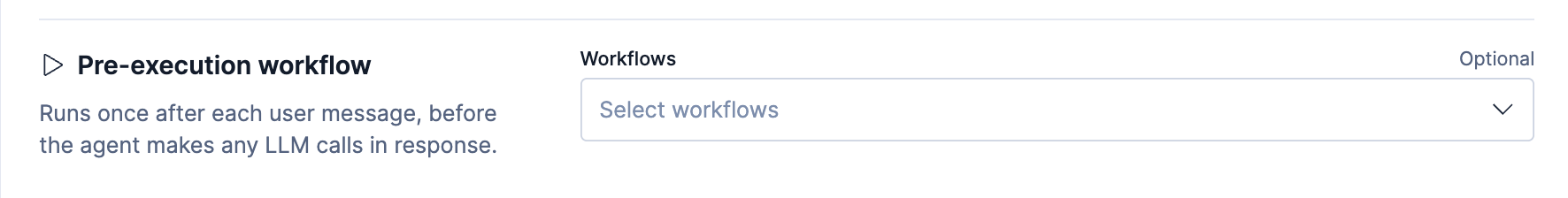

The following screenshot shows the Pre-execution workflow setting in the agent Settings view.
Edit agent settings flyout showing the Pre-execution workflow section with a workflow selector
