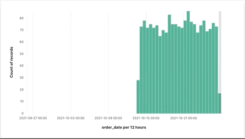

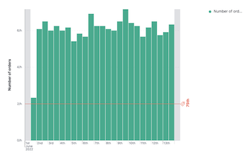

To analyze the data with a custom time interval, create a bar chart that shows you how many orders were made at your store every hour:
  1. From the Available fields list, drag Records to the workspace.
    The visualization editor creates a bar chart.
  2. To zoom in on the data, click and drag your cursor across the bars.
    Cursor clicking and dragging across the bars to zoom in on the data
  3. In the layer pane, click Count of records.
    1. Click Advanced.
    2. From the Normalize by unit dropdown, select per hour, then click Close.
      Normalize by unit converts Count of records into Count of records per hour by dividing by 24.
    3. In the Name field, enter Number of orders.
    4. Click Close.
  4. To hide the Horizontal axis label, open the Bottom Axis menu, then select None from the Axis title dropdown.
To identify the 75th percentile of orders, add a reference line:
  1. In the layer pane, click Add layer → Reference lines.
  2. Click Static value.
    1. Click Quick function, then click Percentile.
    2. From the Field dropdown, select total_quantity.
    3. In the Reference line value field, enter 75.
  3. Configure the Appearance options.
    1. In the Name field, enter 75th.
    2. To display the name, select Name from Text decoration.
    3. From the Icon decoration dropdown, select Tag.
    4. In the Color field, enter #E7664C.
  4. Click Close.
    Orders per day
  5. Click Save and return.

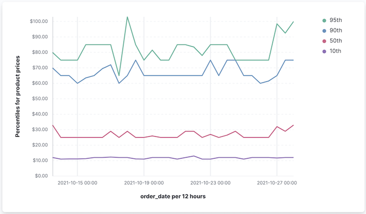

To analyze multiple series, create a line chart that displays the price distribution of products sold over time:
  1. Create a visualization.
    • Select Add → Create visualization (Visualization in earlier versions) in the application menu.
    • Click Create visualization in the dashboard toolbar.
  2. Open the Visualization type dropdown, then select Line.
  3. From the Available fields list, drag products.price to the workspace.
Create the 95th price distribution percentile:
  1. In the layer pane, click Median of products.price.
  2. Click the Percentile function.
  3. In the Name field, enter 95th, then click Close.

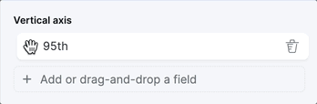

To copy a function, you drag it to the Add or drag-and-drop a field area within the same group. To create the 90th percentile, duplicate the 95th percentile:
  1. Drag the 95th field to Add or drag-and-drop a field for Vertical axis.
    Easily duplicate the items with drag and drop
  2. Click 95th [1], then enter 90 in the Percentile field.
  3. In the Name field enter 90th, then click Close.
  4. To create the 50th and 10th percentiles, repeat the duplication steps.
  5. Open the Left Axis menu, select Custom from the Axis title dropdown, then enter Percentiles for product prices in the Axis title field.
    Percentiles for product prices chart
  6. Click Save and return.

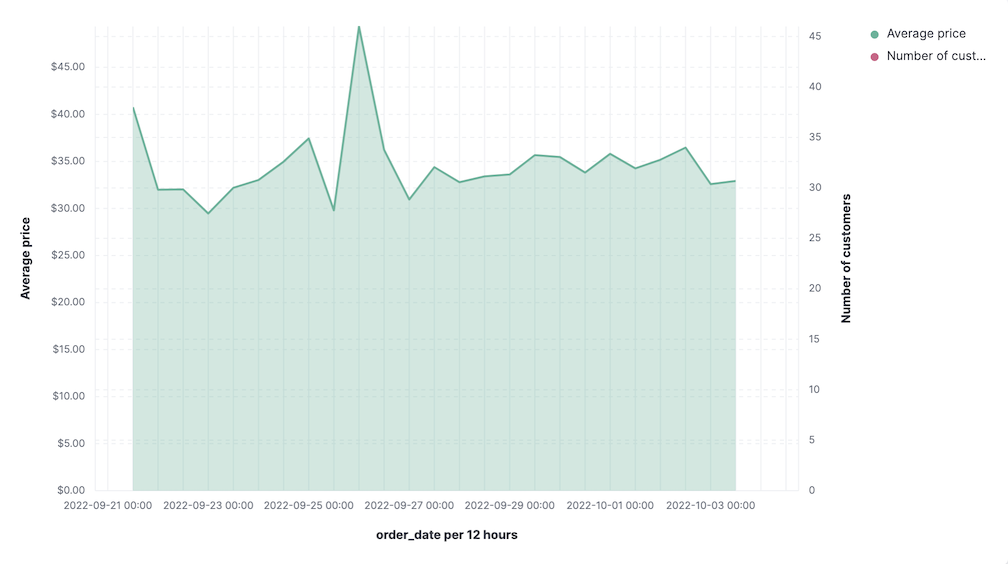

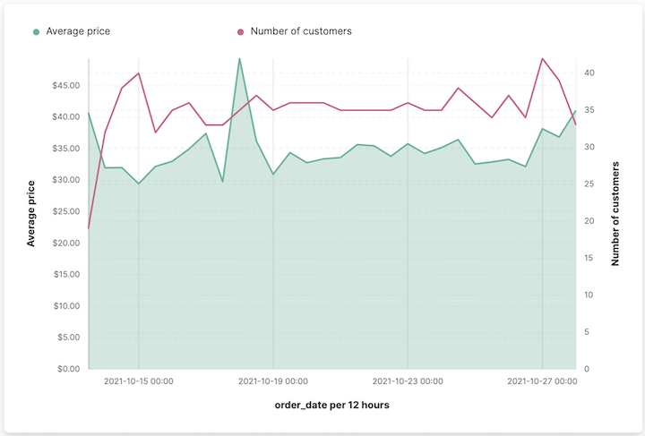

Add a layer to display the customer traffic:
  1. In the layer pane, click Add layer → Visualization → Line.
  2. From the Available fields list, drag customer_id to the Vertical Axis field in the second layer.
  3. In the layer pane, click Unique count of customer_id.
    1. In the Name field, enter Number of customers.
    2. In the Series color field, enter #D36086.
    3. Click Right for the Axis side, then click Close.
      Number of customers area chart in Lens
  4. From the Available fields list, drag order_date to the Horizontal Axis field in the second layer.
  5. To change the position of the legend, open the Legend menu, then select the Position arrow that points up.
    Layer visualization type menu

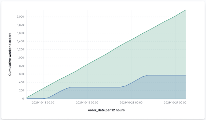

To determine the number of orders made only on Saturday and Sunday, create an area chart, then add it to the dashboard.
  2. Open the Visualization type dropdown, then select Area.
Configure the cumulative sum of store orders:
  2. In the layer pane, click Count of records.
  3. Click the Cumulative sum function.
  4. In the Name field, enter Cumulative weekend orders, then click Close.
Filter the results to display the data for only Saturday and Sunday:
  1. In the layer pane, click Add or drag-and-drop a field for Breakdown.
  2. Click the Filters function.
  3. Click All records, enter the following in the query bar, then press Return:
    • KQL — day_of_week : "Saturday" or day_of_week : "Sunday"
    • Label — Saturday and Sunday
      The KQL filter displays all documents where day_of_week matches Saturday or Sunday.
  4. Click Close.
  5. Open the Legend menu, then click Hide next to Visibility.
    Area chart with cumulative sum of orders made on the weekend

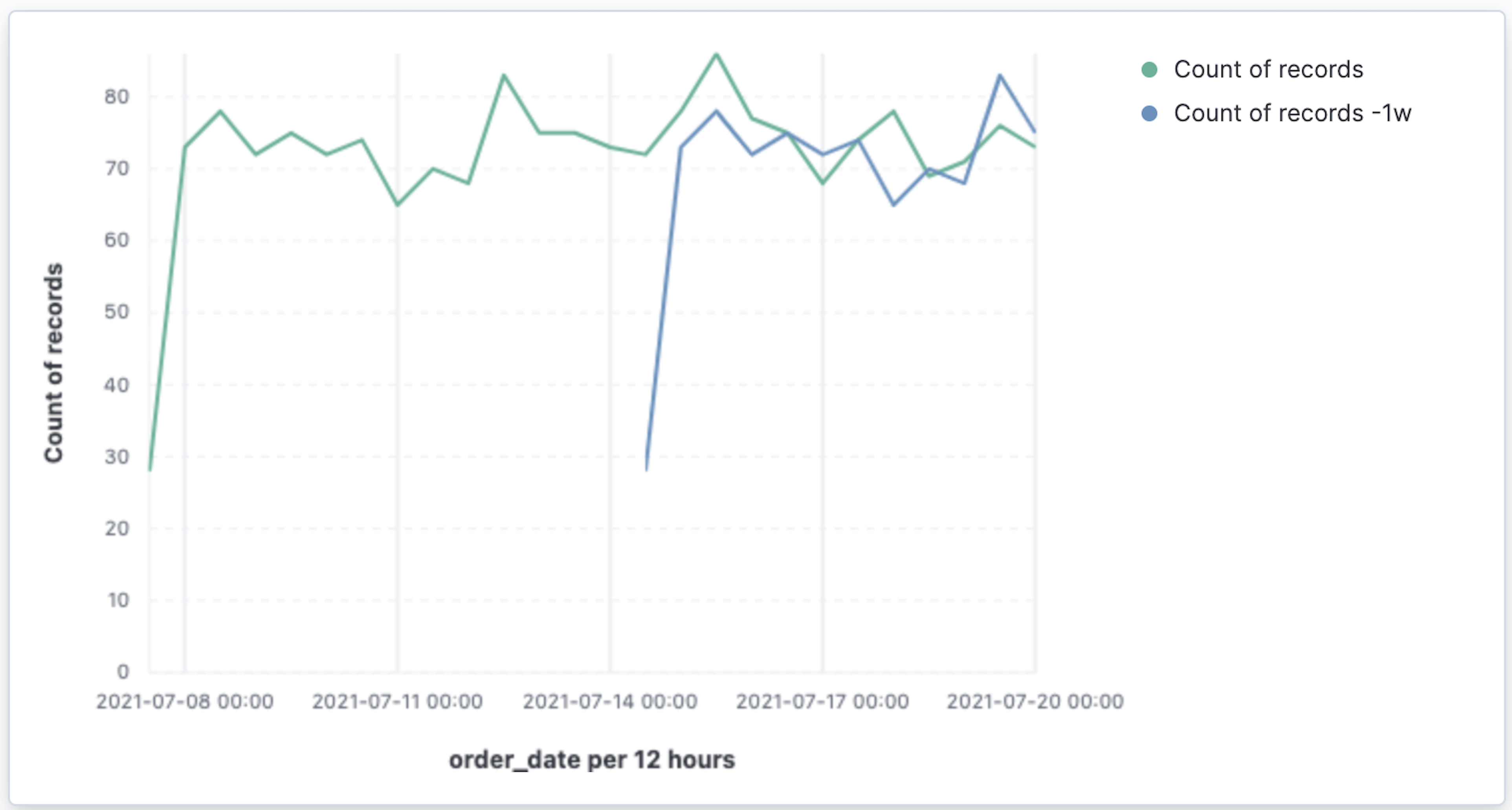

With Time shift, you can compare the data from different time ranges. To make sure the data displays correctly, choose a multiple of the date histogram interval when you use multiple time shifts. For example, you are unable to use a 36h time shift for one series, and a 1d time shift for the second series if the interval is days.
To compare two time ranges, create a line chart that compares the sales in the current week with sales from the previous week:
  3. From the Available fields list, drag Records to the workspace.
  4. To duplicate Count of records, drag Count of records to Add or drag-and-drop a field for Vertical axis in the layer pane.
To create a week-over-week comparison, shift Count of records [1] by one week:
  1. In the layer pane, click Count of records [1].
  2. Click Advanced, select 1 week ago from the Time shift dropdown, then click Close.
    To use custom time shifts, enter the time value and increment, then press Enter. For example, enter 1w to use the 1 week ago time shift.
    Line chart with week-over-week sales comparison
  3. Click Save and return.
Time shifts can be used on any metric. The special shift previous will show the time window preceding the currently selected one in the time picker in the top right, spanning the same duration. For example, if Last 7 days is selected in the time picker, previous will show data from 14 days ago to 7 days ago. This mode can’t be used together with date histograms.

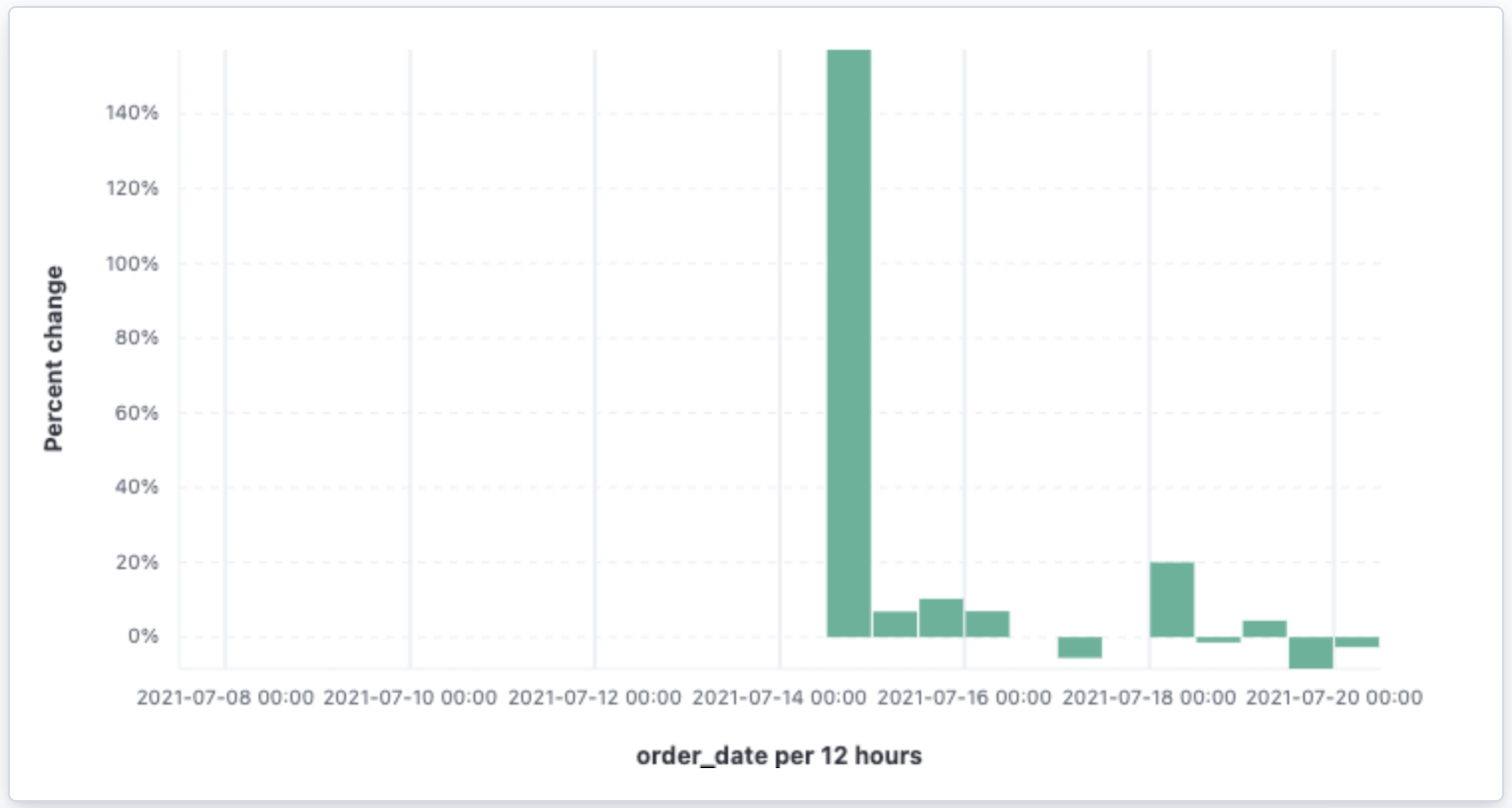

With Formula, you can analyze the percent change in your data from different time ranges.
To compare time range changes as a percent, create a bar chart that compares the sales in the current week with sales from the previous week:
  2. From the Available fields list, drag Records to the workspace.
  4. Click Formula, then enter count() / count(shift='1w') - 1 in the Formula field.
  5. In the Name field, enter Percent of change.
  6. From the Value format dropdown, select Percent, then enter 0 in the Decimals field.
  7. Click Close.
    Bar chart with percent change in sales between the current time and the previous week
  8. Click Save and return.
