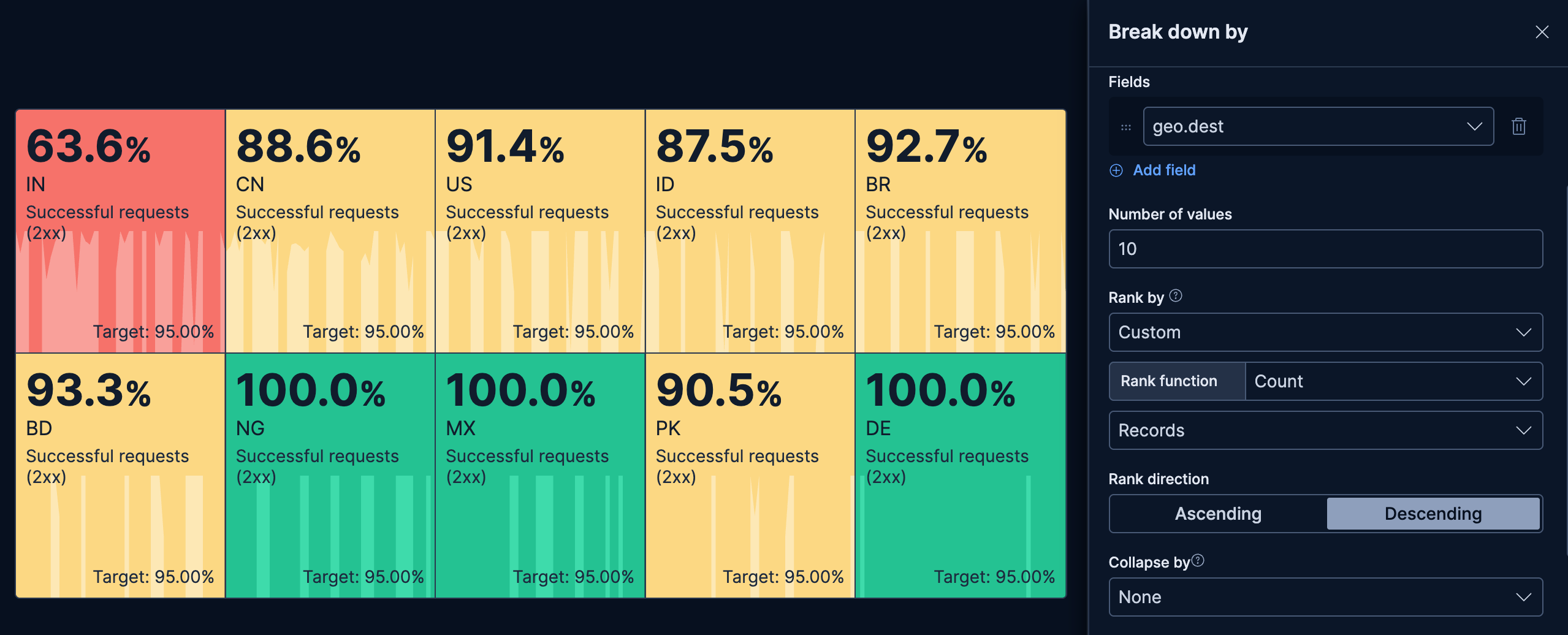

- Break down the metric into multiple tiles based on another dimension.
The chart preview updates to show a large numeric value. If you added a secondary metric, it appears below the primary value. If you added a breakdown dimension, separate tiles appear for each category.

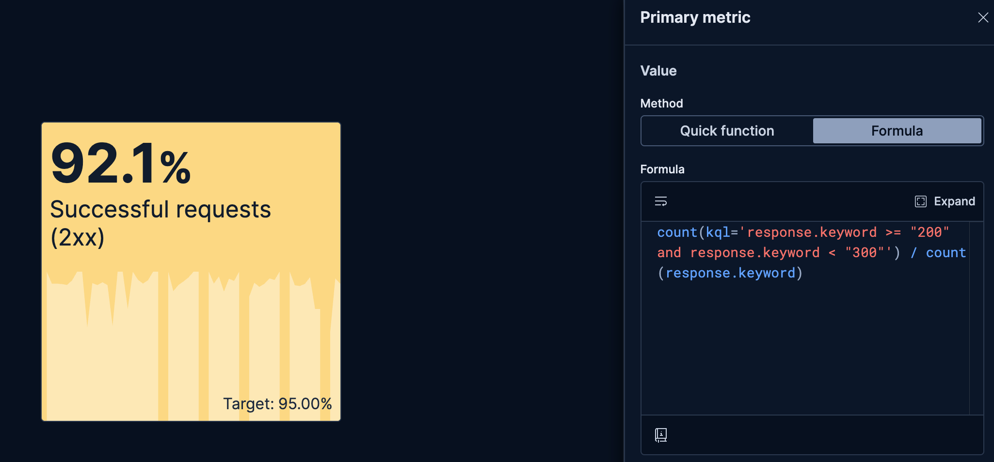

After building the chart with the point-and-click editor or an ES|QL query, customize its appearance for your data and audience:
- Use color wisely
- Assign colors that match your users' expectations and consider your specific context.
- Format for readability
- Round to an appropriate precision. Showing 1.2M is clearer than 1,234,567.89 for high-level metrics, but use more precision when small changes matter.
- Provide context
- Use titles and subtitles to explain what the metric shows. "45,234" is a number, but "Active Users" as a title gives it meaning, and "Last 24 hours" as a subtitle makes it unambiguous.
Refer to Metric chart settings for all metric chart configuration options. For panel sizing and layout guidance, refer to Organize dashboard panels.

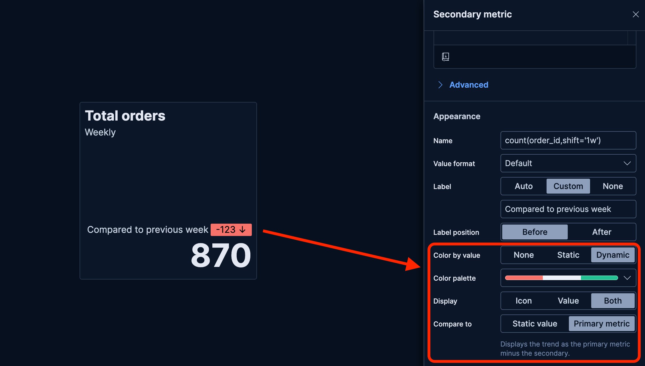

When creating Metric visualizations with numeric data, you can add trend indicators that compare your primary metric to a secondary value. This feature displays colored badges with directional arrows to help you quickly identify whether values are increasing, decreasing, or staying the same.
| Without trend | With trend |
To add trend indicators to your metric visualization:
Create a Metric visualization with a numeric primary metric.

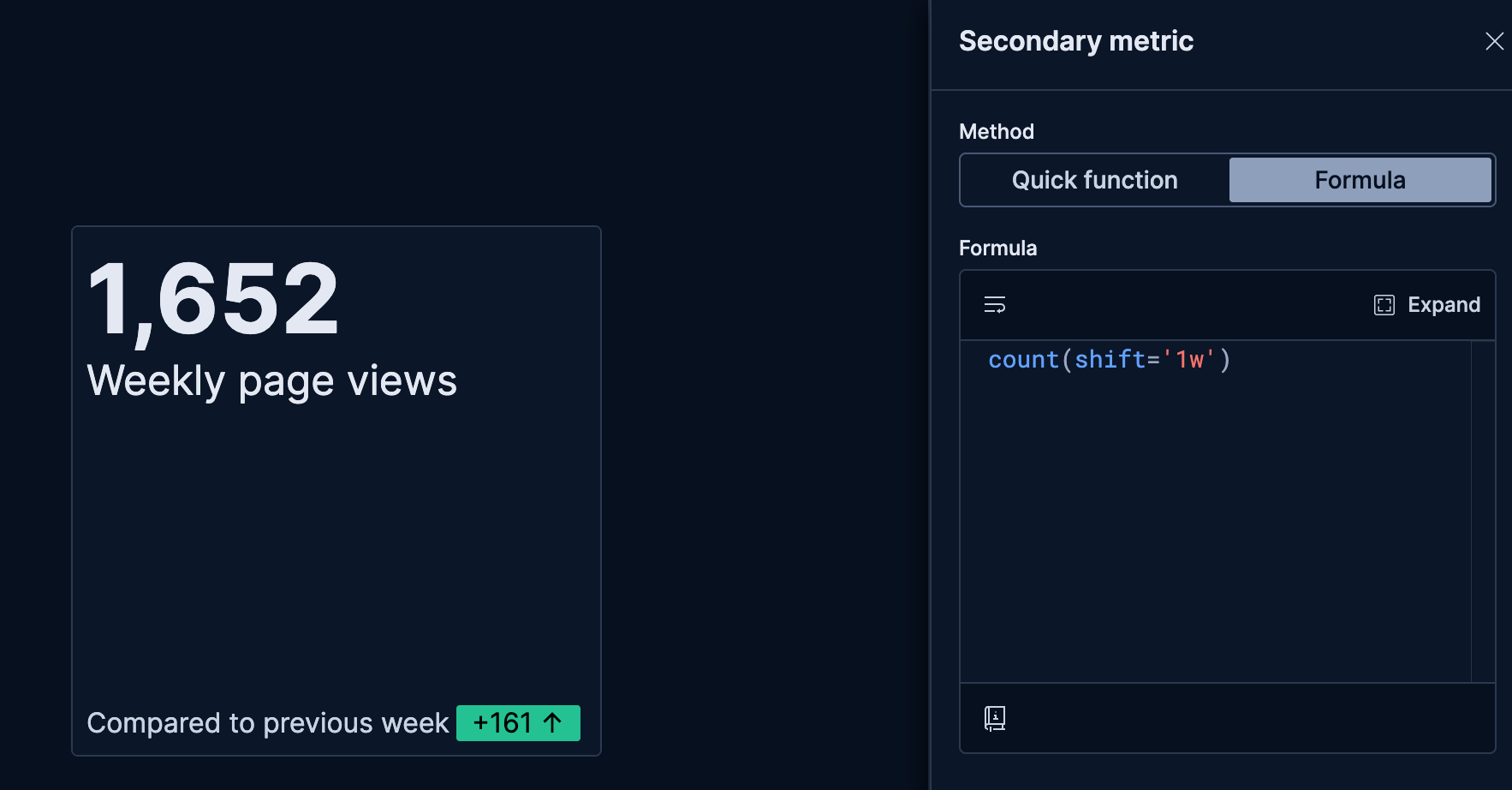

Add a secondary metric that represents the comparison value.
TipUse the
shiftparameter in formulas to compare current values against historical data. For example, if your primary metric is counting orders (based on anorder_idfield) for the current week, you can use thecount(order_id, shift='1w')formula to compare this week's count of orders to last week's count.In the secondary metric configuration, look for the Color by value option. The possible choices are:
- None: No trend indicators (default)
- Static: Shows the secondary metric as a badge with a fixed color that you select
- Dynamic: Enables both color coding and directional icons based on the comparison
Select Dynamic coloring. More options appear.
Choose a Color palette that matches how you'd like to represent the comparison.
Configure the Display option:
- Icon: Shows only directional arrows: ↑ for increase, ↓ for decrease, = for no change
- Value: Shows only the secondary metric value
- Both: Shows both the icon and value (default)
The secondary metric does not automatically compare with the primary metric. Define the value for Compare to:
Static value: Compares against a fixed baseline value that you specify
Primary metric: Compares the secondary metric directly against the primary metric by displaying the result of
Primary metric - Secondary metric. This option is only available when the primary metric is numeric.When you select this option, the secondary metric is automatically updated:
- The secondary metric label changes to Difference. You can edit this label.
- If you chose a Display option that shows a value, the secondary metric value is automatically updated to show the difference compared to the primary metric.
Apply your changes.
The metric visualization now shows the secondary metric as a comparison with a trend indicator.

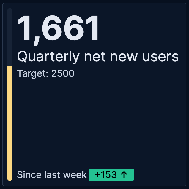

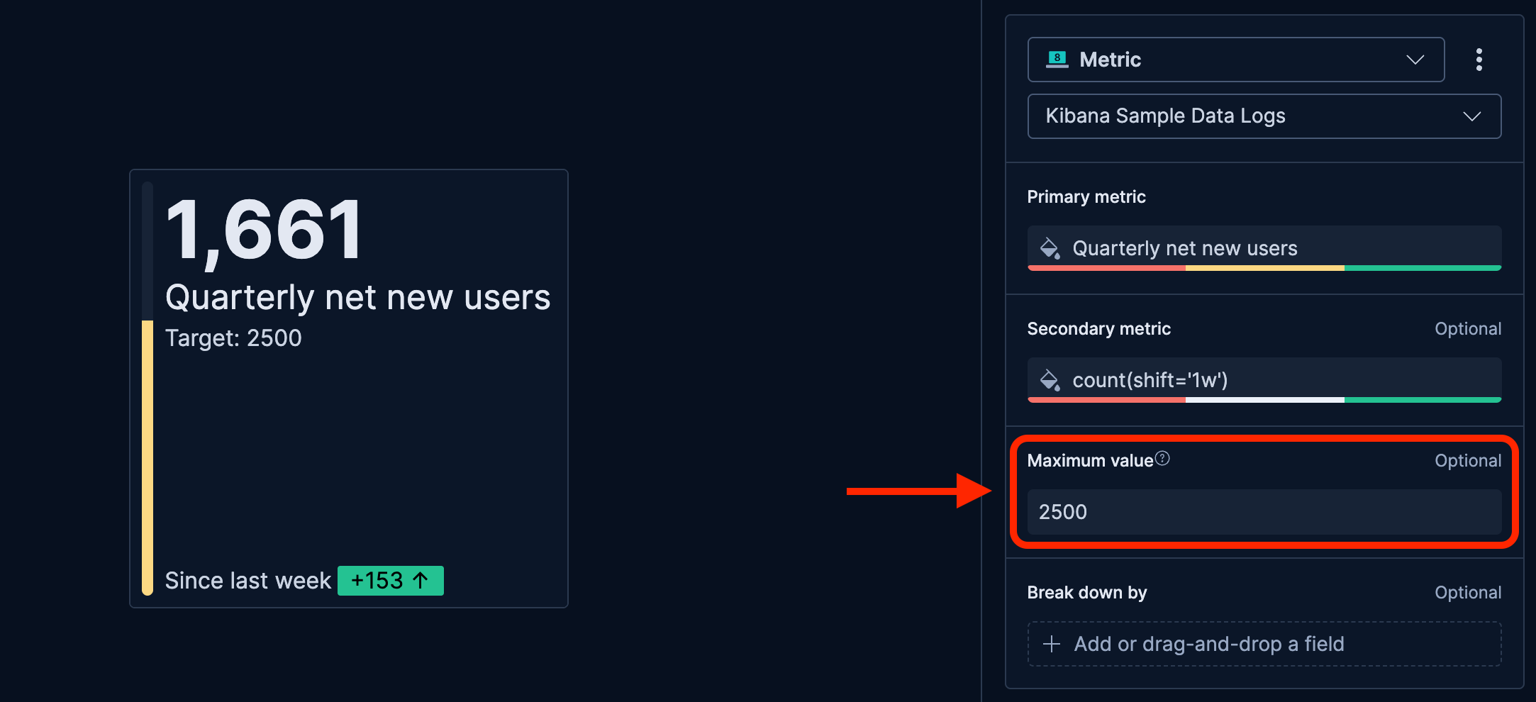

When creating Metric visualizations with numeric data, you can specify a maximum value to show progress toward a goal or capacity limit. When combined with the Bar background chart option, this displays a progress bar that visually represents how close your current metric is to reaching the maximum value.
| Without progress | With progress |
To add a progress bar to your metric visualization:
Optionally, customize the appearance of the metric. For example, add dynamic coloring to the primary metric to change colors based on progress: red when below 50%, yellow between 50-80%, and green above 80%. The progress bar will reflect this configuration once you set up a maximum value.
Add a maximum value that represents your goal or upper limit. The maximum value can be a static value, a function, or a formula based on your data.
Configure the Primary metric appearance to show the progress bar. Depending on the configuration of the primary metric, Lens might automatically set this option for you. If not, complete these steps:
- In the primary metric configuration, set the Background chart or Supporting visualization type to Bar. The name of this option depends on the version you're using.
- Optionally, change the orientation of the progress bar as needed.
Apply your changes.
The metric visualization now shows a progress bar indicating how close the current value is to the maximum.
You can combine progress bars with secondary metrics to show both progress toward a goal and trends over time. To do this, add both a maximum value and a secondary metric to your visualization.

This example creates a metric that shows the current count of users against a target of 2,500, with a progress bar and a weekly comparison badge.
These API request examples are kept up to date with the latest version of the APIs, so some fields might differ if you're using an earlier version. For a history of breaking changes, refer to the Kibana breaking changes or the Elastic Cloud Serverless breaking changes.
POST kbn://api/visualizations
"type": "metric",
"title": "Quarterly net new users",
"filters": [],
"query": { "expression": "" },
"metrics": [
"type": "primary",
"operation": "formula",
"formula": "count()",
"label": "Quarterly net new users",
"subtitle": "Target: 2500",
"background_chart": {
"type": "bar",
"max_value": { "operation": "formula", "formula": "2500" }
"color": {
"type": "dynamic",
"range": "absolute",
"steps": [
{ "lt": 1000, "color": "#f6726a" },
{ "gte": 1000, "lt": 2000, "color": "#fcd883" },
{ "gte": 2000, "color": "#24c292" }
"type": "secondary",
"formula": "count(shift='1w')",
"label": "Since last week",
"compare": { "to": "primary", "palette": "compare_to", "icon": true, "value": true },
"color": { "type": "none" }
"data_source": {
"type": "data_view_spec",
"index_pattern": "kibana_sample_data_logs",
"time_field": "timestamp"
"styling": {
"primary": { "position": "top", "labels": { "alignment": "left" }, "value": { "sizing": "auto", "alignment": "left" } },
"secondary": { "label": { "visible": true, "placement": "before" }, "value": { "alignment": "left" } }
background_chart.type: "bar"renders a horizontal progress bar behind the metric value.max_valuewithformula: "2500"sets the target. The bar fills proportionally as the metric approaches this value. You can also useoperation: "static_value", value: 2500for a plain number.dynamiccolor withabsolutethresholds changes the tile color as the metric progresses — red below 1,000, yellow between 1,000 and 2,000, and green at or above 2,000.

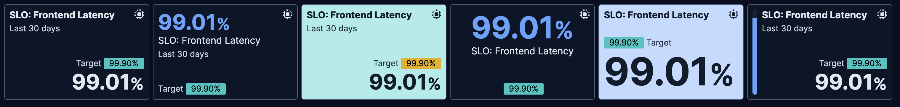

- Appearance
Define the formatting of the primary metric, including:
- Name: By default, the chart uses the function or formula as title. It's a best practice to customize this with a meaningful title.
- Value format: Choose to display the metric as number, percent, bytes, bits, duration, or with a custom format that you can define.
- Icon decoration: Add an icon to the top right corner of the chart.
- Background chart or supporting visualization Type (depending on your version): Options include:
- None: Show a unified background.
- Line: Show a light line chart in the background.
- Bar: Show a progress bar that represents the current value of the chart measured against the Maximum value defined for the chart.
- Bar orientation: Options include Vertical and Horizontal.

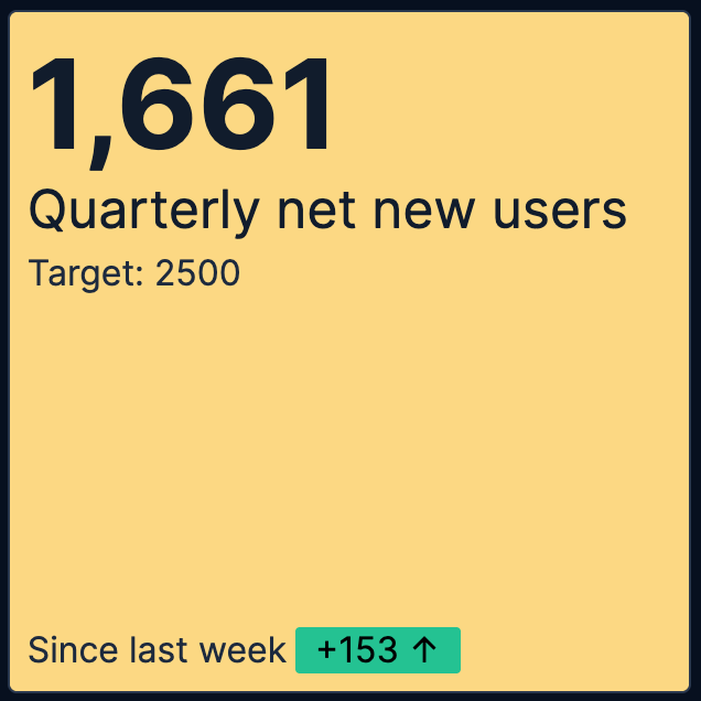

- Color mode or Color by value (depending on your version): Apply colors to the chart. Choose between Static for a unique color and Dynamic for using different colors based on the metric's value. By default, the color applies to the chart's background.
- Static: The color always remains the same and is independent from the metric's value.
- Color: Pick a color and its opacity.
- Dynamic: Define colors to apply to the chart based on the value of the primary metric.
- Dynamic color mapping: Use the color palette to define custom color ranges.
- Value
An optional additional value that provides context or enables comparisons. Common uses include:
- Time-shifted values to show trends (for example, last week's sales compared to this week)
- Different aggregations on the same data (for example, showing both average and median response times)
- Related metrics for context (for example, showing total count alongside an average)
Advanced settingsDepending on the data you defined, several options allow you to apply additional filtering to the data taken into account to compute the final value to show.
Based on the type of visualization you're creating, only some of the following options can be available:
- Normalize by unit: Normalize the metric values to show per unit of time.
- Filter by: Specify a query.
- Reduced time range: Reduce the time range specified on the dashboard's time filter by the specified duration.
- Time shift: Shift the time range by the specified duration. This is useful if the value should use a different time range than the one selected on the dashboard.
- Hide zero values: Don't show values equal to zero. This option is on by default.
- Appearance
Define the formatting of the secondary metric, including:
- Label: Define the label displayed next to the secondary metric. By default, the Name shows. You can instead show a Custom value or hide it by selecting None.
- Label position: Choose to show the label Before or After the metric.
- Color by value: Apply colors to the chart. Choose between None, Static for a unique color and Dynamic for using different colors based on the metric's value. This option allows you to use the secondary metric as a comparison point to highlight trends. Refer to Build metric charts with Kibana > Show trends in Metric charts for more details.
- Value
An optional reference value that defines the upper bound for your metric. Specifying a maximum lets you show a progress bar in your metric chart. The progress is represented by your primary metric's value on a scale of 0 to the defined maximum value. This option is useful for showing progress toward goals or capacity limits.
NoteIf a progress bar doesn't show after setting a maximum value, manually set the primary metric's Background chart option to Bar.
- Appearance
Define the formatting of the maximum value, including:
- Name: It's a best practice to customize this with a readable title.
- Data
Split your metric into multiple tiles based on a categorical field. Each unique value creates its own tile, allowing you to compare metrics across regions, products, time periods, or any other dimensions. It supports the following functions:
- Top values: Show the most common values of a field.
- Field: Select the field to group by. You can add up to 4 fields to create multi-term groups. When multiple fields are selected, each group represents a unique combination of values across those fields. You can reorder the fields by dragging them to change their priority.
- Number of values: How many top values to display. The default number of values depends on your environment:
Defaults to 9. -
Defaults to 5 for the first Top values dimension added to the chart and 3 for each additional one.
- Rank by: Specifies the dimension the top values are ranked by. Available options:
- Count of records: Rank by the number of documents containing each value. This is the default when a metric is defined.
- Alphabetical: Rank by the term key alphabetically. This is the default when no metric is defined.
- Rarity: Find terms that appear in very few documents, using a rare terms aggregation. You can configure the Max doc count per term to set the maximum number of documents a term can appear in to be considered rare (default: 1, max: 100). Available for single-field terms only, and not for floating-point numeric fields (
float,double,half_float, andscaled_float). - Significance: Find statistically unusual terms compared to the overall data set, using a significant terms aggregation. Only available for
keywordfields and single-field terms. - Custom: Define a custom metric aggregation to rank by (for example, rank by the sum of a numeric field rather than by count).
- Rank direction: Ascending or descending order. Disabled when Rank by is set to Rarity or Significance.
Advanced settingsSeveral advanced options allow you to refine the behavior of the breakdown:
- Include documents without the selected field: Off by default.
- Group remaining values as "Other": On by default.
- Enable accuracy mode: This option improves results for high-cardinality data, but increases the load on the Elasticsearch cluster.
- Include values: Values from the dimension to always include, even if they aren't among the top values. You can enter exact values or a regular expression.
- Exclude values: Values from the dimension to always exclude. You can enter exact values or a regular expression.
- Date histogram: Group data into time-based buckets.
- Field: Select the date field to use for the time-based grouping.
Include empty rows: Include buckets that contain no matching documents. Existing saved visualizations keep their configured setting.
For new visualizations, this option is: - On by default for tables, line charts, and area charts
- Off by default for bar charts, heat maps, pie charts, treemap charts, mosaic charts, waffle charts, metric charts, and tag clouds
When you switch visualization or series type, Lens applies the default for the new type. If you switch back to the visualization type you saved, Lens restores the saved setting.
This option is on by default for all visualization types.
Bind to global time picker: Associate the selected field to the Lens or dashboard main time selector.
Minimum interval: Define the time interval for aggregating the data. For example,
30s,20m,24h,2d,1w,1MDrop partial intervals: Exclude incomplete intervals from the data. This option is off by default.
- Intervals: Create numeric ranges for continuous data by grouping a numeric field into buckets.
- Field: Select the numeric field to create intervals from.
- Intervals granularity: Use the slider to control how many intervals to create. Kibana divides the field into evenly spaced intervals (incremented by 10, 5, or 2) between the field's minimum and maximum values. The minimum granularity is 1, and the maximum is set by the
histogram:maxBarsadvanced setting. - Create custom ranges: Define your own ranges with specific lower and upper bounds and optional labels, instead of using the automatic granularity.
- Include empty rows: Include intervals that contain no matching documents. Existing saved visualizations keep their configured setting.
- Filters: Define custom KQL filters. Each filter creates one group from the documents that match its query.
- Collapse by: Aggregate all metric values that share the same value for this dimension into a single number, removing it as an independent grouping. Available aggregation methods:
Sum,Min,Max, orAverage.
- Appearance
Define the formatting of the broken down view of the metric, including:
- Name: It's a best practice to customize this with a meaningful title.
- Layout columns: The number of columns used to lay out the various tiles of your metric chart.

- Ratio of successful requests
Display the percentage of successful requests on a monitoring dashboard:
- Title: "Successful requests (2xx)"
- Primary metric:
count(kql='response.keyword >= "200" and response.keyword < "300"') / count(response.keyword)- Value format:
Percent - Color mode or Color by value:
Dynamic(green when above 95%, yellow between 75% and 95%, red when below) - Background chart or Supporting visualization: "Line" to show evolution over time
- Value format:
- Secondary metric:
0.95formula- Value format:
Percent - Label: Custom, set to
Target:
- Value format:
Create this chart using the API
This example creates a metric that calculates the ratio of successful HTTP requests using a formula with a KQL filter, and adds a fixed target value as a secondary metric.

- Value format:
- Secondary metric:
0.95formula- Label: Custom, set to
Target: - Value format:
Percent
- Break down by:
geo.dest- Number of values:
10 - Rank by:
Custom>Count>Recordsto get countries generating most requests
- Number of values:
This example builds on the previous one by adding a breakdown that splits the success rate into one tile per destination country.
"type": "metric",
"title": "Successful requests per origin",
"filters": [],
"metrics": [
"type": "primary",
"formula": "count(kql=response.keyword >= \"200\" and response.keyword < \"300\") / count(response.keyword)",
"label": "Successful requests (2xx)",
"format": { "type": "percent", "decimals": 1, "compact": true },
"background_chart": { "type": "trend" },
"color": {
"type": "dynamic",
"steps": [
{ "lt": 0.75, "color": "#f6726a" },
{ "gte": 0.75, "lt": 0.95, "color": "#fcd883" },
{ "gte": 0.95, "color": "#24c292" }
"apply_color_to": "background"
"formula": "0.95",
"format": { "type": "percent", "decimals": 2 },
"label": "Target:",
"breakdown_by": {
"operation": "terms",
"fields": ["geo.dest"],
"limit": 10,
"rank_by": { "type": "custom", "operation": "count", "field": "___records___", "direction": "desc" },
"columns": 5
"data_source": {
"styling": {
"secondary": { "label": { "visible": true, "placement": "before" }, "value": { "alignment": "right" } }
breakdown_bysplits the metric into separate tiles, one per destination country.- Shows the top 10 countries by document count.
rank_bywithfield: "___records___"ranks tiles by document count, ensuring the countries with the most traffic appear first.columns: 5arranges the tiles in a 5-column grid.

- Website traffic with trend
Monitor current traffic and show whether it's increasing or decreasing compared to the previous period:
- Title: "Weekly page views"
- Primary metric:
count()(current week's page views) - Secondary metric:
count(shift='1w')(previous week's page views)- Color mode or Color by value: Dynamic coloring
- Compare to: Primary metric
- Display: Both icon and value
- Label: "Compared to previous week"
- Color palette: Green for increases (more traffic is positive)
This example creates a metric that counts page views and compares the current value to the previous week using a time-shifted formula.
"type": "metric",
"title": "Weekly page views",
"filters": [],
"metrics": [
"type": "primary",
"empty_as_null": true,
"label": "Page views",
"format": {
"type": "number",
"decimals": 0,
"compact": true
"label": "Compared to previous week",
"compare": {
"to": "primary",
"icon": true,
"value": true
"data_source": {
"styling": {
"secondary": {
compact: truedisplays large numbers in abbreviated form (for example, 1.2K).- The secondary metric appears below the primary value as a comparison badge.
shift='1w'runs the same count query offset by one week.compare.to: "primary"displays the difference from the primary rather than the raw secondary value.palette: "compare_to"colors the badge green for increases and red for decreases.icon: trueadds a directional arrow (↑ or ↓).
When compare.to: "primary" is first applied, Kibana sets the secondary metric Label to Auto, which displays Difference. To use a custom label, select the secondary metric in the Lens editor, set Label to Custom, and type your text. Once saved, the custom label is stored in the label field of the payload and preserved in exports.
