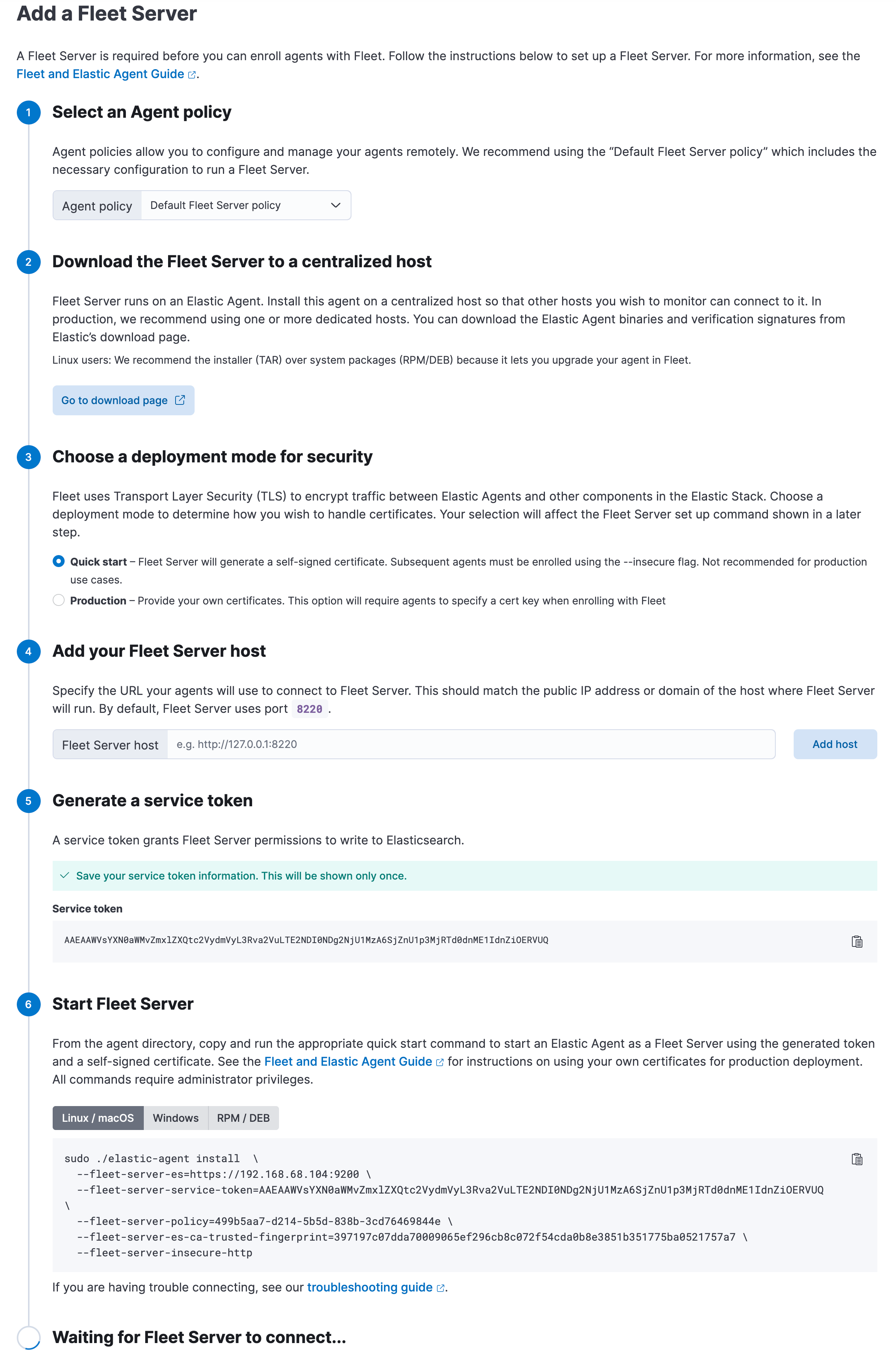

Click the Agents tab and follow the in-product instructions to add a Fleet server:
Notes:
Choose Quick Start if you want Fleet to generate a Fleet Server policy and enrollment token for you. The Fleet Server policy will include a Fleet Server integration plus a system integration for monitoring Elastic Agent. This option generates self-signed certificates and is not recommended for production use cases.
Choose Advanced if you want to either:
- Use your own Fleet Server policy. You can create a new Fleet Server policy or select an existing one. Alternatively you can create a Fleet Server policy without using the UI, and select the policy here.
- Use your own TLS certificates to encrypt traffic between Elastic Agents and Fleet Server. To learn how to generate certs, refer to Configure SSL/TLS for self-managed Fleet Servers.
It’s recommended you generate a unique service token for each Fleet Server. For other ways to generate service tokens, see

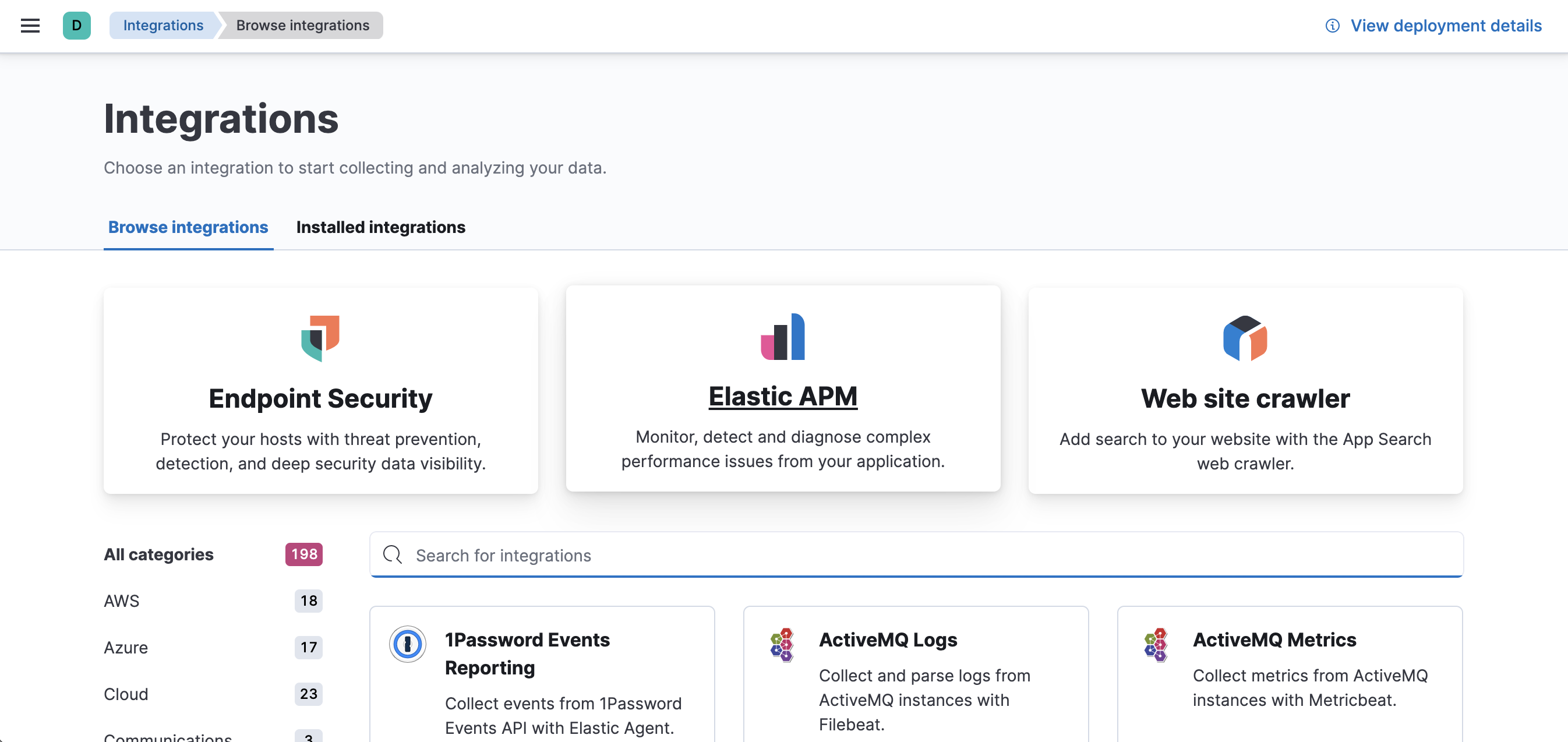

In Kibana, find Integrations in the main menu or use the global search field.
Select Elastic APM.

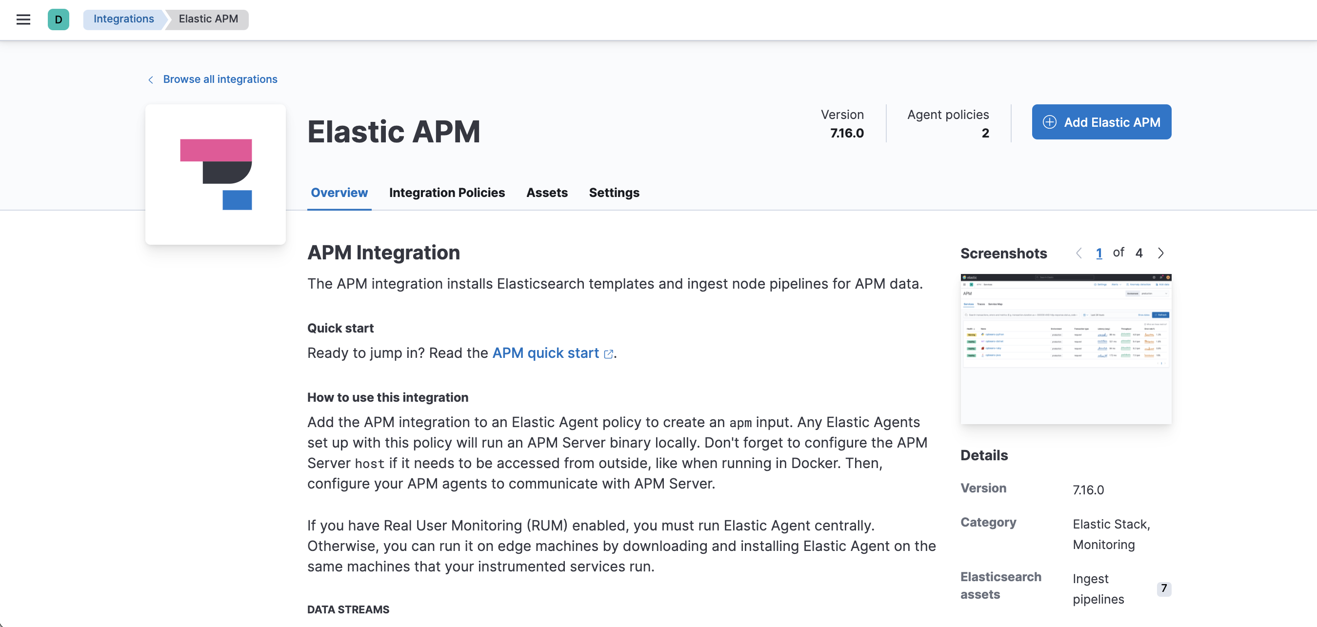

Click Add Elastic APM.
On the Add Elastic APM integration page, define the host and port where APM Server will listen. Make a note of this value—you’ll need it later.
TipUsing Docker or Kubernetes? Set the host to
0.0.0.0
to bind to all interfaces.Under Agent authorization, set a Secret token. This will be used to authorize requests from APM agents to the APM Server. Make a note of this value—you’ll need it later.
Click Save and continue. This step takes a minute or two to complete. When it’s done, you’ll have an agent policy that contains an APM integration policy for the configuration you just specified.
To view the new policy, click Agent policy 1.
Any Elastic Agents assigned to this policy will collect APM data from your instrumented services.
