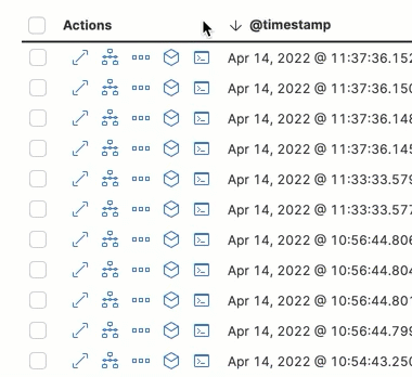

To add alerts to a new case:
  1. Do one of the following:
    • To add a single alert to a case, select the More actions menu () in the Alerts table or Take action in the alert details flyout, then select Add to a new case.
    • To add multiple alerts, select the alerts, then select Add to a new case from the Bulk actions menu.

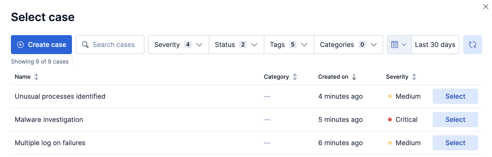

To add alerts to an existing case:
    • To add a single alert to a case, select the More actions menu () in the Alerts table or Take action in the alert details flyout, then select Add to existing case.
    • To add multiple alerts, select the alerts, then select Add to an existing case from the Bulk actions menu.
  2. From the Select case dialog box, select the case to which you want to attach the alert. A confirmation message is displayed with an option to view the updated case. Click the link in the notification or go to the Cases page to view the case’s details.
    Note
    If you attach the alert to a case that has been configured to sync its status with associated alerts, the alert’s status updates any time the case’s status is modified.
Select case dialog listing existing cases
