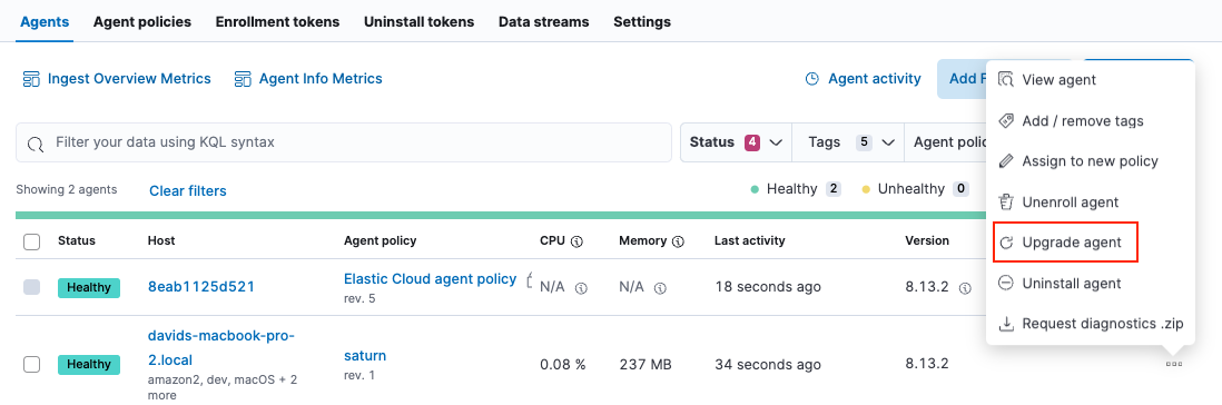

Upgrade a single Elastic Agentedit
On the Agents tab, agents that can be upgraded are identified with an Upgrade available indicator.
You can also click the Upgrade available button to filter the list agents to only those that currently can be upgraded.
From the Actions menu next to the agent, choose Upgrade agent.
In the Upgrade agent window, select or specify an upgrade version and click Upgrade agent.
In certain cases the latest available Elastic Agent version may not be recognized by Kibana. For instance, this occurs when the Kibana version is lower than the Elastic Agent version. You can specify a custom version for Elastic Agent to upgrade to by entering the version into the Upgrade version text field.

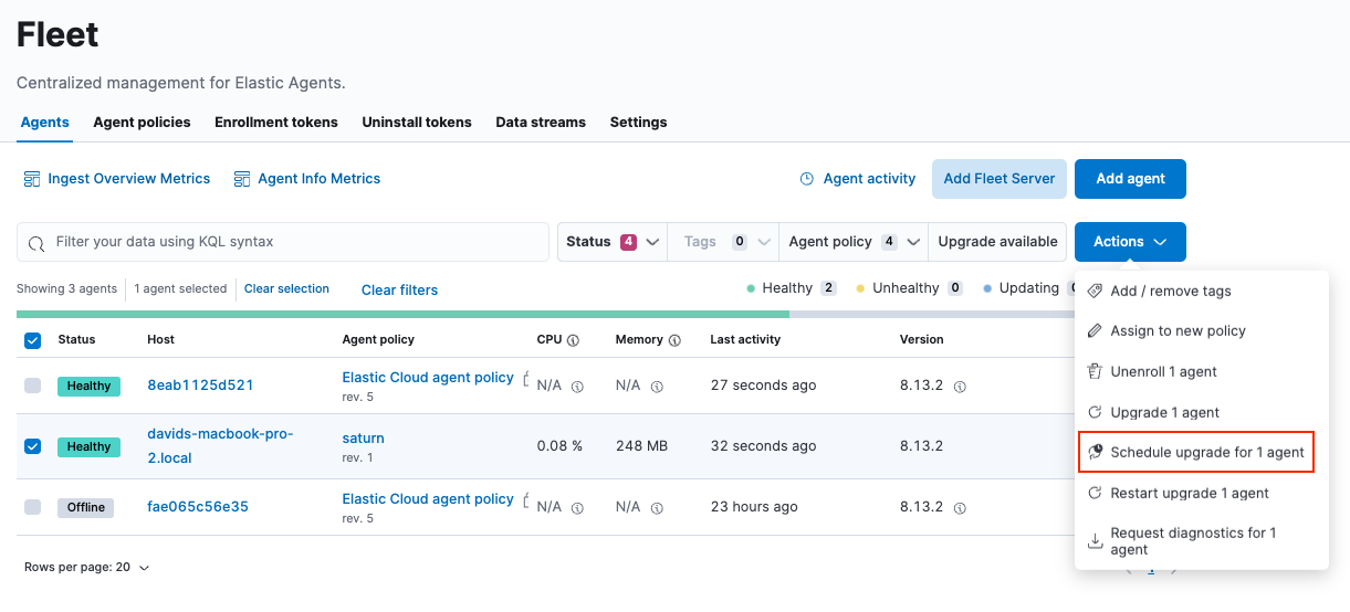

Schedule an upgradeedit
- On the Agents tab, select one or more agents, and click Actions.
From the Actions menu, choose to schedule an upgrade.
If the schedule option is grayed out, it may not be available at your subscription level. For more information, refer to Elastic Stack subscriptions.
- In the Upgrade window, select an upgrade version.
- Select a maintenance window. For more information, refer to Do a rolling upgrade of multiple Elastic Agents.
- Set the date and time when you want the upgrade to begin.
- Click Schedule.

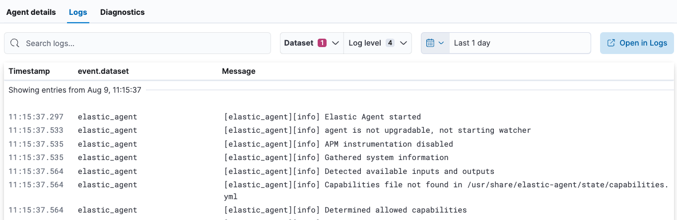

If an upgrade appears to have stalled, you can restart it.
If an upgrade fails, you can view the agent logs to find the reason:
- In Fleet, in the Host column, click the agent’s name.
- Open the Logs tab.
Search for failures.
