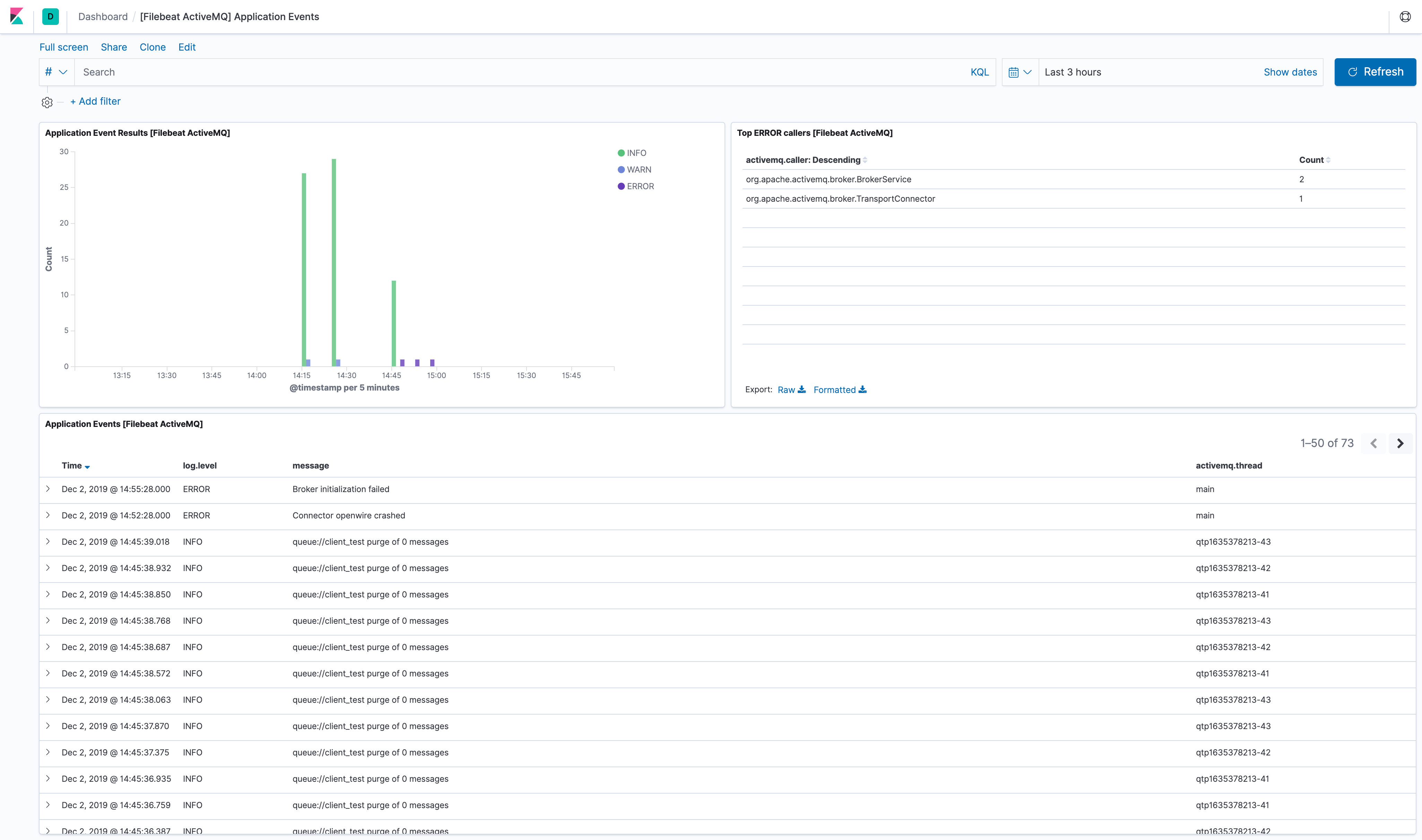

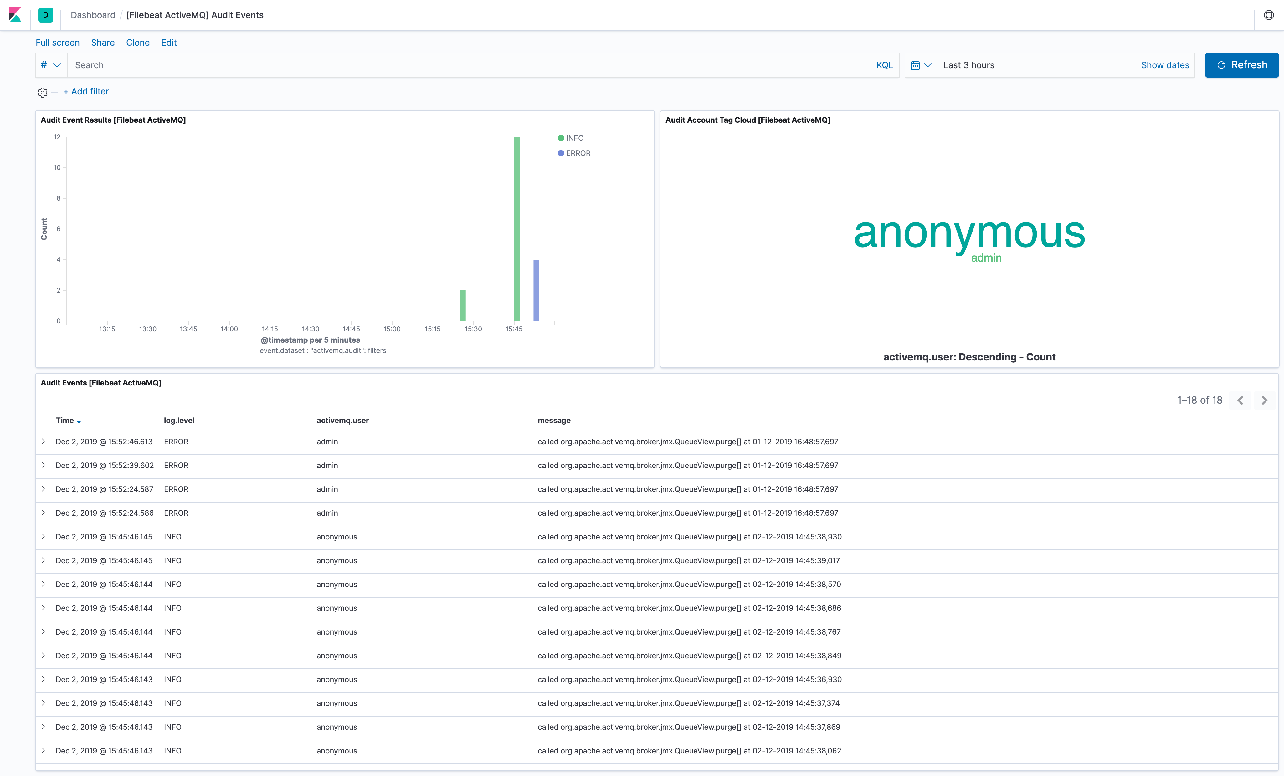

Dashboardsedit
The ActiveMQ module comes with several predefined dashboards for application and audit logs. For example:
filebeat activemq application events
filebeat activemq audit events
