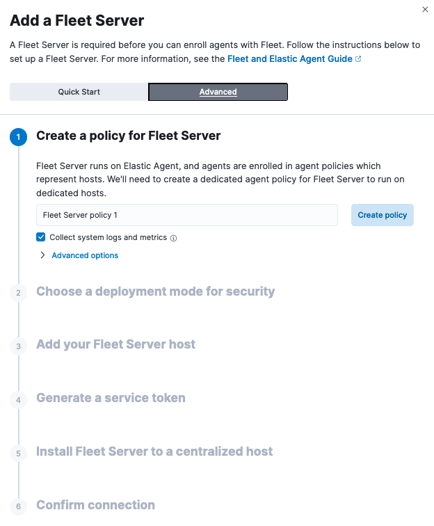

- Click the Agents tab.
- Click Add Fleet Server.
This will open in-product instructions for adding a Fleet Server using one of two options. Choose Advanced.
Follow the in-product instructions to add a Fleet Server.
- Choose the policy name for this deployment.
Choose Production as your deployment mode.
Production mode is the fully secured mode where TLS certificates ensure a secure communication between Fleet Server and Elasticsearch.
- Select the Fleet Server host that was identified earlier. Click Add host.
- A Service Token is required so the Fleet Server can write data to the connected Elasticsearch instance. Click Generate service token and copy the generated token.
- Copy the installation instructions provided in Kibana, which include some of the known deployment parameters.
