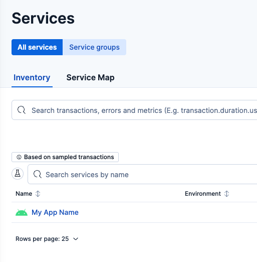

After your app has sent telemetry data, either manually or automatically, view it in Kibana by navigating to Applications, Service Inventory, or by searching for Service Inventory in the global search field. You should find your application listed there.
Services

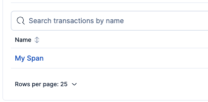

When you open it, go to the Transactions tab, where you should see your app's "outermost" spans listed.
Transactions tab

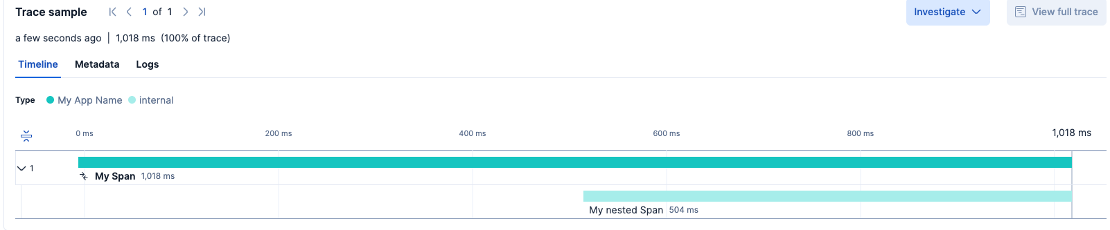

After clicking on the span, you should see it in detail.
Trace sample
