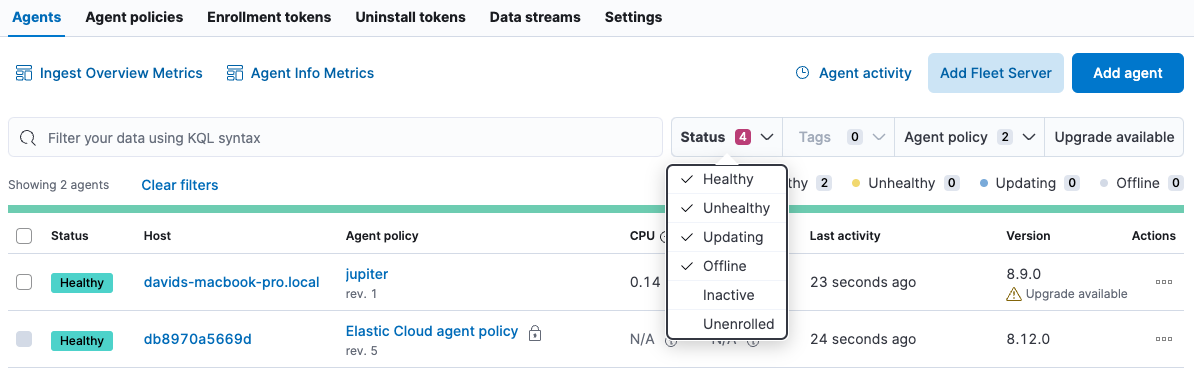

To view the overall status of your Fleet-managed agents, in Kibana, go to Management → Fleet → Agents.
The Agents tab in Fleet displays a maximum of 10,000 agents, shown on 500 pages with 20 rows per page. If you have more than 10,000 agents, we recommend using the filtering and sorting options described in this section to narrow the table to fewer than 10,000 rows.
Elastic Agents can have these statuses:
| Healthy | Elastic Agents are enrolled and checked in. There are no agent policy updates or automatic agent binary updates in progress, but the agent binary may still be out of date. Elastic Agents continuously check in to the Fleet Server for required updates. |
| Unhealthy | Elastic Agents have errors or are running in a degraded state. An agent will be reported as unhealthy as a result of a configuration problem on the host system. For example, an Elastic Agent may not have the correct permissions required to run an integration that has been added to the Elastic Agent policy. In this case, you may need to investigate and address the situation. |
| Orphaned | For Elastic Agents enrolled in Elastic Defend, the orphaned status indicates an error in the communication between the Elastic Agent service on the host system and the endpoint security service provided by Elastic Defend. On agents reported as orphaned, the Elastic Defend integration is still running and protecting the host. |
| Updating | Elastic Agents are updating the agent policy, updating the binary, or enrolling or unenrolling from Fleet. |
| Offline | Elastic Agents have stayed in an unhealthy status for a period of time. Offline agent’s API keys remain valid. You can still see these Elastic Agents in the Fleet UI and investigate them for further diagnosis if required. |
| Inactive | Elastic Agents have been offline for longer than the time set in your inactivity timeout. These Elastic Agents are valid, but have been removed from the main Fleet UI. |
| Unenrolled | Elastic Agents have been manually unenrolled and their API keys have been removed from the system. You can unenroll an offline Elastic Agent using Elastic Agent actions if you determine it’s offline and no longer valid. These agents need to re-enroll in Fleet to be operational again. |
| Uninstalled | Elastic Agents have been successfully uninstalled and removed from the host system. |
This diagram shows the flow of Elastic Agent statuses:
To filter the list of agents by status, click the Status dropdown and select one or more statuses.
For advanced filtering, use the search bar to create structured queries using Kibana Query Language. For example, enter local_metadata.os.family : "darwin" to see only agents running on macOS.
You can also sort the list of agents by host, last activity time, or version, by clicking on the table headings for those fields.

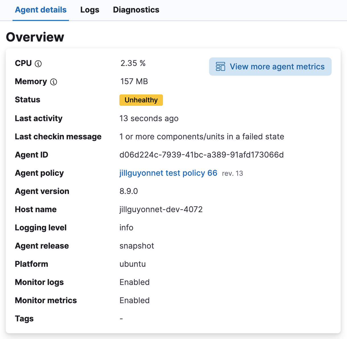

In Fleet, you can access the detailed status of an individual agent and the integrations that are associated with it through the agent policy.
- In Fleet, open the Agents tab.
- In the Host column, click the agent’s name.
On the Agent details tab, the Overview pane shows details about the agent and its performance, including its memory and CPU usage, last activity time, and last checkin message. To access metrics visualizations, you can also View the Elastic Agent metrics dashboard.
The Integrations pane shows the status of the integrations that have been added to the agent policy. Expand any integration to view its health status. Any errors or warnings are displayed as alerts.
To gather more detail about a particular error or warning, from the Actions menu select View agent JSON. The JSON contains all of the raw agent data tracked by Fleet.

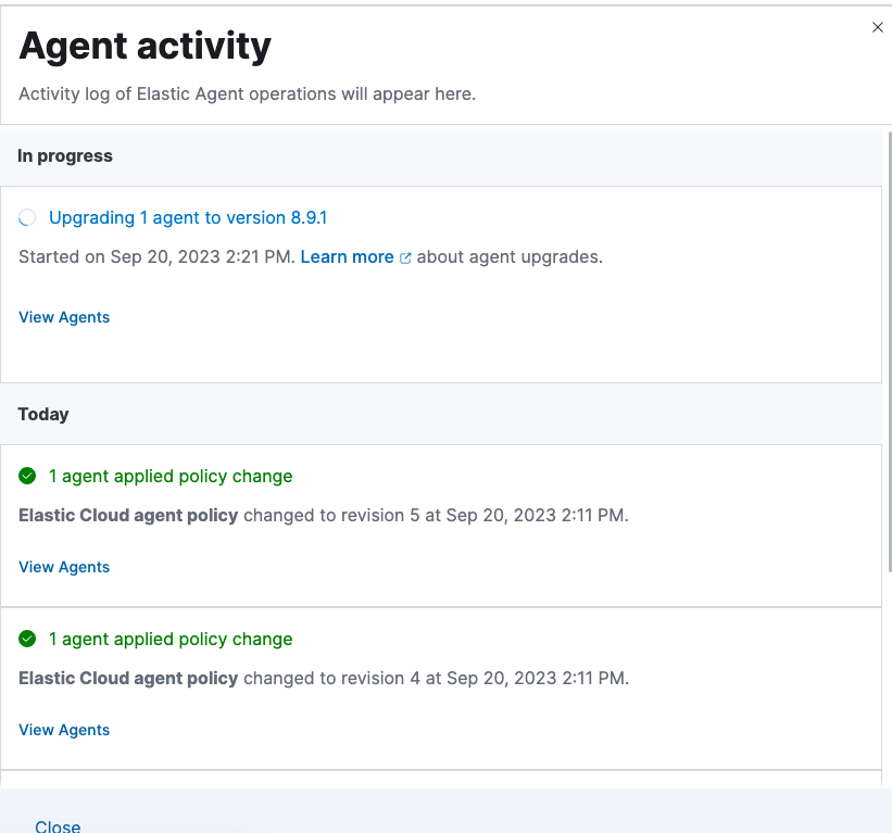

You can view a chronological list of all operations performed by your Elastic Agents.
On the Agents tab, click Agent activity. All agent operations are shown, beginning from the most recent, including any in progress operations.

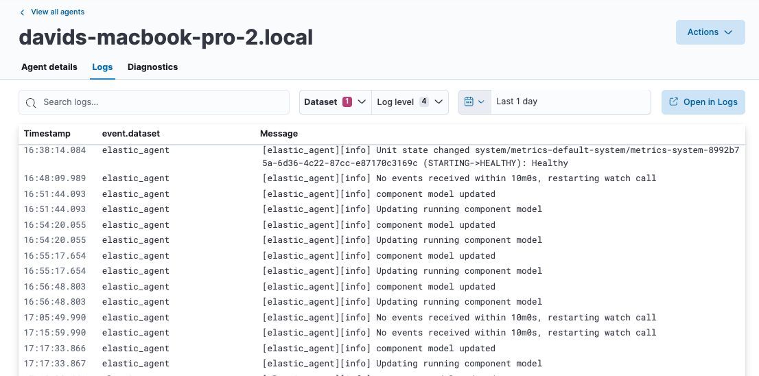

When Fleet reports an agent status like Offline or Unhealthy, you might want to view the agent logs to diagnose potential causes. If agent monitoring is configured to collect logs (the default), you can view agent logs in Fleet.
On the Agent details tab, verify that Monitor logs is enabled. If it’s not, refer to Change Elastic Agent monitoring settings.
Click the Logs tab.
On the Logs tab you can filter, search, and explore the agent logs:
Use the search bar to create structured queries using Kibana Query Language.
Choose one or more datasets to show logs for specific programs, such as Filebeat or Fleet Server.
Change the log level to filter the view by log levels. Want to see debugging logs? Refer to Change the logging level.
Change the time range to view historical logs.
