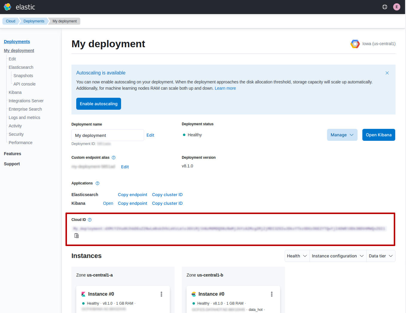

If you are using Elastic Cloud, the client offers an easy way to connect to it. You need the Cloud ID that you can find in the cloud console, then your username and password.
Cloud ID
Once you have collected the Cloud ID you can use the client to connect to your Elastic Cloud instance, as follows:

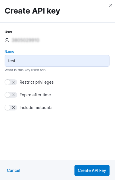

You can also connect to the Cloud by using API Key authentication. You can generate an API key in the Management page under the section Security.
API key
When you click on Create API key you can choose a name and set the other options (eg. restrict privileges, expire after time, etc).
Choose an API name

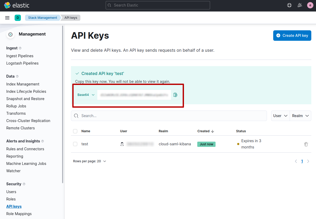

After this step you will get the API key in the API keys page.
API key
IMPORTANT: you need to copy and store the API key in a secure place, since you will not be able to view it again in Elastic Cloud.
