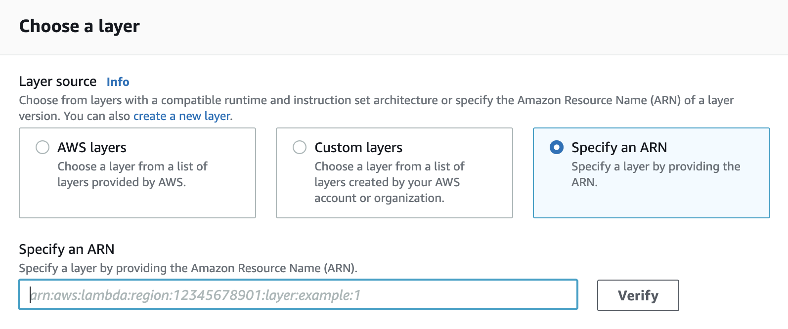

To add the layers to your Lambda function through the AWS Management Console:
- Navigate to your function in the AWS Management Console
Scroll to the Layers section and click the Add a layer button
- Choose the Specify an ARN radio button
Copy and paste the following ARNs of the APM Lambda Extension layer and the APM agent layer in the Specify an ARN text input:
APM Extension layer:
EXTENSION_ARN
APM Agent layer:
AGENT_ARN - Click the Add button
