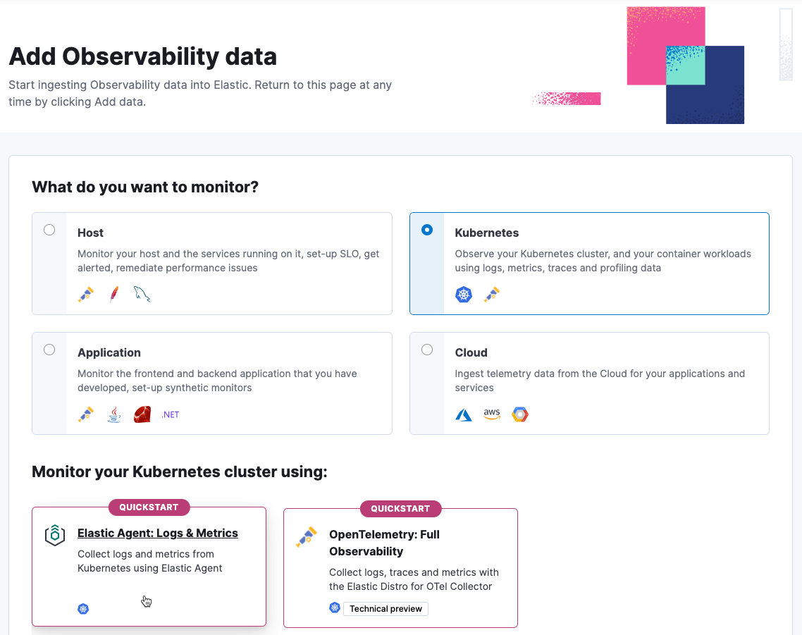

Go to your Elastic Observability Serverless project, then go to Add data.
In the What do you want to monitor? section, select Kubernetes, and then select Elastic Agent: Logs & Metrics.
To install Elastic Agent on your host, copy and run the install command.

In Kibana, go to the Observability overview page, and click Add Data.

In Kibana, go to the Observability UI and click Add Data.
