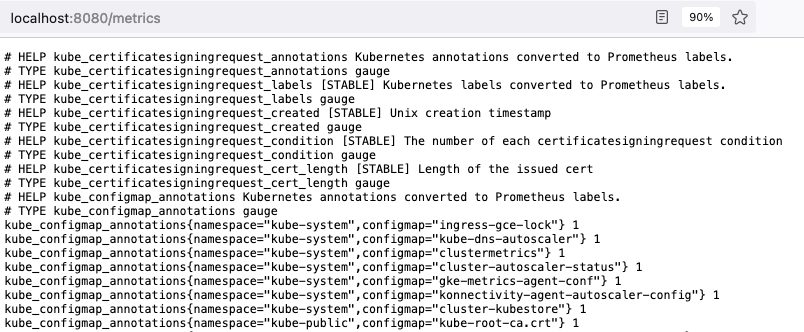

Now, open up a web browser to address
localhost:8080/metrics
. If things are working properly, you will see a flow of metrics data from your cluster.

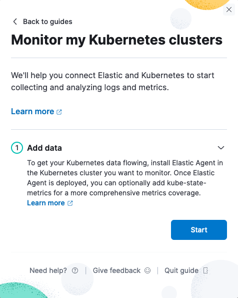

Choose the Monitor Kubernetes clusters card. The guide opens on the first step.

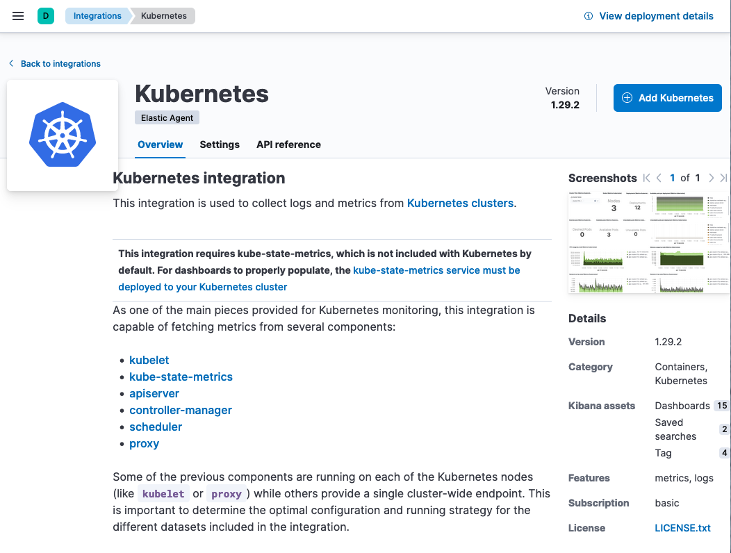

In the guide, on the Add data tab, select Start. The Elastic Kubernetes integration page opens.
Select Add Kubernetes, and you’re ready to add your first integration.

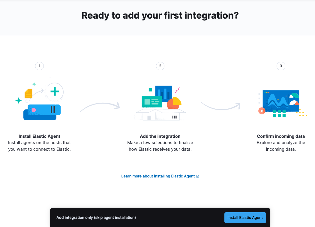

- On the Ready to add your first integration? page, select Install Elastic Agent.
Follow the steps in the guide to configure and enroll Elastic Agent in Fleet:

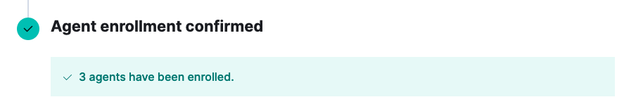

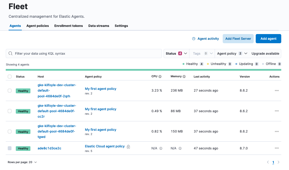

In the integration setup guide, wait for confirmation that Elastic Agent is enrolled in Fleet. This can take a few minutes.
You can also view the status of your Elastic Agents at any time by navigating in Kibana to the Fleet page. Our test Kubernetes cluster has three nodes, so three Elastic Agents are configured.

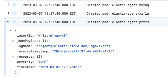

Your Kubernetes cluster logs should also show that the Elastic Agent pods were created successfully. Filter by
elastic-agent
to see just the applicable logs:

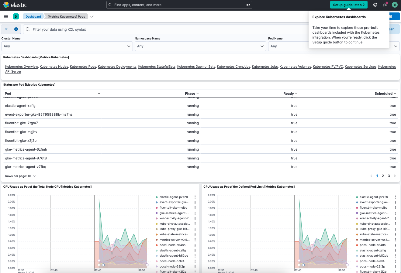

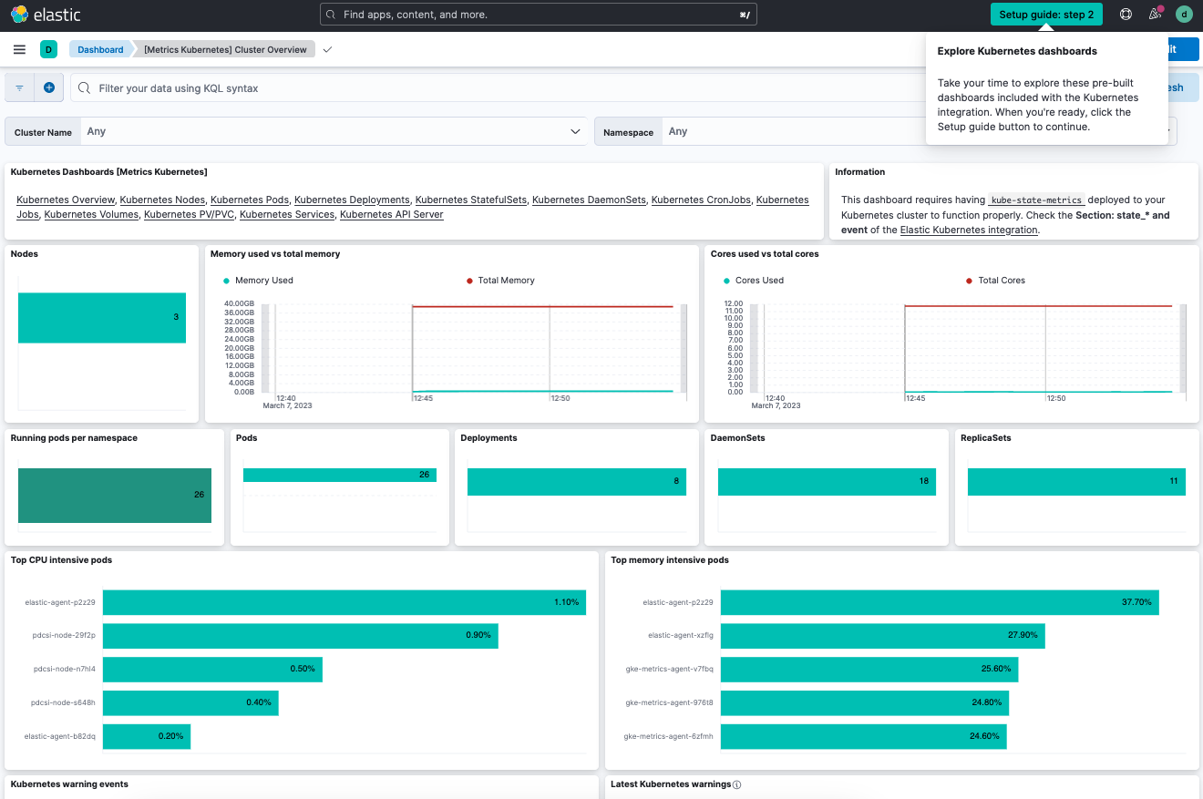

In the guide, on the Explore Kubernetes metrics and logs tab, select Start. The Kibana [Metrics Kubernetes] Cluster Overview dashboard opens.
You can use the dashboard filters to drill down to a specific cluster or namespace. You can also filter the time period for the metrics to any range, either absolute or relative to the current time.
On the Kubernetes Dashboards [Metrics Kubernetes] card, try out some of the other dashboards that are available.
For example, on the Kubernetes Pods dashboard, the default visualizations capture the pods status, CPU usage, memory usage, and network traffic:

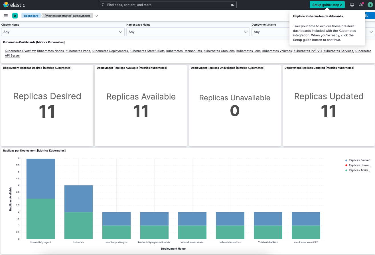

On the Kubernetes Deployments dashboard, you can view all deployments and replicas: desired, available, unavailable, and updated.

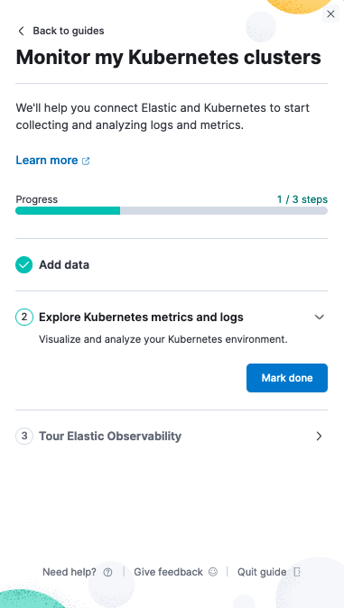

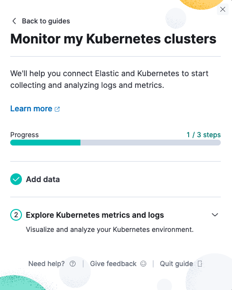

On the Elastic banner, select Setup guide: step 2. The guide opens on the second step.
- Since you’ve now tried out a few Kibana dashboards, select Mark done.
- Under the Tour Elastic Observability tab, select Start to learn more about Elastic Observability. The remaining steps in the setup guide will introduce you to additional features for monitoring your Kubernetes cluster logs and metrics data, to help you better assess your cluster’s performance over time.
