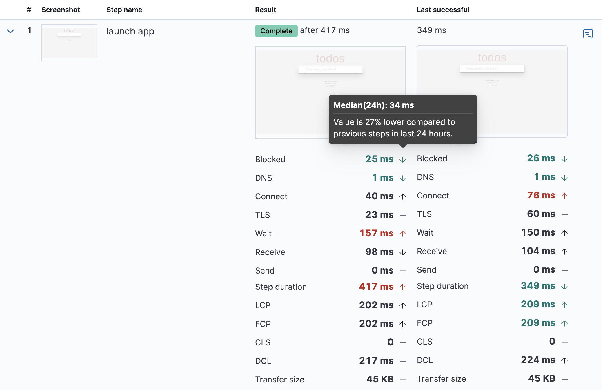

Details for one run
editThe page detailing one run for a journey includes more information on each step in the current run and opportunities to compare each step to the same step in previous runs.
At the top of the page, see the Code executed and any Console output for each step. If the step failed, this will also include a Stacktrace tab that you can use to diagnose the cause of errors.
Navigate through each step using Previous and
Next
Scroll down to dig into the steps in this journey run.
Click the icon next to the step number to show details.
The details include metrics for the step in the current run and the step in the last successful run.
Read more about step-level metrics below in Timing and
Metrics.
This is particularly useful to compare the metrics for a failed step to the last time it completed successfully when trying to diagnose the reason it failed.

Timing
editThe Timing visualization shows a breakdown of the time spent in each part of the resource loading process for the step including:
- Blocked: The request was initiated but is blocked or queued.
- DNS: The DNS lookup to convert the hostname to an IP Address.
- Connect: The time it took the request to connect to the server. Lengthy connections could indicate network issues, connection errors, or an overloaded server.
- TLS: If your page is loading resources securely over TLS, this is the time it took to set up that connection.
- Wait: The time it took for the response generated by the server to be received by the browser. A lengthy Waiting (TTFB) time could indicate server-side issues.
- Receive: The time it took to receive the response from the server, which can be impacted by the size of the response.
- Send: The time spent sending the request data to the server.
Next to each network timing metric, there’s an icon that indicates whether the value is
higher (),
lower (
or the same (
compared to the median of all runs in the last 24 hours.
Hover over the icon to see more details in a tooltip.
