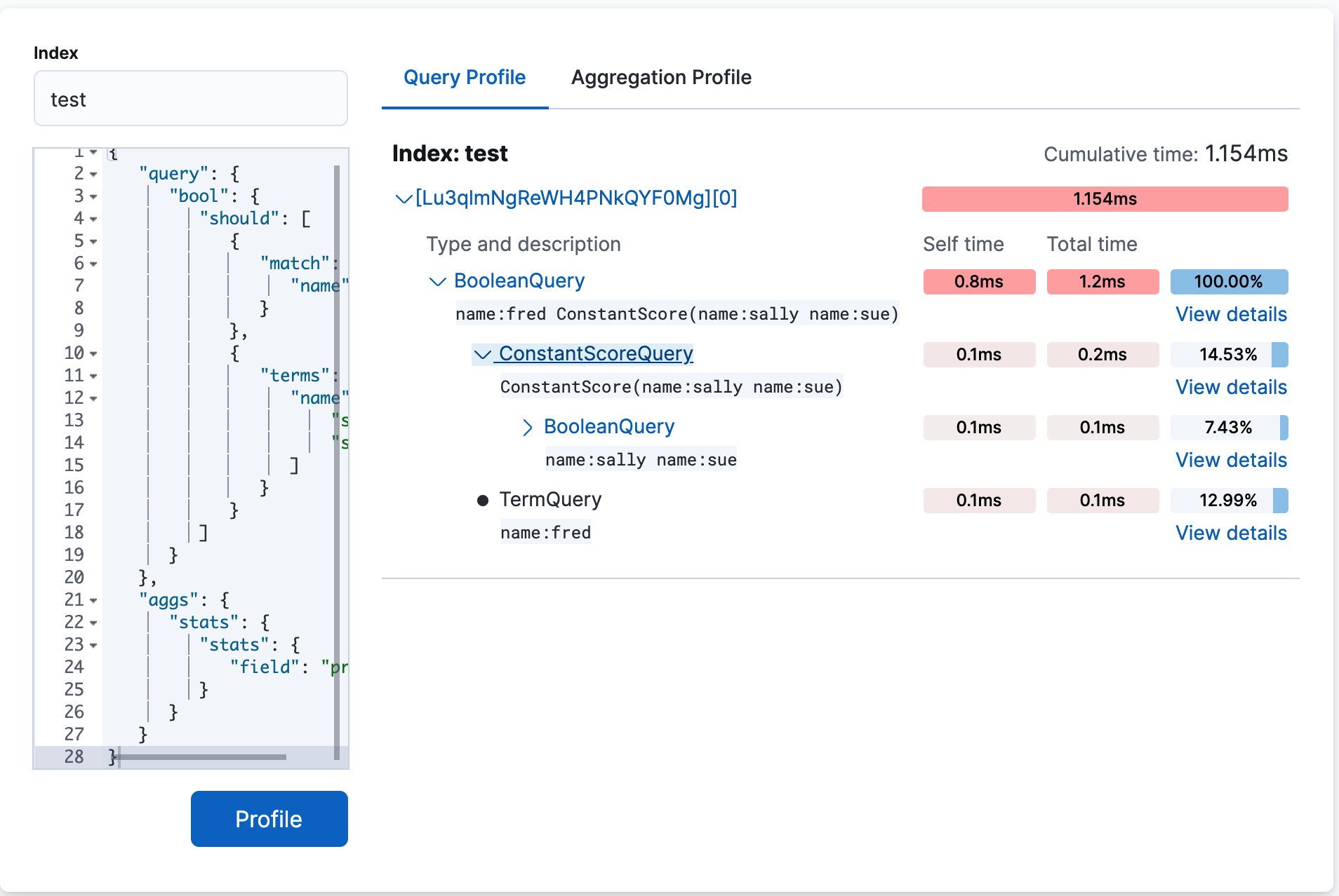

  4. Click Profile to profile the query and visualize the results.
    Profiling the more complicated query
    • The top BooleanQuery component corresponds to the bool in the query.
    • The second BooleanQuery corresponds to the terms query, which is internally converted to a Boolean of should clauses. It has two child queries that correspond to "sally" and "sue from the terms query.
    • The TermQuery that’s labeled with "name:fred" corresponds to match: fred in the query.
      If you look at the time columns, you can see that Self time and Total time are no longer identical on all the rows. Self time represents how long the query component took to execute. Total time is the time a query component and all its children took to execute. Therefore, queries like the Boolean queries often have a larger total time than self time.

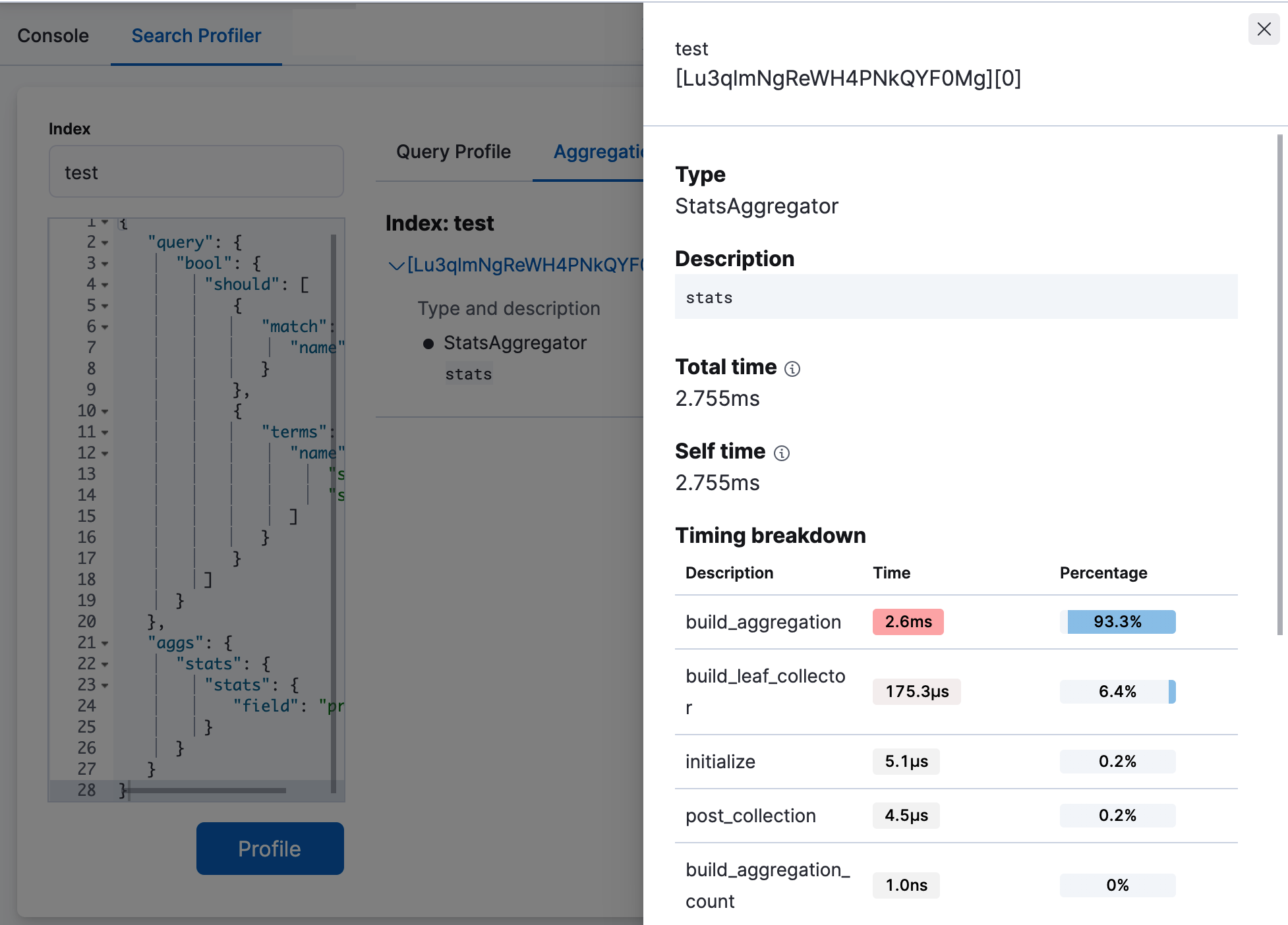

  5. Click Aggregation Profile to view aggregation profiling statistics.
    This query includes a stats agg on the "age" field. The Aggregation Profile tab is only enabled when the query being profiled contains an aggregation.
  6. Click View details to view the timing breakdown.
    Drilling into the first shard's details
